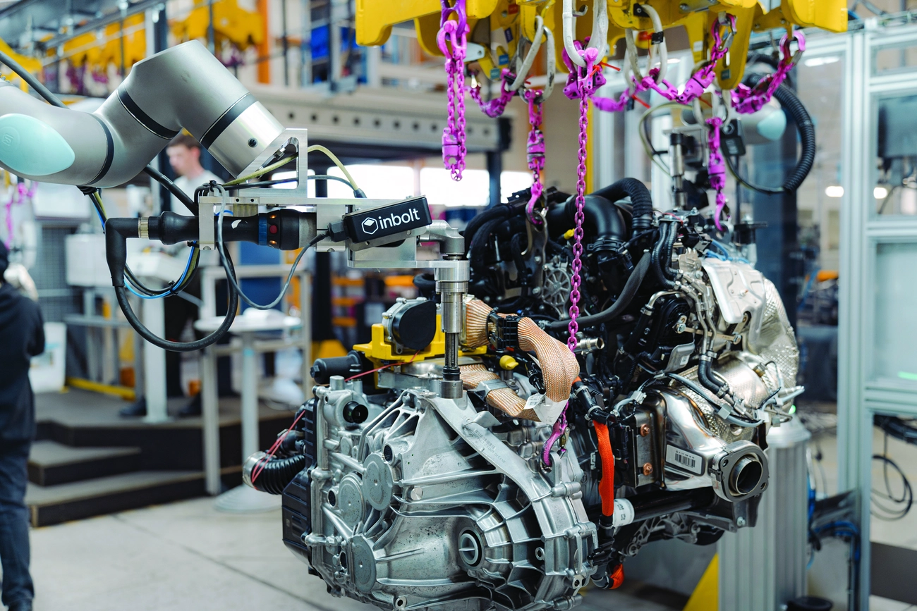

Deploying a robot on a factory floor often takes weeks as engineers build digital twins of the production line, then spend the commissioning window touching up trajectories point by point. Using Inbolt’s AI-assisted vision-enabled robot programming, the Universal Robots arm can locate the part on a moving surface and adjust its motion to execute the planned path. (Credit: Inbolt.)
