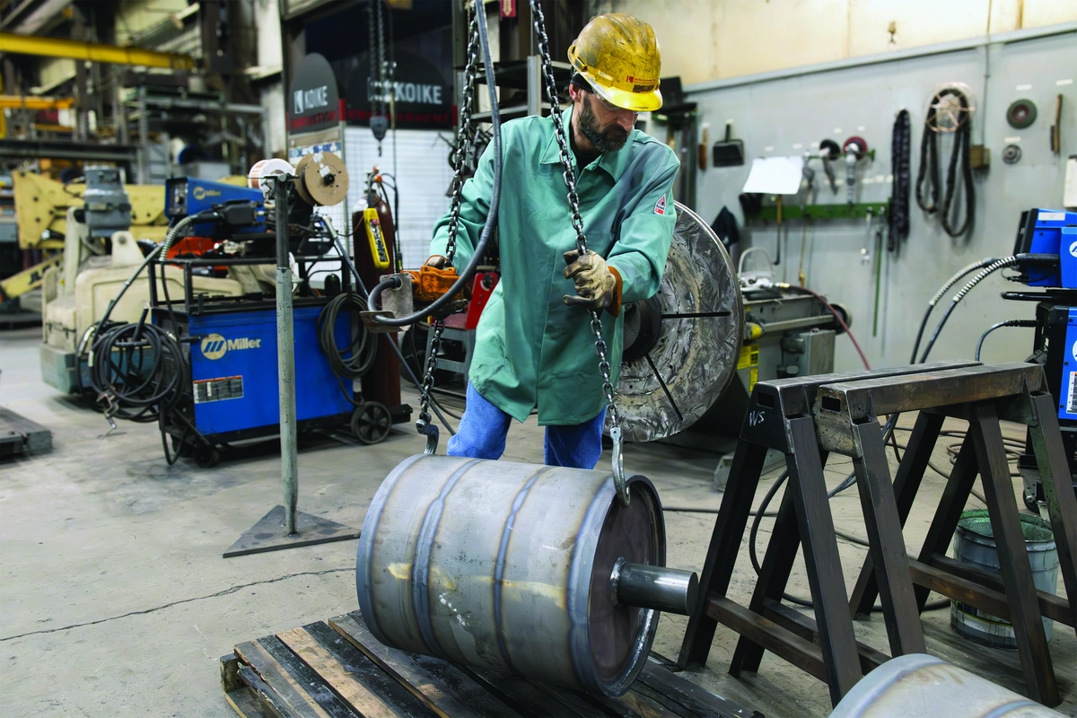

WJ April 2026 - Safety First Best Practices for Handling Heavy Weldments - Fig. 1.webp
A welder preparing to safely lift a 350-lb steel wheel assembly.
Understanding the Weight and the Risk
To calculate the weight of a steel plate, start by finding its volume and then multiplying it by the density of steel. Steel weighs approximately 0.2836 lb/in.3 (steel density).

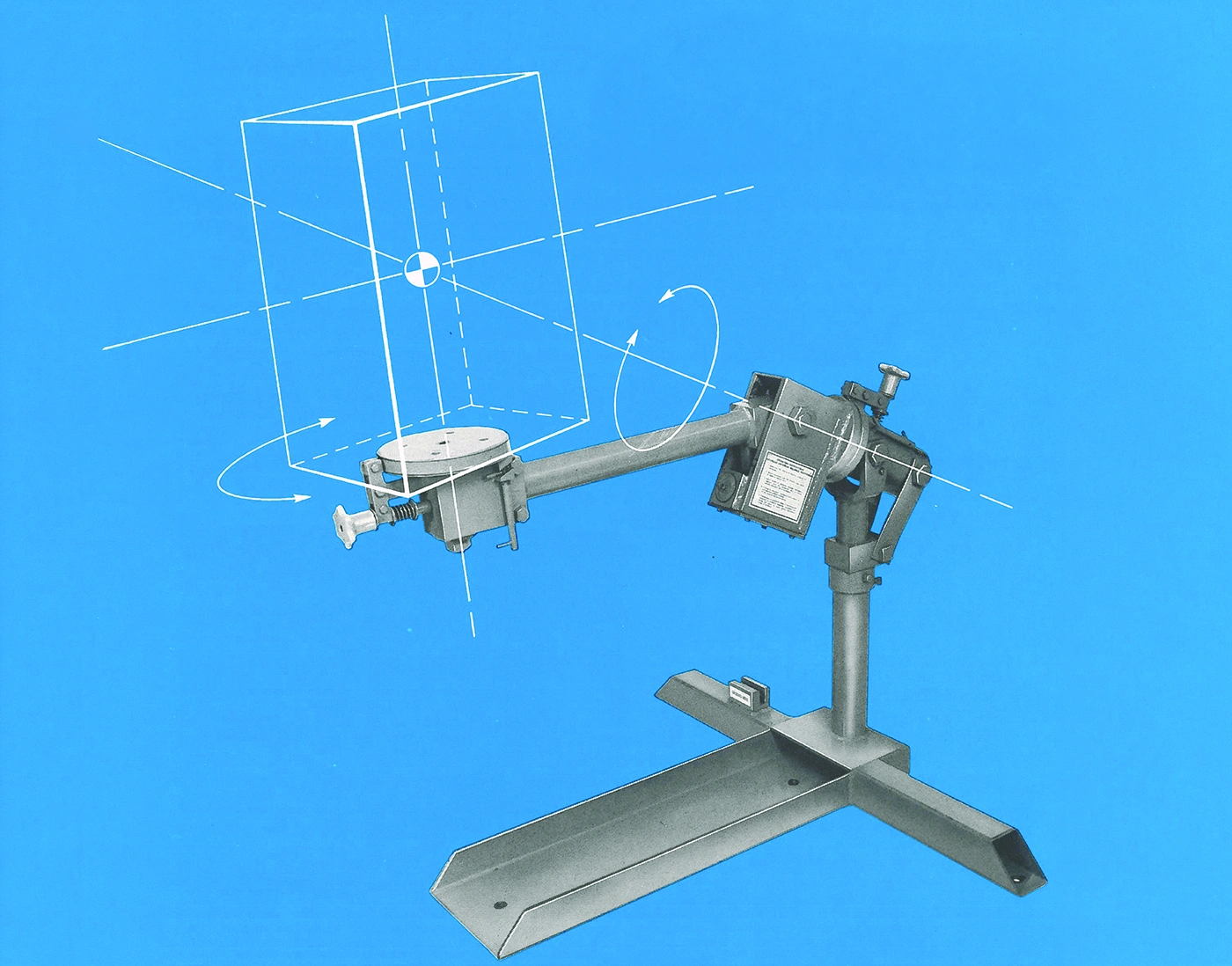

The Center of Gravity
The CG is the single, imaginary point where an object’s entire weight is concentrated, acting as its balance point. If the CG isn’t identified, or at least estimated before lifting, the weldment can rotate, tip, or swing as soon as it leaves the ground.

A smart way to introduce safe material-handling concepts is by letting new welders experience CG behavior before they’re anywhere near heavy weldments. A benchtop welding positioner is ideal for this type of training.
By practicing with small assemblies, students quickly learn how:
  • Off-center loads cause sudden rotation
  • A part “seeks” its heaviest point
  • Clamping and fixturing affect stability
  • Subtle changes in orientation shift balance
  • Controlled rotation feels when the load is centered properly
These harmless demonstrations build intuition. When a small part snaps toward its heaviest side on a benchtop positioner, the student sees the same forces that act on a 500-lb or 5000-lb workpiece, without the hazards. It reinforces the fundamental rule of rigging and positioning: gravity always wins.
