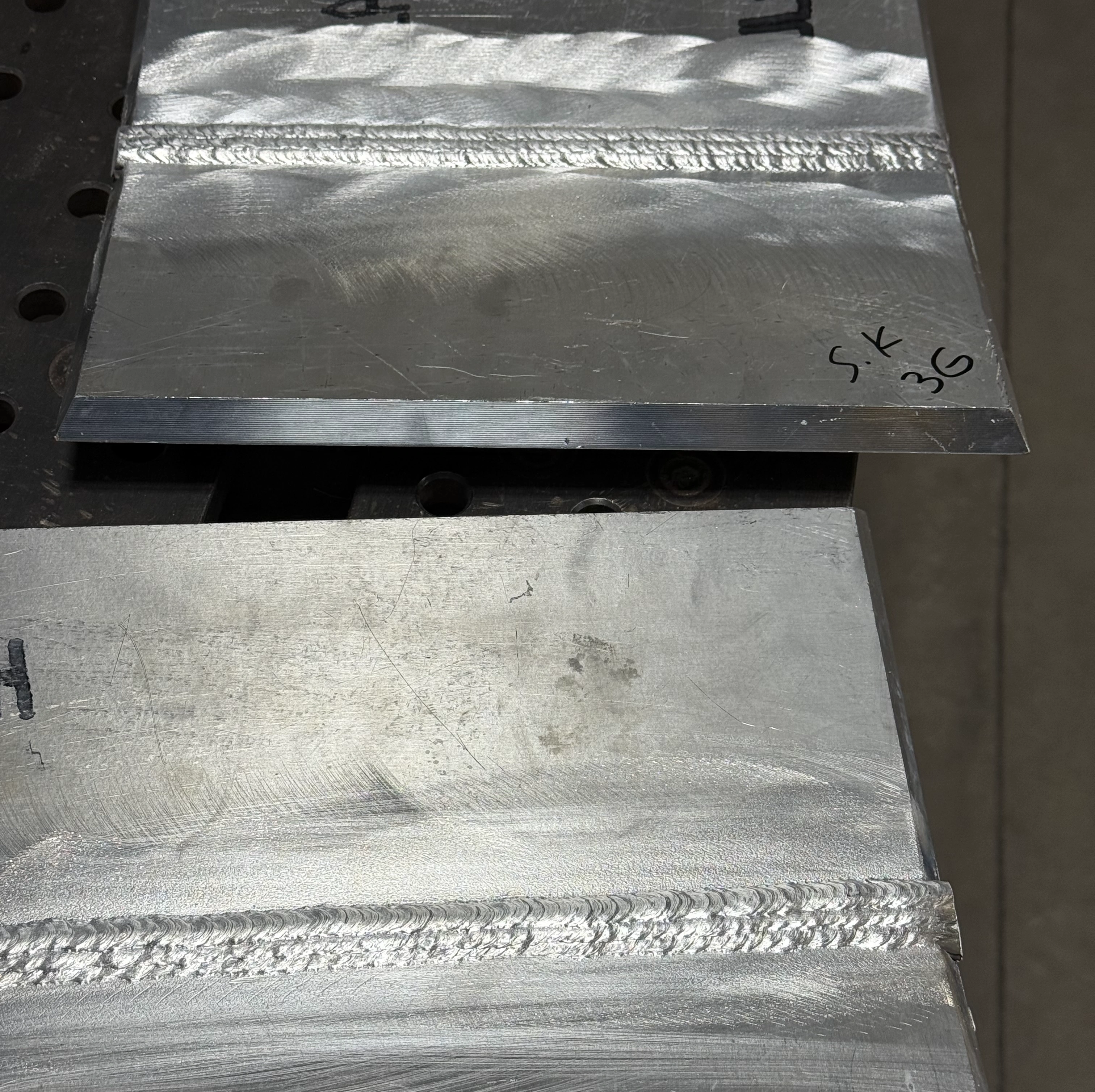

Aluminum is unforgiving. It doesn’t give second chances. When I first began welding aluminum passenger trains in Poland on Alstom, I quickly learned this material isn’t just lightweight, it’s temperamental. It warps easily and demands exact cleaning, heat control, consistent technique, and absolute concentration. Many test plates I’ve made are welded to meet the requirements of AWS D1.2, Structural Welding Code — Aluminum.
Test plates welded to adhere to AWS D1.2 requirements.

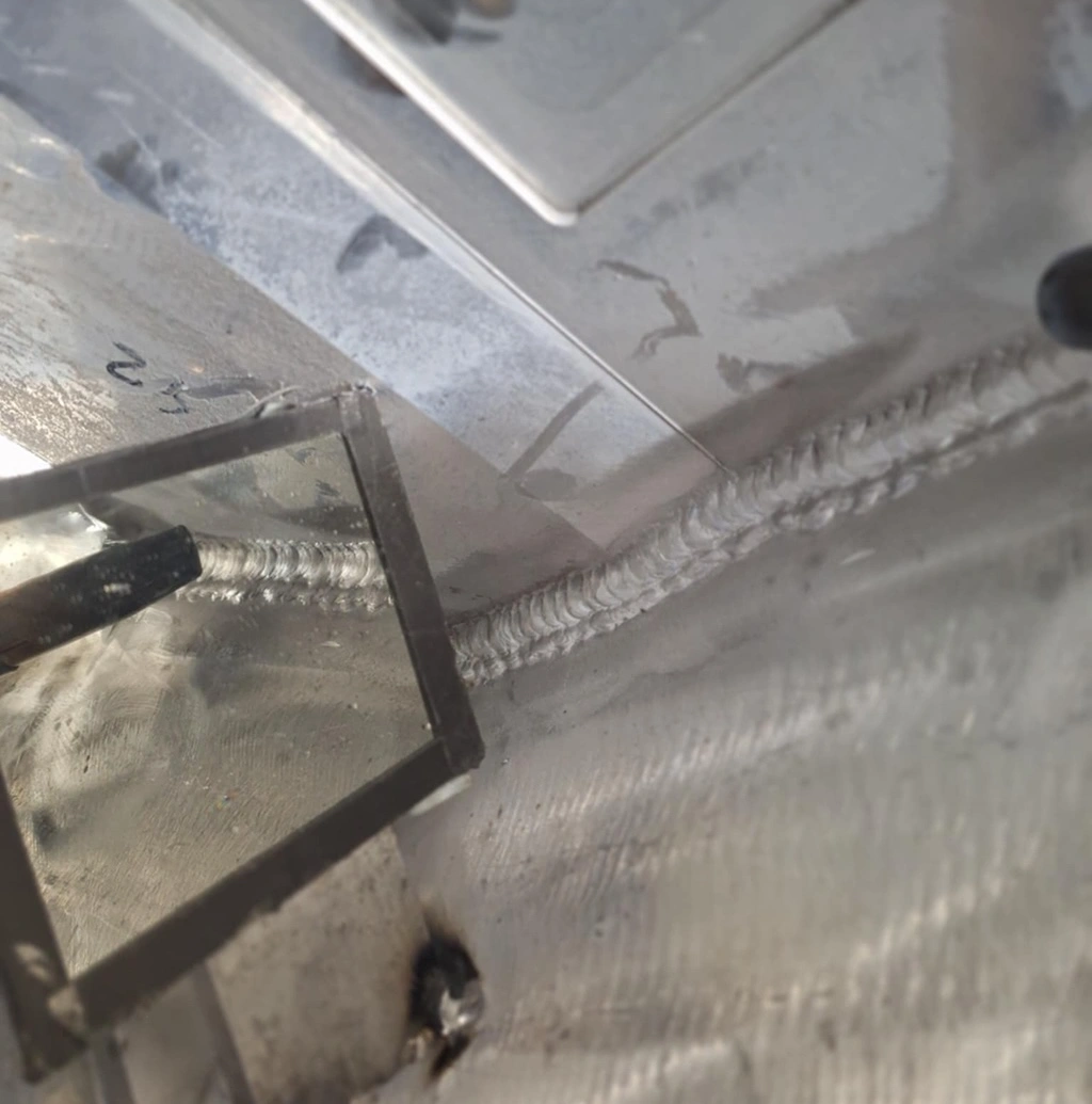

Mirror Work: Precision in Reverse
One of the most unique techniques I’ve mastered is mirror welding, where a mirror is used to see yourself perform welds in visually inaccessible spots or in hard-to-reach areas. I used this method while working on aluminum luxury yachts in the Netherlands. Welding in reverse demands total muscle memory. You’re not just laying a bead — you’re doing it backward, mirrored, with minimal room for error.
Mirror welds made inside an aluminum yacht structure.

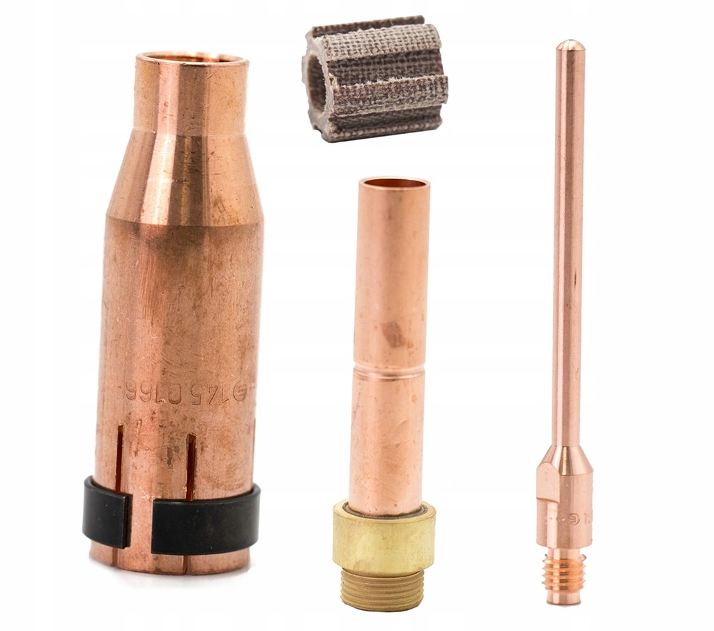

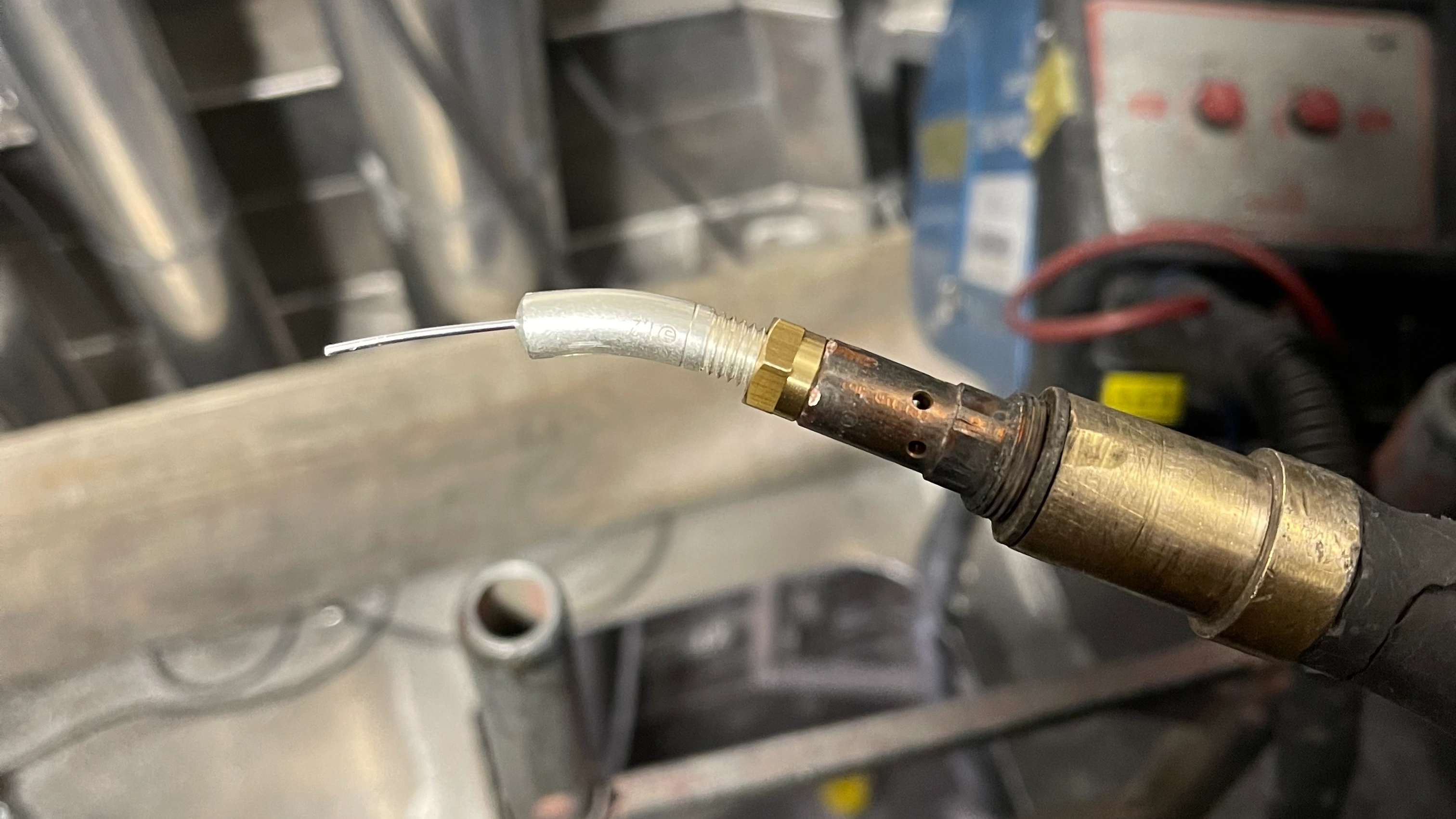

Welding inside confined compartments requires not just skill but also creativity. One of the practical solutions I found online was a specially modified gas gun tip and nozzle, designed for narrow angles. Though not my invention, I tried this setup on a few challenging welds, and it worked. Small tools like this make a big difference when you’re crawling through the hull of a yacht. While working in confined compartments, I used GMAW gun tips and nozzles designed to reach tricky angles and maintain bead quality. I didn’t invent these, but after seeing them online, I adopted the idea, and it made a real difference.
One example of a modified GMAW gun setup for tight spaces.
Another example of a modified GMAW gun setup for tight spaces.
