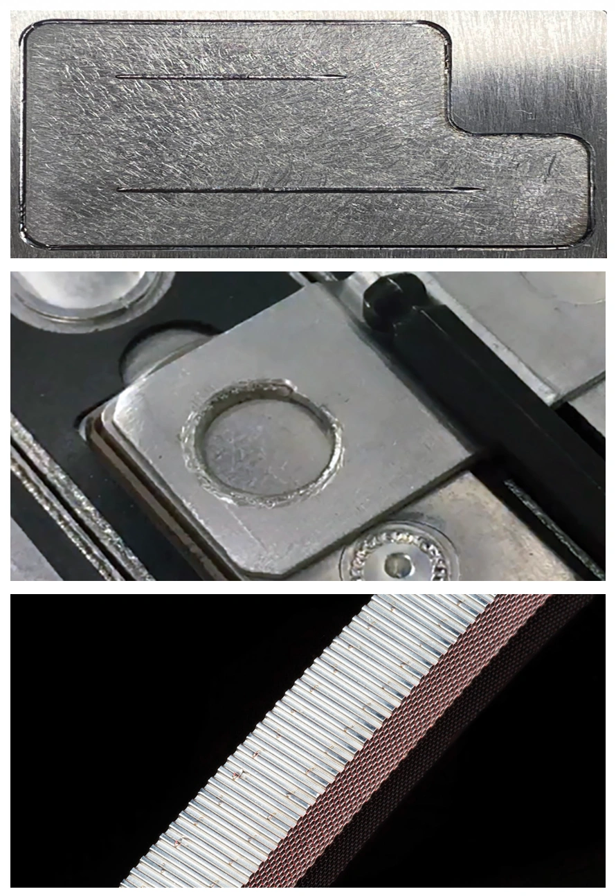

Typical aluminum welding applications (from top): electronic package, an aluminum tab on a prismatic battery can, and aerospace honeycomb. (Images courtesy AMADA Weld Tech.)

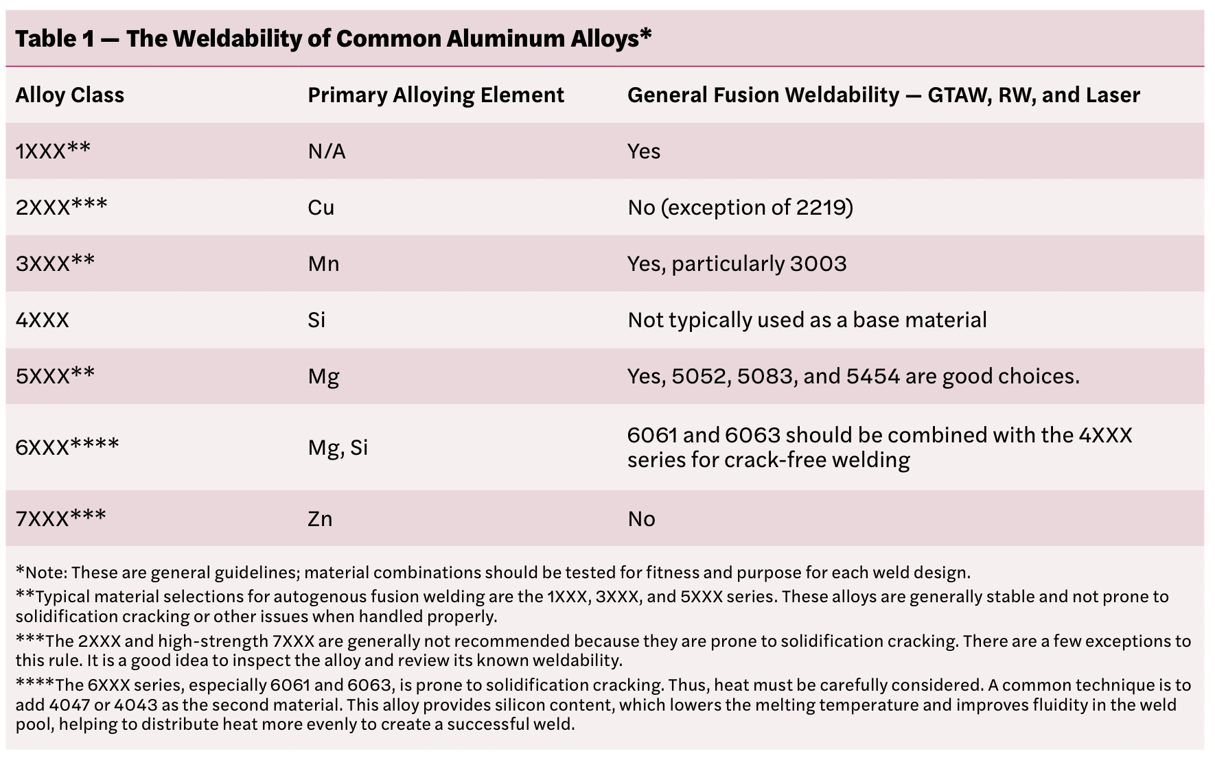

Choose the Right Alloys
Material selection is key to avoiding volatile alloying elements, which can cause excess porosity and cracking. Because of the small part size and limited access, filler material is rarely used in microwelding and can be difficult to apply. Microwelding is typically done autogenously, meaning the alloy content must
be weldable.
Table 1 outlines the weldability of common aluminum alloys.

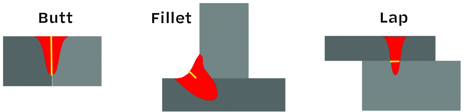

Proper Weld Joint Design
Weld joint design is a key factor in aluminum welding, and optimized joint configurations are critical for enhancing joint penetration, strength, and repeatability while minimizing weld defects.
  • Butt joints provide direct access to the joint interface and promote uniform heat distribution.
  • Lap joints are frequently employed for applications like welding thin foils and tabs, where alignment can be achieved with minimal fixturing. It’s important to ensure adequate overlap and weld along the edge where the two parts meet. Avoid trapping contaminants between the layers.
  • T-joint and fillet joint configurations are sometimes used, provided sufficient access for the heat source is available. It’s important to maintain part fit-up.
Regardless of joint type, excessive gaps, uneven edges, or inconsistent overlap can lead to incomplete fusion, excessive melt-through, or localized overheating.
