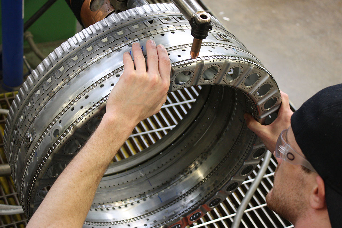

Clause 6 centralizes requirements for welding machines (Fig. 1), shear testing equipment, and associated jigs and fixtures.  The clause establishes unified expectations for equipment design, maintenance, and inspection (including options for condition-based monitoring), and includes requirements for calibration of shear testing equipment, with distinct intervals defined for stationary and portable machines.
Resistance seam weld machine. (Image courtesy of Lynn Welding.)
Clause 7 outlines the requirements for qualifying machines, detailing the criteria and procedures necessary to ensure their suitability and compliance for production use. The intent of machine qualification testing is to demonstrate that a particular welding machine (Fig. 2) can consistently produce welds meeting the requirements for the desired class of welds over a range of assembly thicknesses. The qualification test serves to verify the equipment’s capability at the upper (thickest) and lower (thinnest) ends of the thickness range. New requirements have also been added that permit a reduced scope of testing when machine requalification may be required.

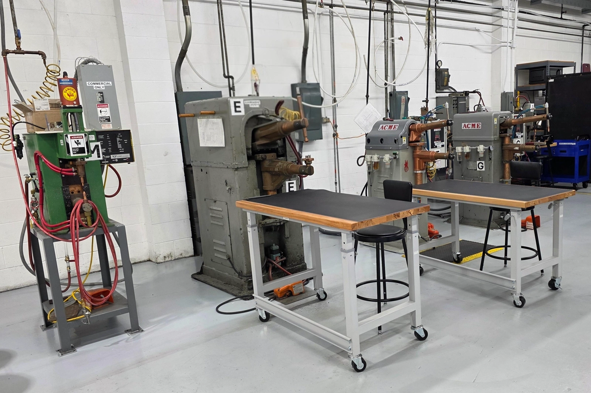

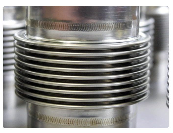

Clause 9 reorganized the requirements and controls for resistance welding of production hardware (Figs. 3 and 4). This section includes requirements for cleaning, surface conditions, coatings, and fit-up. It also provides specific requirements to assure weld conformance during production welding, including controls for production witness testing and allowed adjustments to parameters and conditions. Essential variable tables were added to consolidate and simplify the presentation of certification variables and their allowable production adjustments.
Resistance seam weld, flexible bellows. (Image courtesy of Lynn Welding.)
Aerospace production spot welding. (Image courtesy of Lynn Welding.)

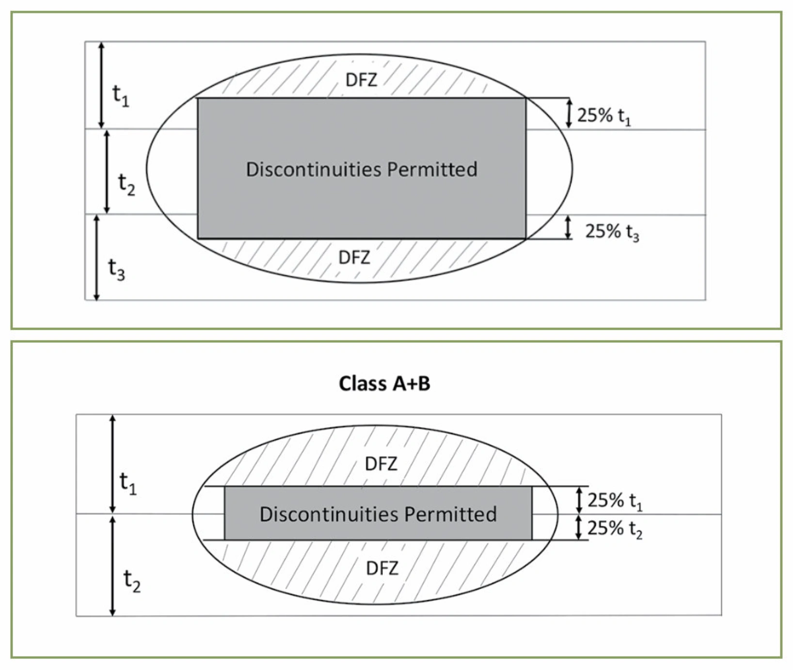

Clause 10 unifies the acceptance criteria for all stages of the resistance welding process by applying consistent standards to machine qualification, welding schedule certification, production witness coupons, and production hardware. New terminology (e.g., discontinuity free zone) and figures have also been introduced to improve the interpretation of defects in metallographic evaluation of welds (Fig. 5). Clause 10 creates a single, end-to-end framework that keeps weld integrity aligned from initial setup through the manufacture of production hardware.
Clear penetration discontinuity free zone (DFZ). (Image courtesy of Peter Daum.)
