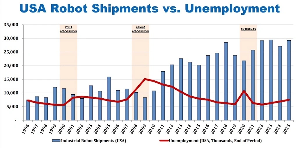

Burnstein presented two charts that anchored the conference’s central argument. Plotting three decades of U.S. industrial robot shipments against civilian employment and unemployment, the data showed a surprising pattern (Fig. 1): When robot shipments go up, unemployment goes down. When robot shipments decline, unemployment rises.
Fig. 1 — A3 data busts the jobs myth and links robot shipment to job creation.
