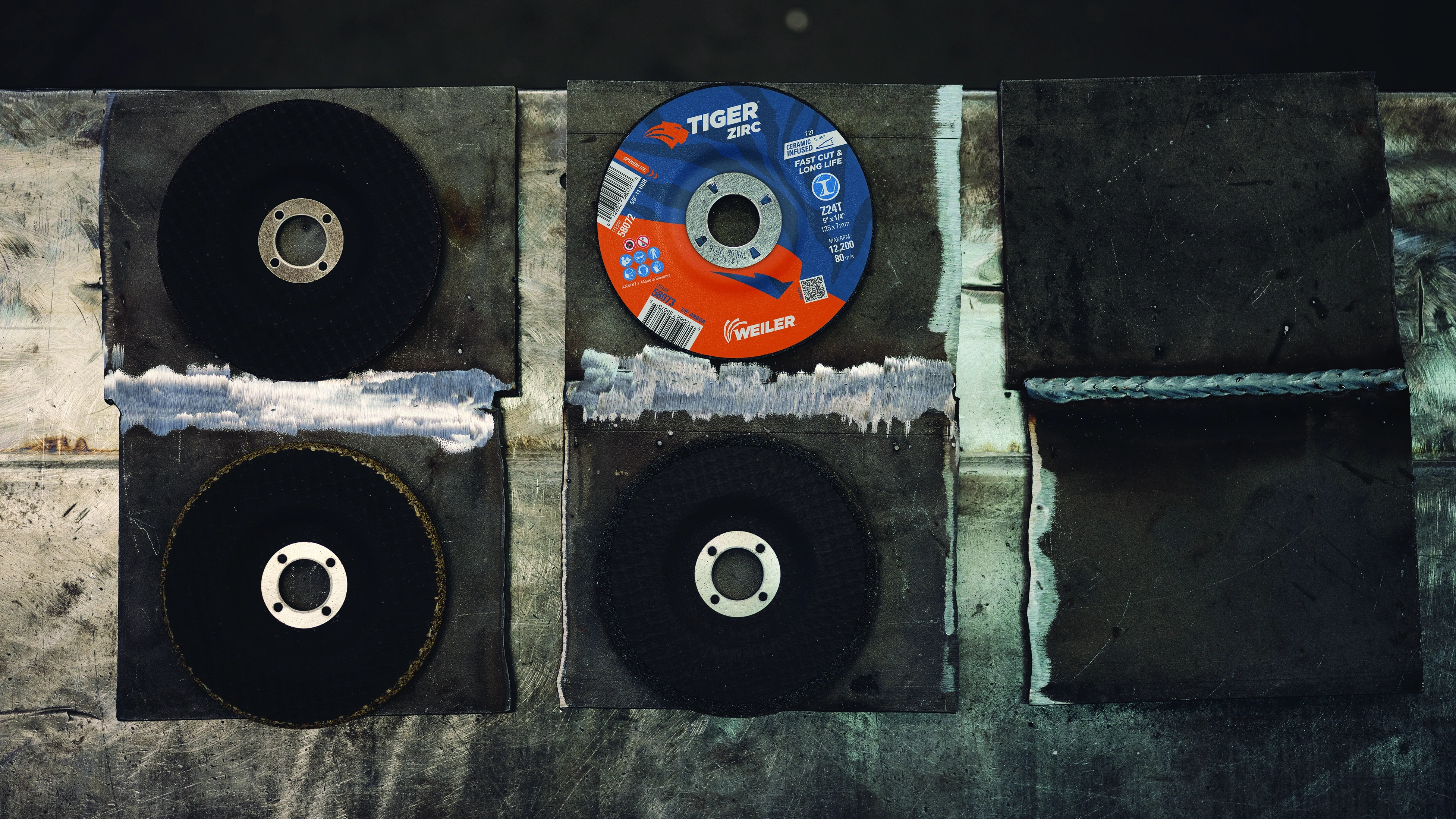

Because labor accounts for the vast majority of fabrication costs, even modest abrasive improvements can lead to time and money saved. Using a data-driven assessment process can support smarter abrasive purchasing decisions. This type of analysis should start with an onsite assessment to learn about the production process and gather data. Operations should also think about what it is they want to accomplish. Is it a faster cut? A longer-lasting abrasive? Improving operator comfort? All of those factors play a role in selecting the right solution.
Once the data is gathered, a baseline of the current process is established — looking at factors such as actual grind time vs. total shift time, material removed, parts completed, and wheel changeover time. Next is testing to compare things such as time, weight, and number of parts completed and number of abrasives used. The resulting analysis can be documented and demonstrate how much labor savings certain solutions can provide in hours and dollars, giving operations a clear picture of true costs. This analysis helps operations make the best decision based on their specific needs and wants. There are many abrasive options on the market, but choosing the right one can improve throughput, safety and operator comfort.
In one real-world example, a large shipbuilder that builds for the U.S. Navy wanted cost-effective abrasives for a new line. Working with its abrasives manufacturer, it developed a method to quantify abrasives testing and set up a standard operating procedure. The shipbuilder had previously never looked at the impact of abrasives on its production floor. It now has the power to easily and quickly compare products and make the best decision for its needs, allowing the yard to move from opinion-based purchasing to data-driven choices across multiple brands, quantifying true grinding costs.

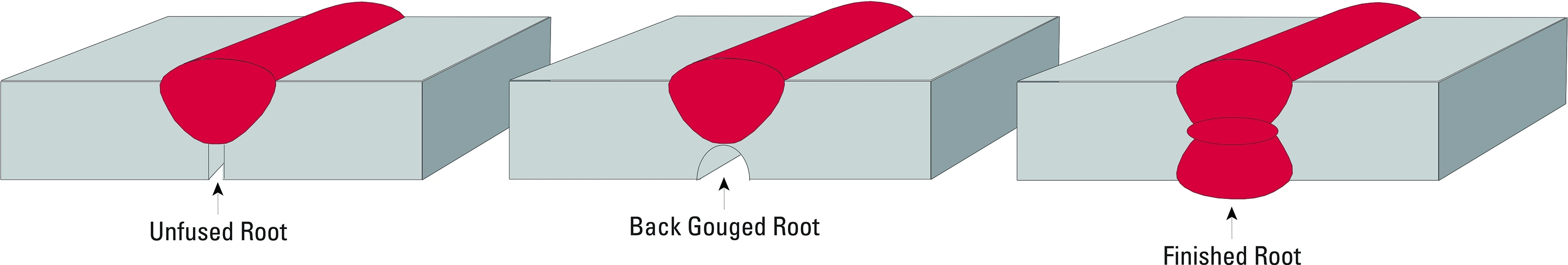

- Clearing specifications. For shipyards working on Navy contracts, welding processes are often governed by standards such as MIL-STD-1689A, Department of Defense Manufacturing Process Standard: Fabrication, Welding, and Inspection of Ships Structure. While these specifications are highly detailed, one consistent expectation in shipyard practice is the need to ensure complete joint penetration and structural integrity, often requiring backgouging on multipass or V-shaped welds. Because backgouging is a routine but labor-intensive step, the choice of abrasive can have a meaningful impact. Ceramic cut and grind combination wheels are designed for effective grinding at a 90 deg angle, helping operators remove material efficiently while maintaining control and reducing fatigue. In high-volume environments, even small improvements in this process can translate into measurable time savings and more consistent weld quality.
