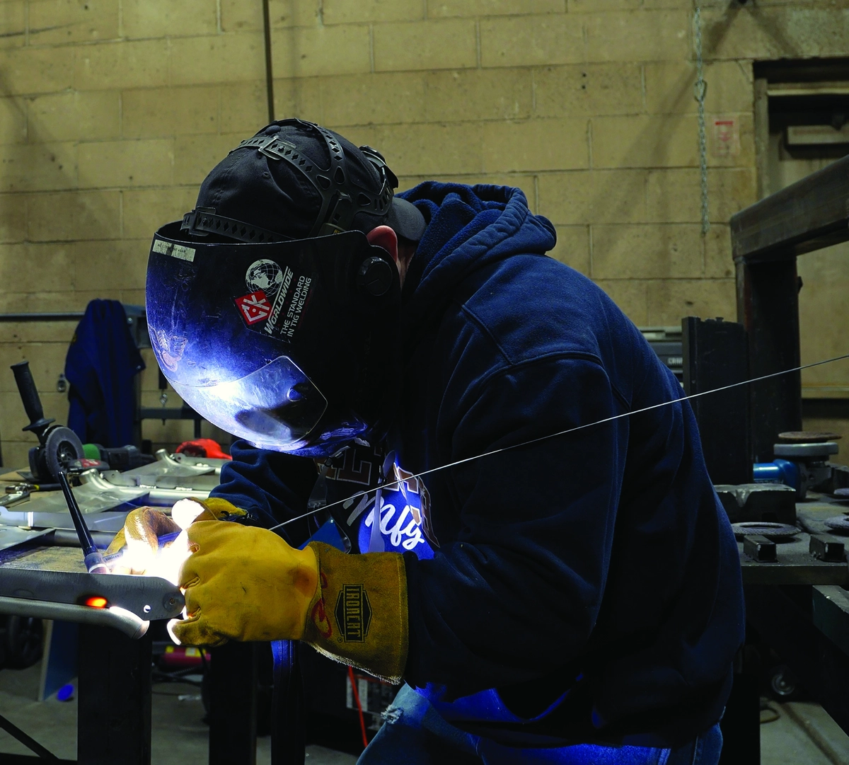

Having efficient processes in place enables skilled welders to maximize their time welding.

Maximizing Arc-On Time: Are Your Welders Welding?
When evaluating shop efficiency, one of the most important questions to ask is what can be done so that your welders are welding.
A useful comparison is a surgical environment. A specialized, highly skilled surgeon is not the one responsible for preparing the operating room. Support staff handle setup so the surgeon can focus solely on completing the procedure for which they are uniquely qualified for.
This same principle applies in a fab shop. In less efficient operations, welders spend a significant portion of their time on nonwelding tasks such as layout, fitting, or grinding. While necessary, these tasks reduce the time available for the specialized work only they can perform.
Separating responsibilities allows each role to focus on its highest-value contribution. Support personnel handle preparation, fixturing, and finishing work, enabling the highest-skill welders to remain focused on welding.

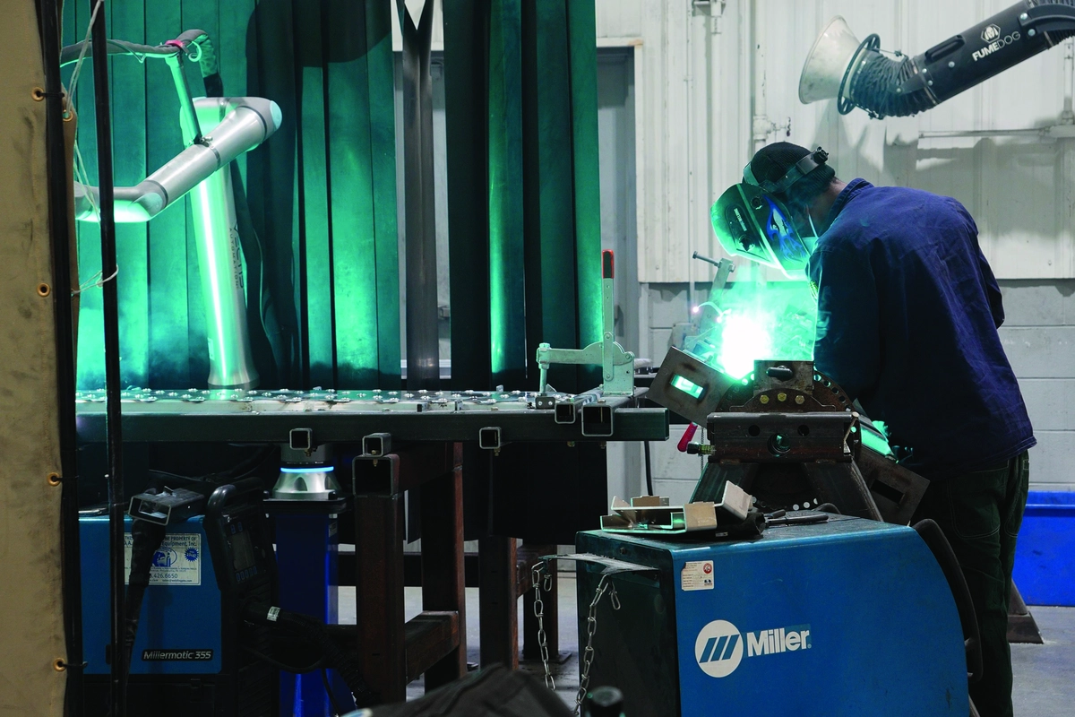

WJ July 2026 - Improving Weld Shop Efficiency before Adopting Automation - Fig. 2.webp
Workstations are set up to enable a quick transition between part preparation and welding.

Transitioning to Automation
Before adopting automation, certain non-negotiable elements must be in place to ensure success. It is crucial to have efficient upstream processes and parts to allow automated welding systems to perform the repeatable welds they thrive on, and it’s equally important to find a motivated worker to take ownership of the system’s success.
After establishing consistent processes in fixturing, workflow, and labor utilization, Caltech took the next steps in improving productivity by implementing collaborative robotic (cobot) welding systems. Over time, they’ve continually scaled capacity by adding seven Vectis Automation cobot welding systems that support both steel and aluminum welding.
These systems have further increased throughput, supported workforce development, and allowed experienced welders to spend more time on the shop’s highest-skill work.
