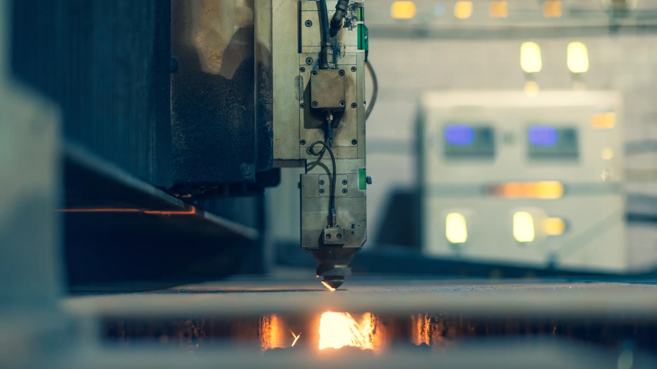

Close-up of a laser welding machine cutting through steel sheet metal in an industrial plant
Close-up of a laser welding machine cutting through steel sheet metal in an industrial plant.
