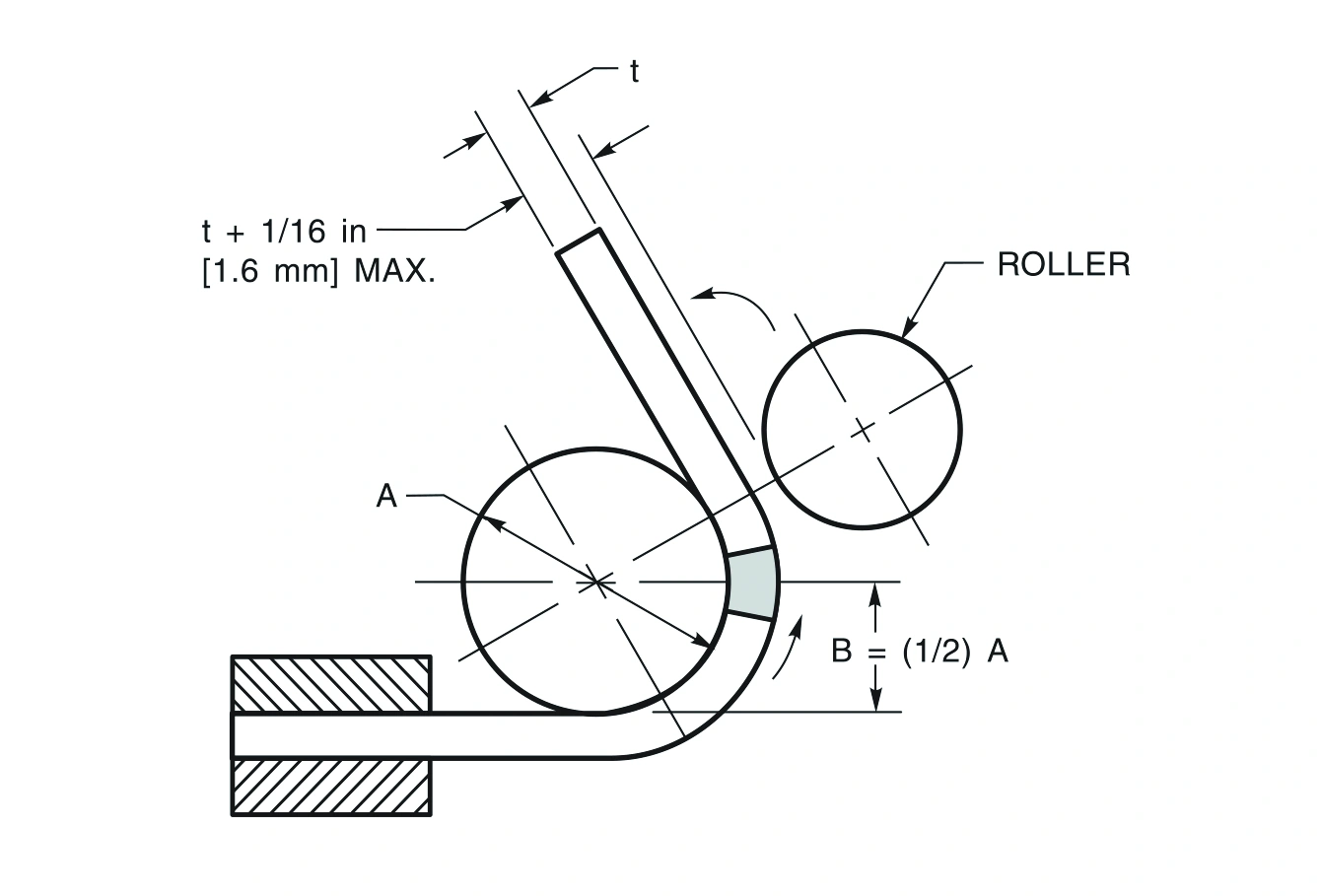

Use the Most Appropriate Testing Jig
The AWS D1.2 very clearly states that the wrap-around bend jig (Fig. 1) is the preferred method for bend testing aluminum weldments and even provides an explanation in the code commentary for why.
Most guided bend testing of steel is conducted with a die-and-plunger arrangement, also known as the plunger-type guided bend test. The heat-affected zones of welds in aluminum alloys, particularly in heat-treatable alloys (such as 6061-T6), are significantly softer and weaker than the surrounding material. If these welds are bent around a plunger, the sample can deform sharply in the heat-affected zones and kink or break without adequately bending the weld metal, resulting in a test failure. To avoid such meaningless test failures, the wrap-around bend test fixture should always be used for testing aluminum. This testing method forces the test specimen to bend progressively around a pin or mandrel so that all portions of the weld zone achieve the same radius of curvature and, therefore, the same strain level. The plunger-type test jig may be suitable for some low-strength base materials. However, I believe the wrap-around bend jig should be used for all aluminum base metals — why take a chance?

AWS D1.2 stipulates special bending conditions for various base metals and filler metals. In your situation, you are working with an M23 base metal and an F23 filler metal. Test samples of base metals within the 6xxx series (M23) and any base metals welded with 4xxx series (F23) filler metals are required to be tested under either of two special bending conditions: as welded or annealed. If testing is to be conducted in the as-welded condition, the test specimen must be reduced from the standard 3/8 in. (10 mm) thickness to 1/8 in. (3 mm) before bending, then bent over a diameter of 16-1/2 thickness. If annealed before testing, the standard 3/8 in. (10 mm) specimen must be bent over a 6-2/3 thickness diameter.
The specified annealing practice in AWS D1.2 is to heat the bend specimens to 775°F (410°C), hold them at this temperature for 2–3 hours, then control cool at 50°F/h (28°C/h) down to 500°F (260°C). The rate of cooling below 500°F (260°C) is unimportant.
