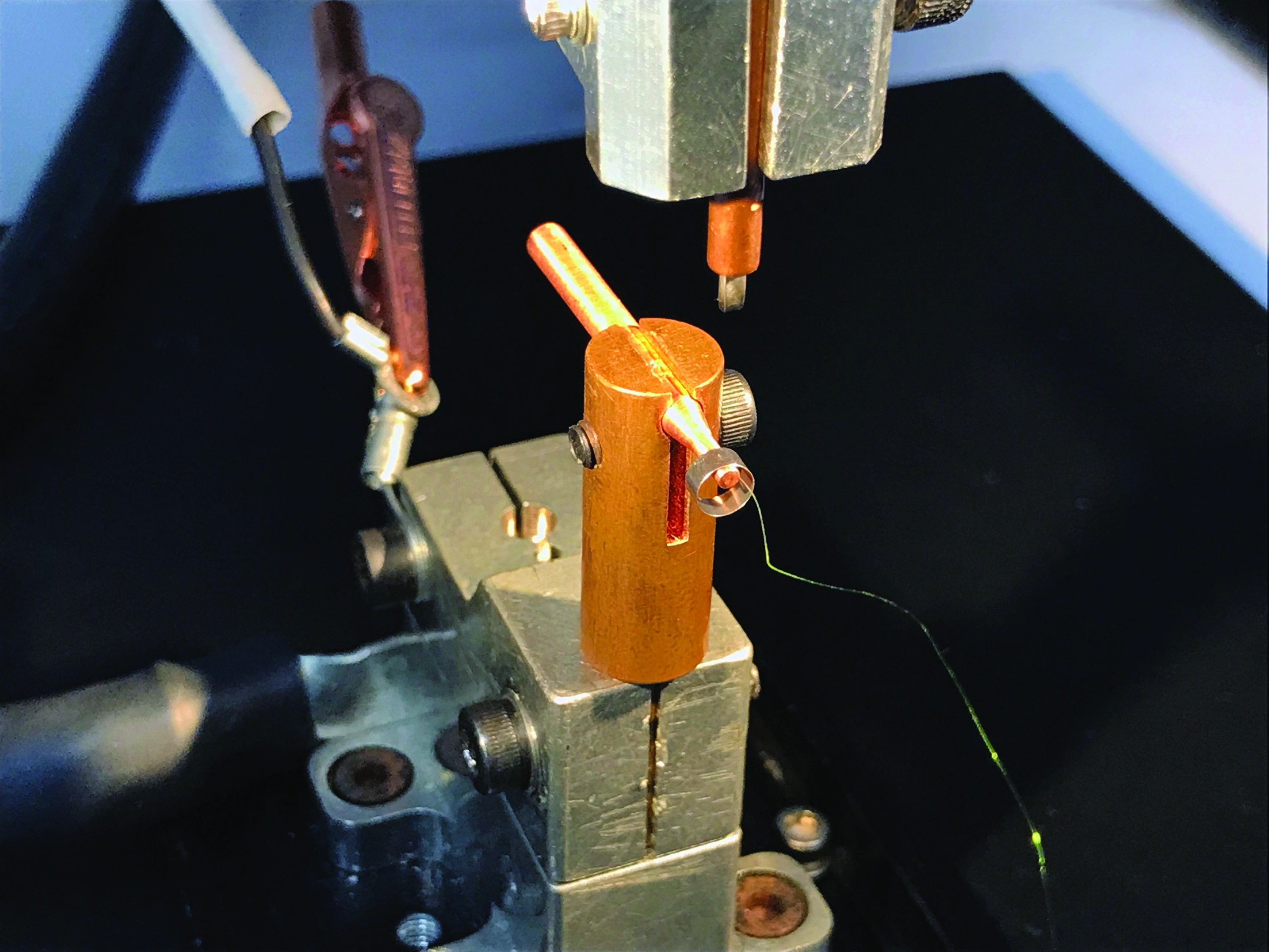

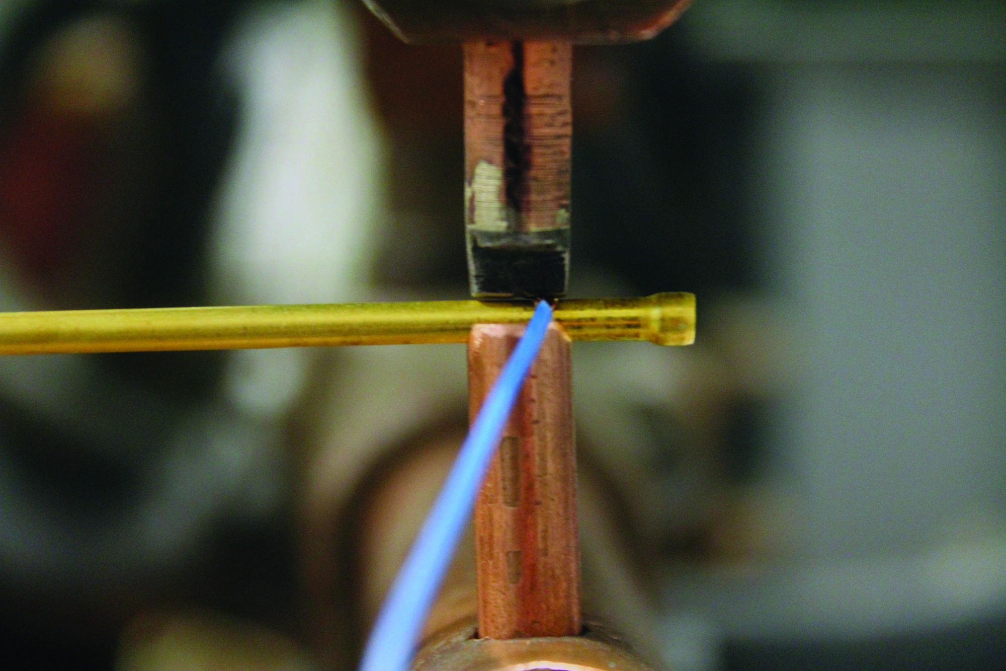

An example of resistance welding in medical device assembly is the fabrication of a cannula used in a suction coagulator — Figs. 2, 3. A cannula is a small tube designed for insertion into body cavities, such as veins or the nostrils. This surgical device uses suction to remove fluid while simultaneously coagulating or sealing blood vessels, helping reduce infection risk. In this application, a 24 AWG (0.0201 in./0.51 mm diameter) stranded wire is welded to a brass or stainless steel cannula (0.010 in./0.254 mm diameter). Each strand within the 24 AWG wire is approximately 32 AWG (0.008 in./0.2 mm) O.D., and both conductivity and mechanical strength of each strand must be preserved throughout the welding process.

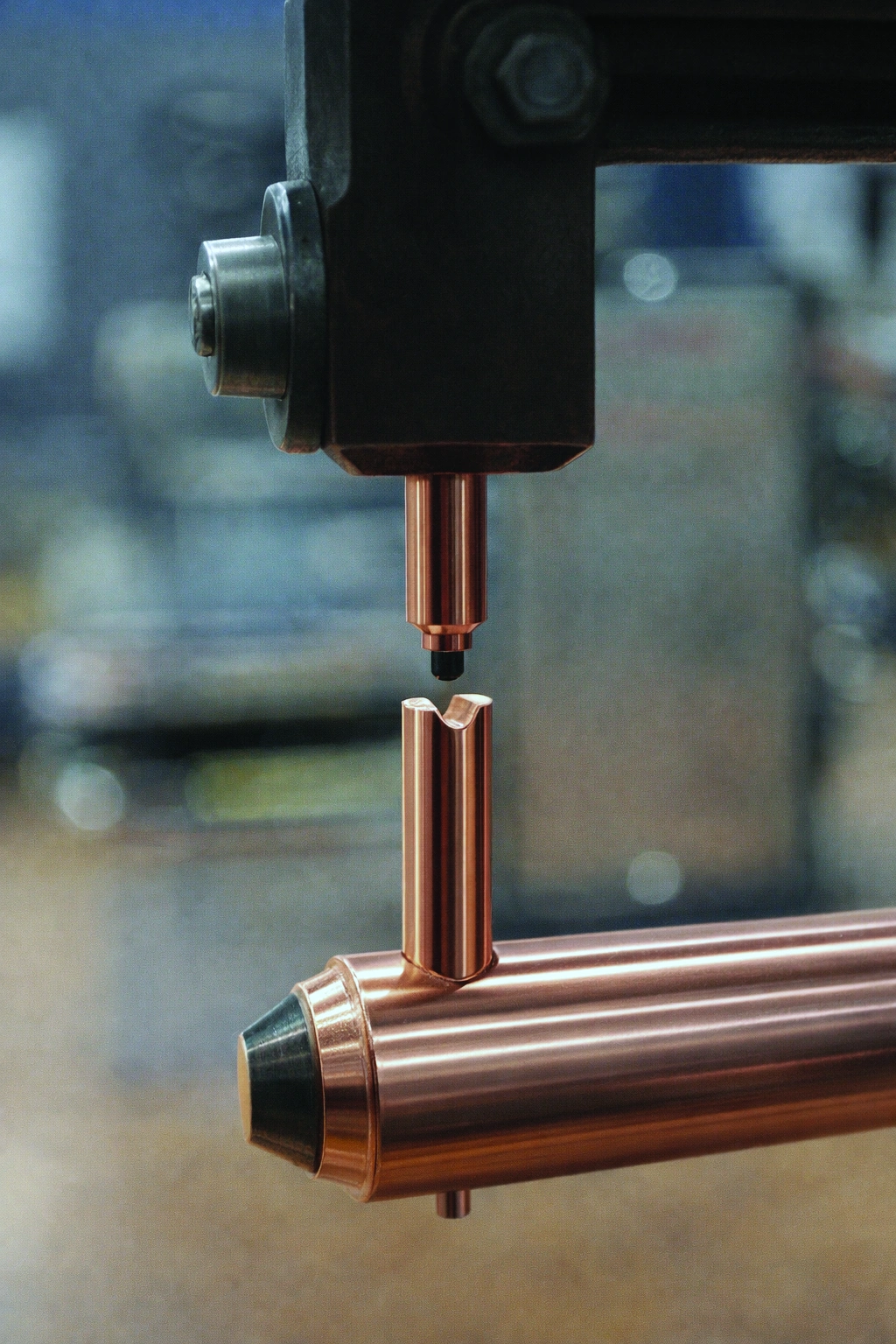

Electrode placement and design are also critical variables. In the cannula example shown in Figs. 2 and 3, vertically oriented electrodes are required to maintain alignment and properly contain the wires. When welding multiple wires to a cannula, a saddle groove electrode helps contain the strands and minimize splaying. This results in a cleaner weld appearance and reduces potential failures, such as improper performance or short circuits caused by severed or loose wire strands; however, it demands precise wire placement. A simple chisel-point upper electrode offers a forgiving setup and can accommodate a range of wire sizes with a single design, albeit with increased strand deformation compared with a flat electrode.

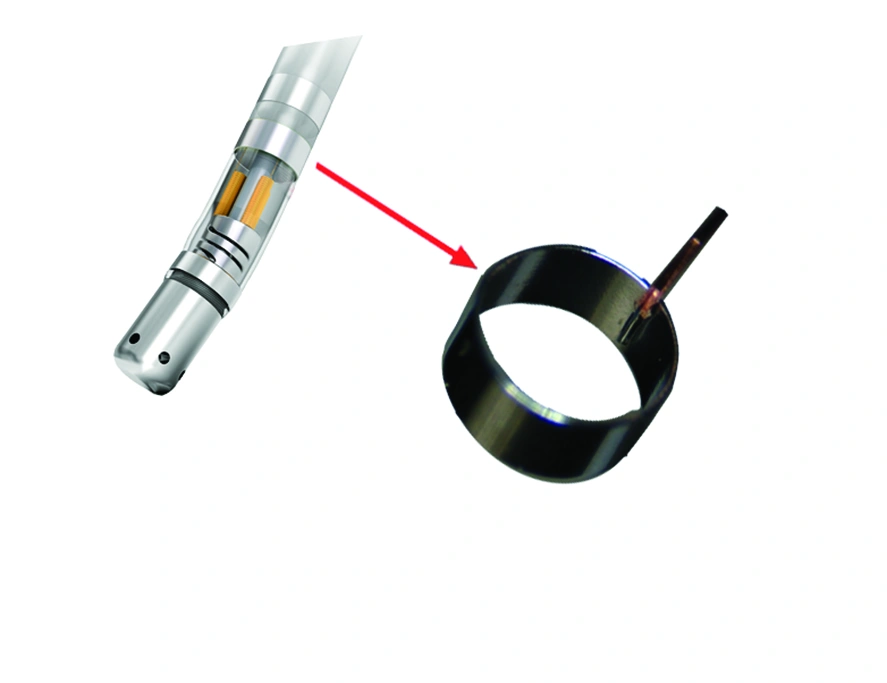

A related, smaller-scale application involves welding fine wires to platinum rings — Fig. 4. The platinum rings with connected wires are typically used as electrodes and also serve as radiopaque marker bands in minimally invasive devices such as catheters, stents, and pacemaker leads. During ultrasound-guided procedures, their visibility in ultrasound images allows clinicians to track the position, depth, and orientation of devices such as catheters and guidewires in real time.
Surface preparation is especially critical for these types of applications. Any coatings, such as insulation or plating, or residual contaminants on the wires can introduce unpredictable resistance at the weld interface, leading to localized overheating, inconsistent nugget formation, and increased electrode sticking. Therefore, all insulation and plating must be completely removed from the wire prior to welding. Because of the small wire size, low current and very low force are required for success, minimizing deformation of these delicate components. The best electrode geometry for this weld is a horizontal lower electrode supporting the ring, and a vertical electrode that attaches the wire to the inner part of the ring — Fig. 5.

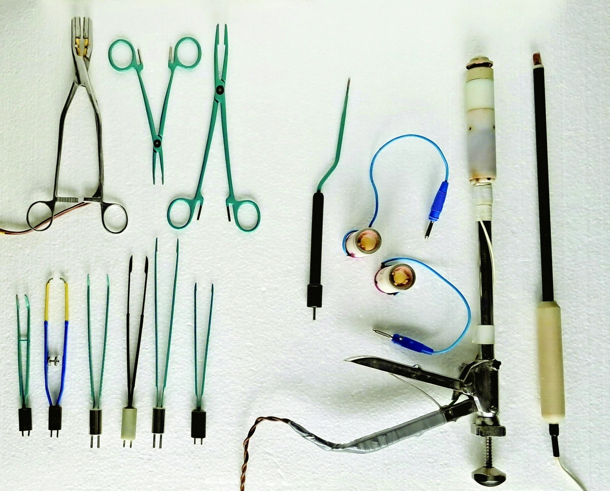

Electrosurgery is another resistive process. Borrowing heavily from standard resistance welding principles, it uses a high-frequency (HF) power supply (typically
350 kHz–1 MHz) with impedance measurement to deliver electrical energy to the treatment site through various clamp configurations (Fig. 6) while monitoring parameters and, in some cases, adjusting algorithms to control the outcome. The electrodes differ, and no metal is being joined, but the core challenge is familiar: insufficient force, current, or time leads to joint failure, while excessive levels can cause irreversible damage to the base material.
