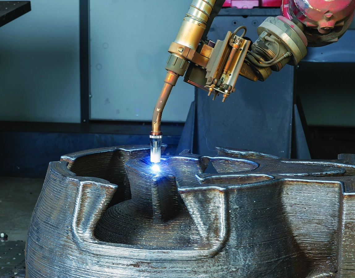

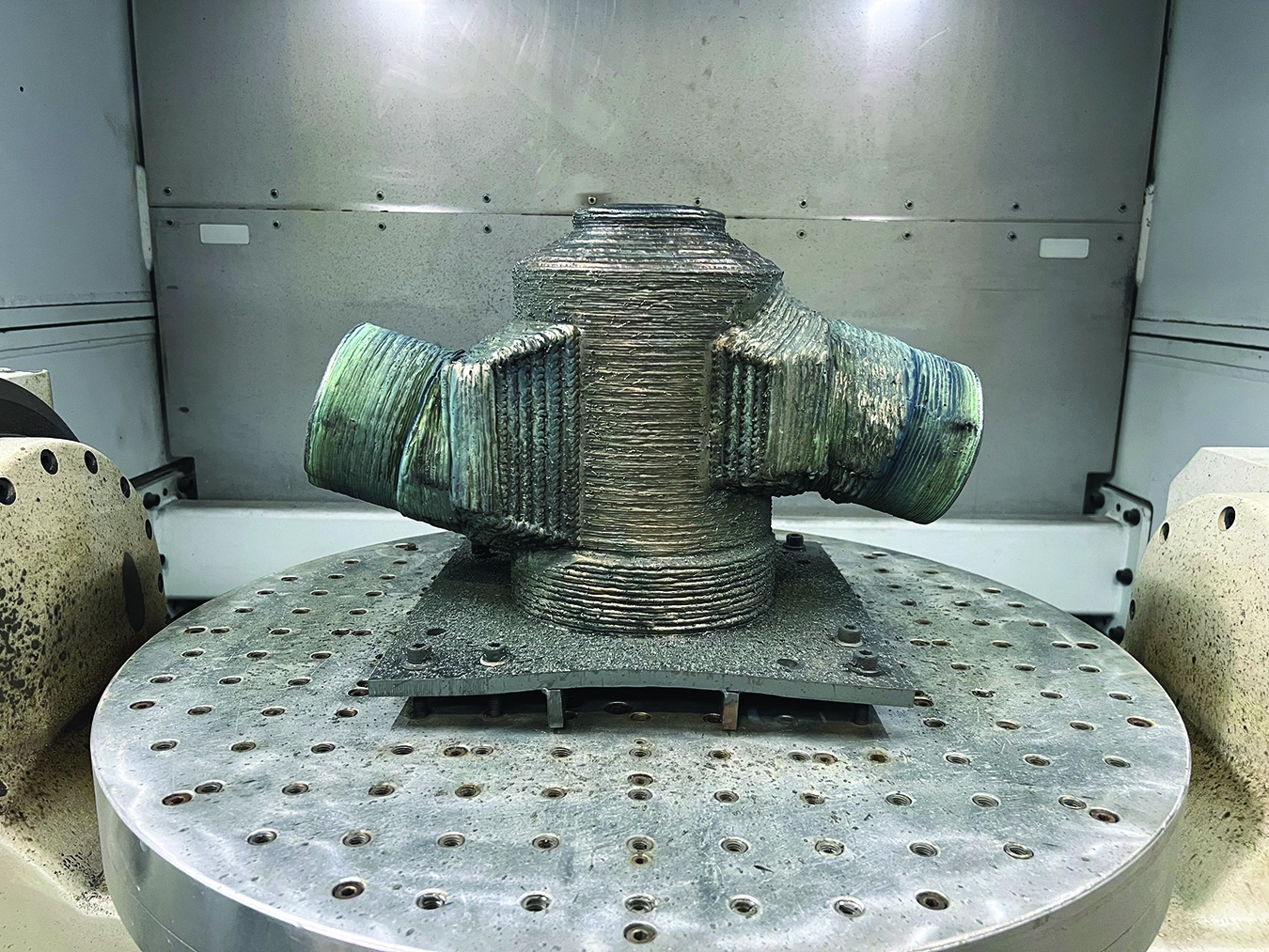

In the establishment of the new AWS D20.2 specification, the D20B Subcommittee increased reliance on established standards such as AWS B2.1, Specification for Welding Procedure and Performance Qualification, and placed greater emphasis on engineering control throughout the document such that the specification could be effectively applied across multiple industries and use cases. By anchoring D20.2 in well‑defined, industry‑proven frameworks, the committee aimed to streamline qualification and inspection requirements without compromising rigor or broad applicability. Building on this foundation, the proposed updates introduce several key enhancements:
- Responsibility for determining nondestructive examination methods and acceptance criteria now resides with the engineer, supported by example criteria appropriate for various applications.
- Procedure qualification adapts essential variables from AWS B2.1 to reflect specific DED process types, and the overall qualification approach aligns with methodologies used by ASME Boiler and Pressure Vessel Code, Section IX, and NAVSEA, allowing manufacturers to qualify a general performance envelope suitable for the inherently dynamic nature of DED.
- The allowable production component size is tied to the qualification coupon dimensions, providing a scalable and defensible path for production work.
Structured requirements specific to qualifying wire DED additive machine operators have been added.
