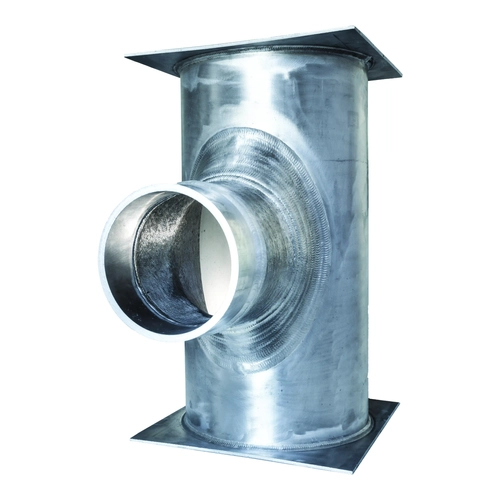

When selecting a DED process, factor in the desired structure shape, material type, and component size. GMAW processes excel in AM when building larger components and where versatility is needed with a wide variety of materials. Laser-directed energy excels in precision and resolution, allowing for more-intricate details compared to a GMAW process. Postprocessing is another factor to consider, as all DED processes often require postprocessing steps, like machining, to achieve the required dimensions for the build — Fig. 2.
Fig. 2 — Aluminum additive pipe branch.

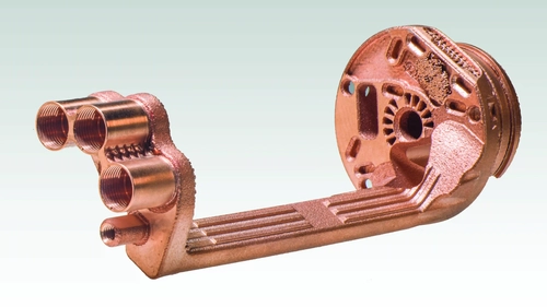

One technology that stands out for its ability to turn powdered metal into intricate and complex parts is powder bed fusion (PBF) — Fig. 3. This technique uses a laser or electron beam to selectively melt and fuse layers of metal powder, building complex 3D shapes. The result? Components with geometries so intricate, they’d be nearly impossible to produce using traditional manufacturing methods. But like all powerful tools, PBF comes with trade-offs.
Compared to other additive manufacturing techniques, PBF can be relatively slow, making it less ideal for high-volume production runs. It’s a master of detail, not speed.
Safety must also be considered. The same fine metal powders that make PBF so precise also pose health risks. Inhalation of these particles can be hazardous, and some powders are toxic upon skin contact or may cause allergic reactions. Dust clouds formed from mishandling powders can be combustible, causing flash fires or explosions. That’s why strict safety protocols are non-negotiable. Proper personal protective equipment, appropriate ventilation and filtration systems, and careful material handling are essential to keeping the workplace safe.
Fig. 3 — Copper media distributor.
