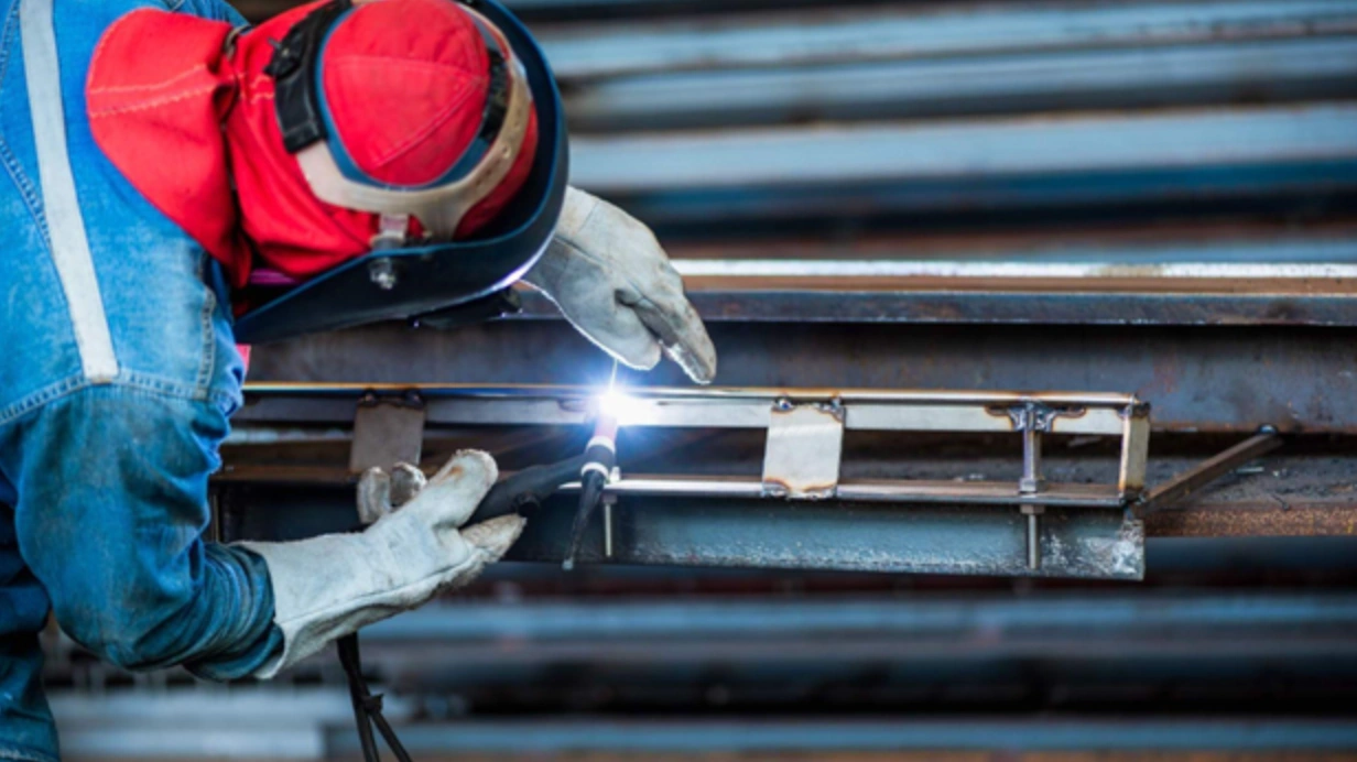

Welder in protective gear welding beams.
