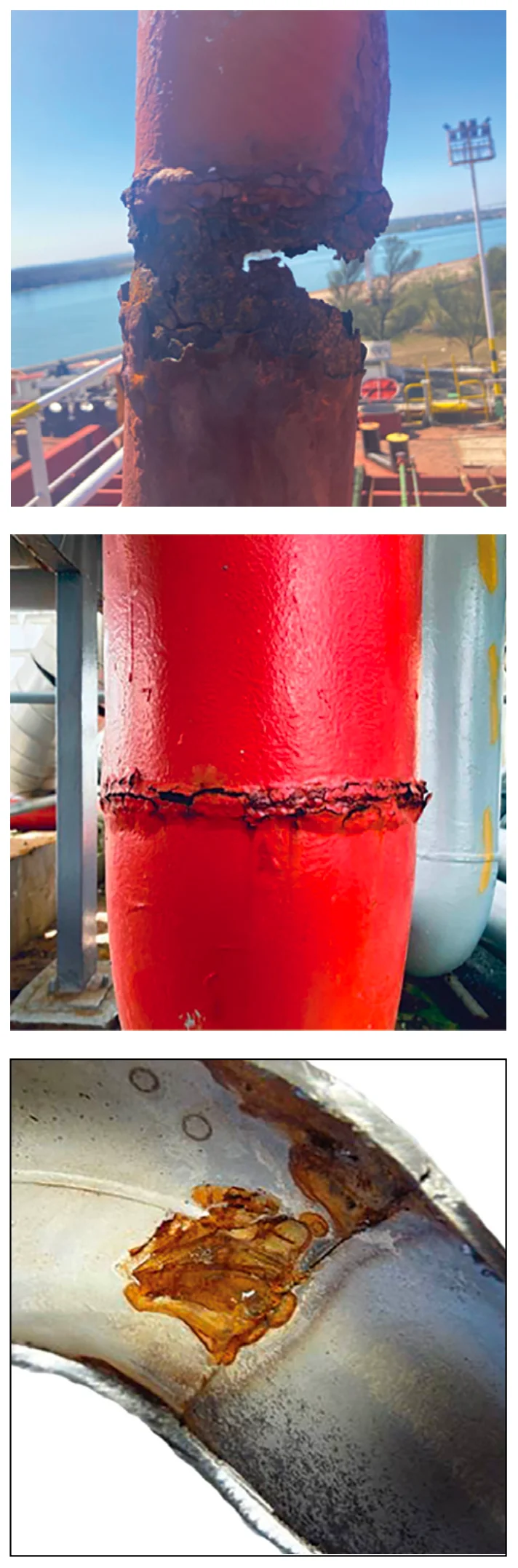

Geometry is only part of the story; a welded joint is inherently heterogeneous. The base metal, weld metal, and heat-affected zone (HAZ) differ in microstructure, composition, and often in hardness. These differences translate into variations in electrochemical potential. Under certain conditions, localized galvanic cells can form across the weld region. One area, often the weld metal or a portion of the HAZ, acts as an anode and corrodes preferentially.
Under static conditions, this may result in relatively slow, localized attack. Under flowing conditions, the situation changes dramatically. Corrosion initiates in the more susceptible region, and erosion prevents the corrosion products from accumulating and forming a protective barrier. Instead, they are continuously removed, keeping the surface active and exposed. The result is accelerated, localized wall loss, often manifesting as grooving along the weld line or preferential thinning at the toe or root.
Internal weld geometry can accelerate corrosion-erosion even when a weld meets inspection requirements.
