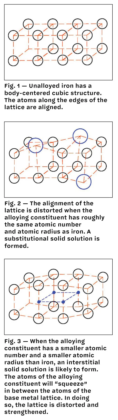

Metals are unique compared with other materials that form solutions such as sugar dissolved in water or oil mixed with gasoline. Metals can dissolve into each other; that is, one metal can dissolve into another metal. Figure 1 shows a pure metal with a basic cubic structure, either face-centered cubic (FCC) or body-centered cubic (BCC). The solid solutions may form either a substitutional solid solution or an interstitial solid solution, as illustrated in Figs. 2 and 3. In general, if the alloying constituent has nearly the same atomic number and nearly the same atomic radius as iron, it will most likely form a substitutional solid solution. If both iron and the alloying constituent have the same crystalline structure, the probability of forming a substitutional solid solution is enhanced. In a substitutional solid solution, an alloying atom simply replaces an atom of the base metal in the crystalline lattice. On the other hand, if the alloying constituent has a much lower atomic number and a much smaller atomic radius, an interstitial solid solution will most likely form. In an interstitial solid solution, the “smaller” atom of the alloying constituent squeezes in between the atoms of the base metal, and in doing so, the lattice is distorted by a slight elongation. Whenever the lattice is distorted, whether by forming a substitutional solid solution or an interstitial solid solution, the hardness and strength of the alloy increase. If the solubility limit is exceeded, the excess alloying element can form a chemical compound. Fe3C (cementite) is an example. The excess alloying element can also be rejected to the grain boundary, as in the case of solute rejection experienced by a low-melting-point constituent (LMPC), e.g., sulfur. The LMPC is still in the liquid state while the iron solidifies at a much higher temperature. The LMPC, still in the liquid state, is rejected to the grain boundaries by a mechanism called solute rejection. Solidification cracking often results from solute rejection. We experience solidification cracking when attempting to weld free-machining steels due to solute rejection.

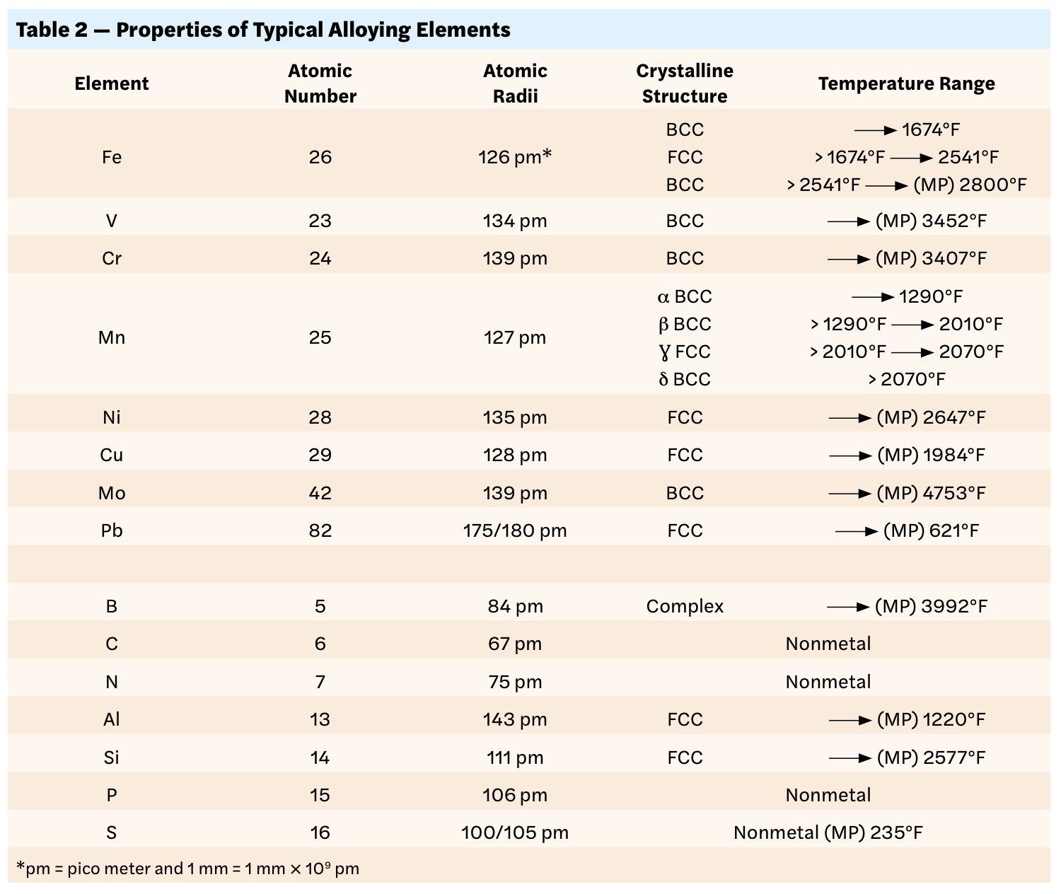

Table 2 tabulates information that is helpful in predicting whether a substitutional solid solution will form or an interstitial solid solution will form. What the table doesn’t include is the solubility limit of the elements listed because solubility is dependent on temperature.
Some metals are allotropic; that is, the crystalline structure within the lattice is dependent on temperature. The crystalline structures and the temperatures at which allotropic transformations occur are included in Table 2. Iron is well known for being allotropic. It can be FCC at high temperatures or BCC at low temperatures. Nickel is not allotropic; it is FCC at both high and low temperatures. The solubility of alloying elements, e.g., the solute, is influenced by the crystalline structure of the solvent and the temperature. Carbon, the solute, is more soluble in iron, the solvent, at high temperatures, i.e., in FCC austenite, while the solubility of carbon drops as the crystalline structure undergoes an allotropic transformation and becomes BCC ferrite.
The metals vanadium, chromium, manganese, and nickel listed in Table 2 have nearly the same atomic number and similar atomic radii as iron, so they will form substitutional solid solutions when added to iron. Copper will also form a substitutional solid solution, but it is an LMPC with very limited solubility when the iron is BCC. As the solidified iron cools and undergoes an allotropic transformation from FCC to BCC, the solubility of copper is reduced, and it is rejected by BCC ferrite. Once the temperature has cooled below the solidus temperature of copper, cracks in the copper or along the edges of the solidified copper may appear. This type of crack is categorized as a solidification crack.

Table 2 provides helpful information for determining if an alloying element will likely form a substitutional solid solution or an interstitial solid solution. The table also includes the solidus temperature, which is helpful for determining if the alloy can potentially contribute to solute rejection and result in solidification cracking during welding.
