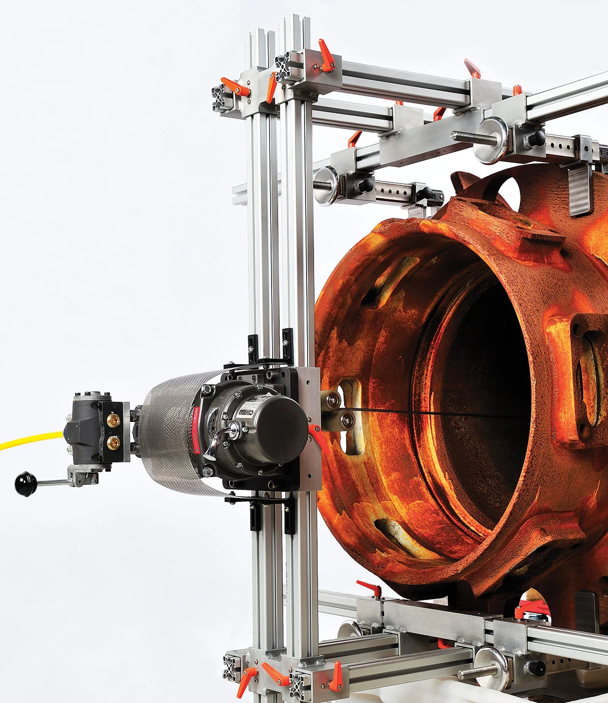

One of the key inspection requirements for marine risers is accurate internal corrosion mapping. Corrosion within the main bore can occur gradually over time and may remain undetected until significant wall loss has developed. To address this, specialized immersion ultrasonic testing scanners equipped with high-channel probe arrays can generate detailed wall-thickness measurements along extended pipe lengths — Fig. 2.
Fig. 2 — A Phoenix Inspection Systems Ltd. (Phoenix ISL) main bore winch assembly.
The main bore scanners are deployed using pneumatically driven winch systems that provide controlled traversal through the riser. Integrated encoders continuously monitor scanner position, ensuring accurate spatial correlation between the inspection data and the physical location within the riser. By creating a controlled flooded inspection zone, the scanners maintain stable acoustic coupling and consistent signal transmission throughout the inspection process.
The baseline inspection configuration incorporates 56 immersion probes, while advanced versions can accommodate up to 84, enabling greater circumferential coverage within the bore. This significantly increases data density and improves the probability of detecting localized corrosion or wall thinning.

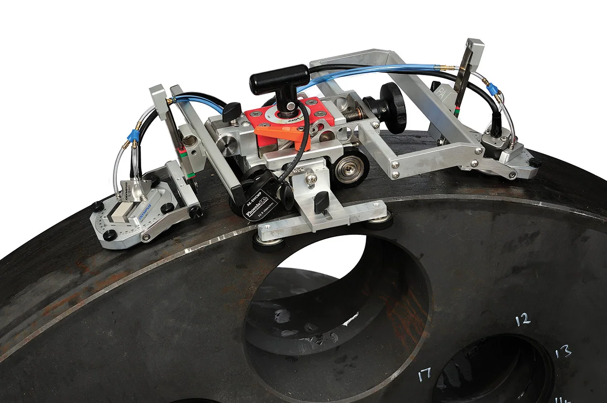

Flange inspection represents another critical aspect of marine riser integrity management. Flanges are subjected to high loading and sealing stresses and can be vulnerable to cracking or corrosion, particularly around sealing surfaces and weld interfaces. To inspect these areas effectively, external and internal flange scanners tailored to the specific geometries involved are used.
External flange inspection is performed using magnetic scanning buggies equipped with dual phased array probes and positional encoding systems. These scanners can traverse flange surfaces while maintaining stable probe contact and precise positional tracking. Internal flange inspection, meanwhile, is achieved using compact probe carriersand specifically designed for confined access conditions — Fig. 3.
Fig. 3 — A Phoenix Inspection Systems Ltd. (Phoenix ISL) magnetic scanning buggy used for flange outside diameter (OD) inspection.
