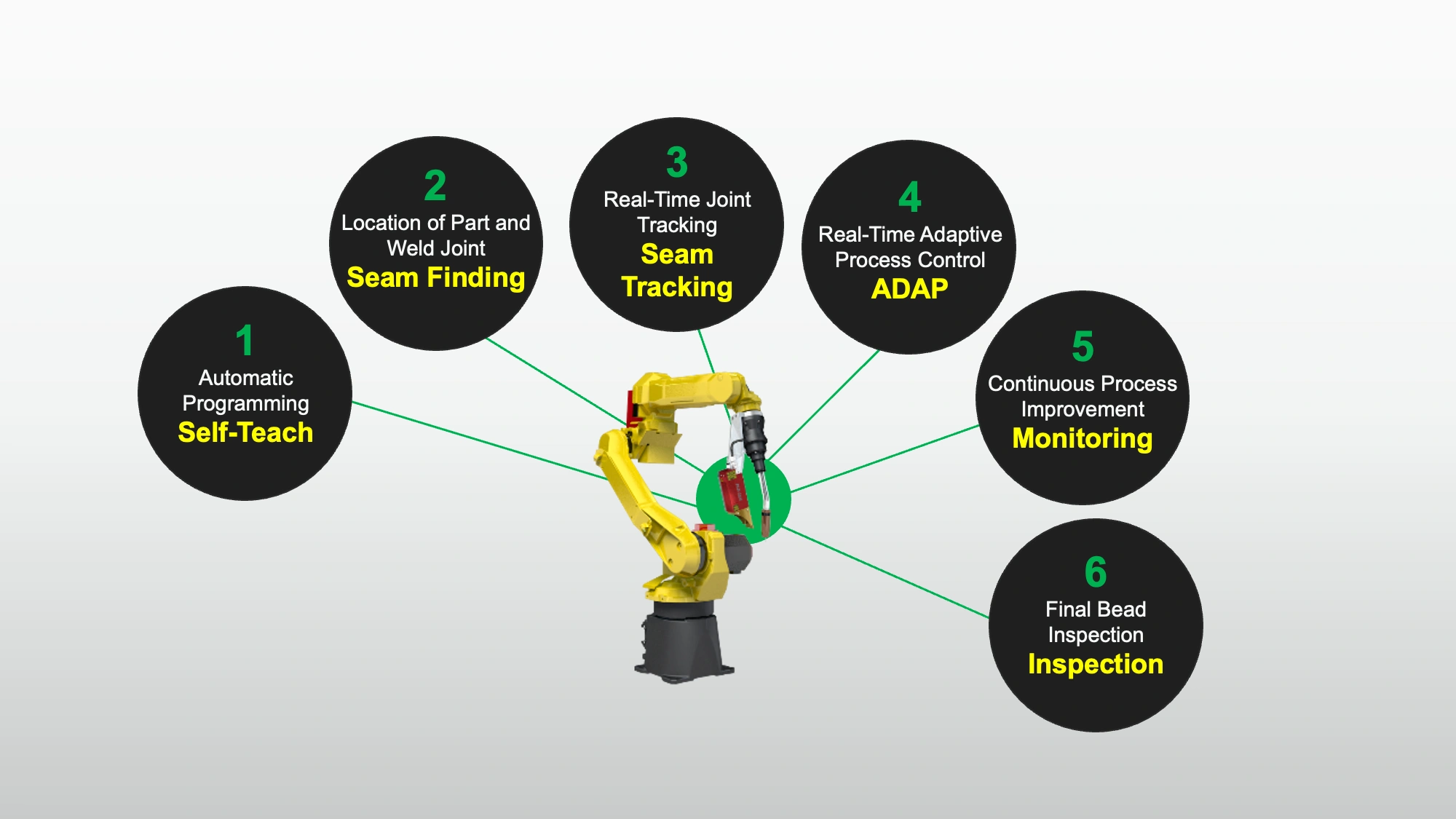

Fig. 2 — 3D robot vision system essential functions.
Robots must adapt to their environment in real time. Vision and sensing are no longer optional features but are prerequisites for high-quality robotic welding.

3D robot vision fundamentally changes what robots can do. Before welding, vision systems enable seam finding and joint localization, eliminating time consuming manual programming. During welding, real-time seam tracking enables robots to compensate for joint variations and maintain optimal wire position. After welding, the same sensors inspect the finished weld bead, measuring size, shape, location, and defects.

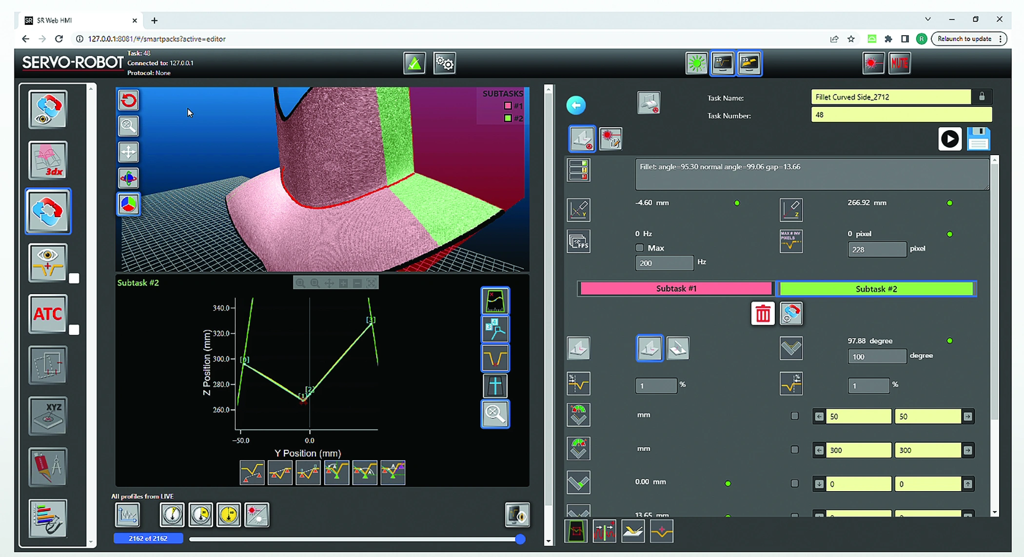

AI enables automatic joint recognition, self-programming robots, adaptive path correction, and predictive quality control. Instead of relying on fixed thresholds, machine learning models learn what constitutes acceptable and unacceptable welds based on real production data and customer standards Fig. 3.
IT Aug 2026 - The Next Evolution of Welding Automation and Inspection - Fig 3.webp
Fig. 3 — Machine learning enables machine vision systems to automatically configure vision tasks from a simple 3D scan of a part, accommodate multiple geometries within the same joint, provide operator-friendly visualization through a web-based interface, and allow fine-tuning when needed.

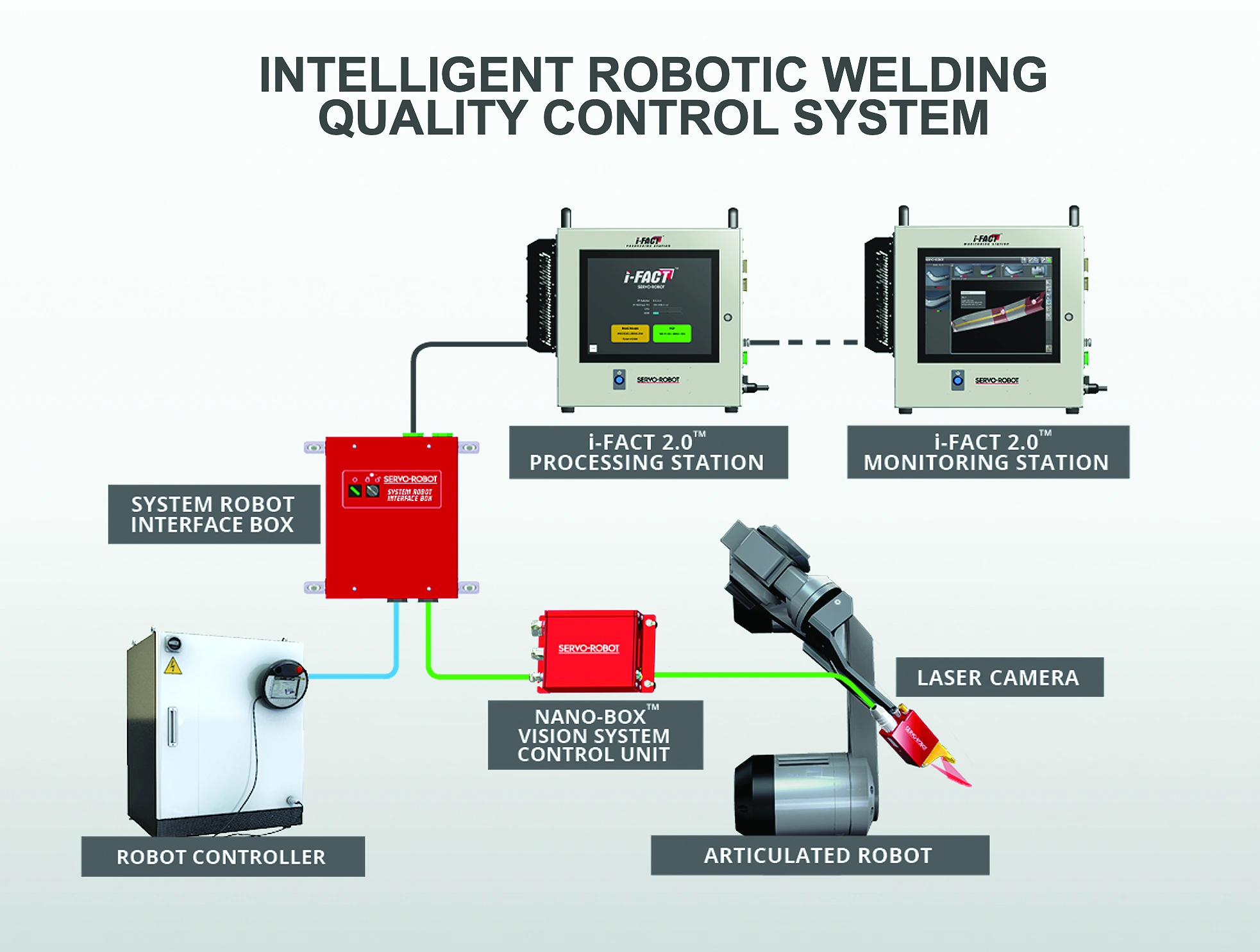

Fig. 4 — An example of an intelligent robot welding quality control system.
Automated visual weld inspection changes that equation Fig. 4. Using robots and laser vision systems, manufacturers can measure weld geometry along the entire joint; detect undercuts, porosity, insufficient material, and other defects; and store the results in sortable databases. 3D surface maps enable intelligent defect detection by comparing nonwelded and welded parts to identify missing or noncompliant welds Fig. 5.

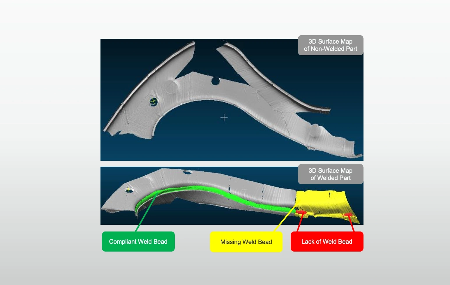

Fig. 5 — An example of 3D surface map, which collects data to achieve intelligent detection of weld defects.
Crucially, effective welding inspection begins before welding starts and continues throughout the process. Studies indicate that good visual welding inspection can detect more than 80% of defects typically associated with expensive nondestructive testing methods.

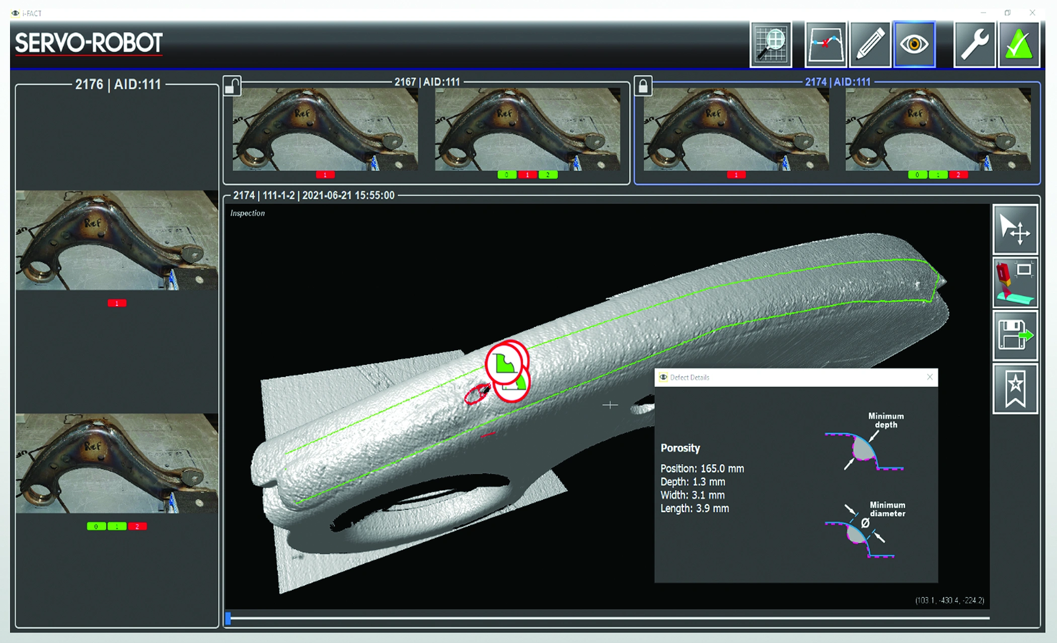

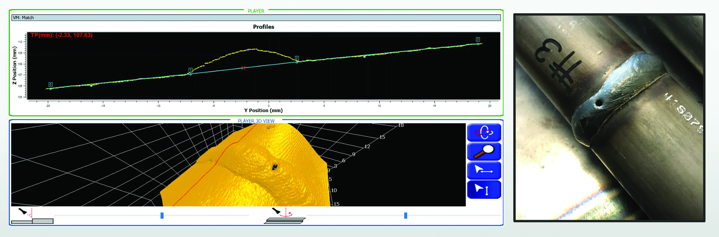

Advanced robotic inspection transforms that approach. Using laser-based 3D vision, a robot can continuously measure weld geometry across the entire joint, capturing height, width, toe angle, and surface defects with quantitative precision Fig. 6. The result is a complete digital record of every weld, not just a pass/fail decision. This shift enables traceability, trend analysis, and faster response when conditions drift out of tolerance.
IT Aug 2026 - The Next Evolution of Welding Automation and Inspection - Fig 6 Top.webp
IT Aug 2026 - The Next Evolution of Welding Automation and Inspection - Fig 6 Bottom.webp
Fig. 6 — Using 3D laser vision, the system can continuously measure weld geometry across the entire joint, capturing height, width, toe angle, and surface defects with quantitative precision.
Even more significant is the convergence of inspection and intelligence. Machine learning models can be trained on real production data to reflect application-specific quality standards, reducing variability between inspectors and facilities. By correlating inspection results with process and trajectory data, manufacturers gain insight into why defects occur, not just where they appear.
