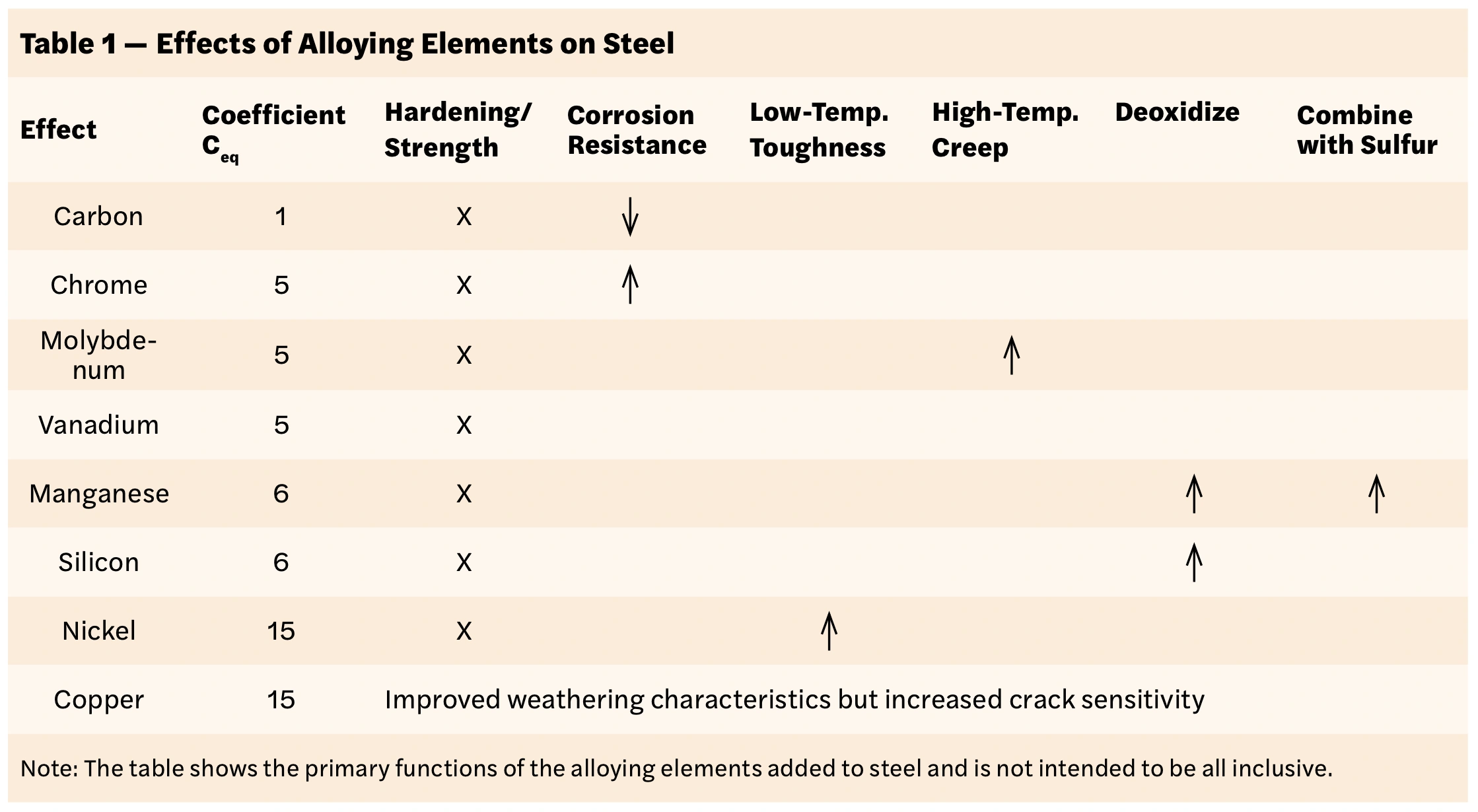

During your studies for the Certified Welding Inspector (CWI) examination, you learned that steel is a combination of iron and carbon. Carbon is the primary alloying element added to pure iron to make steel (see Table 1). While that might sound simple, the process is complicated because carbon can either remain in solid solution or form a chemical compound.

There are other elements that can be added to steel that enhance its properties in a similar way that carbon does, but they do not degrade weldability (ease of welding) to the same extent that carbon does. Some alloy additions also have other benefits besides increasing the strength of steel.
What are some of the other benefits? Chromium increases strength, and it can improve corrosion resistance if added in sufficient amounts. We see a slight improvement in corrosion resistance when the chromium content exceeds 4.5 to 5%, but corrosion resistance is noticeably improved when the chromium content exceeds about 11%.
Small additions of nickel, on the order of 1 to 3%, can improve strength and low-temperature toughness.
Manganese performs several important functions when added to iron. Up to about 1%, it acts as a deoxidizer to prevent porosity while making steel or depositing a weld. When there is sulfur, we typically increase the manganese to about ten times the sulfur content so that it chemically combines with the sulfur to form rounded manganese sulfide inclusions that mitigate the tendency of the weld to crack during solidification. Manganese in amounts in excess of that needed for deoxidation or to counter the effects of sulfur acts as a strengthening agent. Manganese added to iron in roughly 11 to 14% produces Hadfield steel, which work hardens when subjected to repeated blows. It sees applications in mining, quarry, and excavation equipment.
Molybdenum improves strength at high temperatures (improving creep resistance). Some alloy additions can influence more than one property of steel, but never forget that any increase in strength and hardness is accompanied by a reduction in ductility.

It is useful up to a carbon equivalent of about 0.6. This upper limit is appropriate for most steels commonly used in construction of buildings, bridges, and ships. It shows how influential the alloying elements found in those steels are relative to carbon. Simplified, the equation indicates that it would take 5% chromium to produce the same hardness as 1% carbon, whereas it would take 15% nickel to produce the same hardness as 1% carbon.
That may be an oversimplification, but you can see that both chromium and molybdenum have a smaller effect on hardness than carbon, whereas nickel is not nearly as effective as chromium or molybdenum as a hardening agent. So, to attain the same strength, elements other than carbon can be added to steel without dramatically increasing the carbon equivalent or reducing weldability, but at a higher cost. The lower the carbon equivalent, the less likely delayed cold cracking will be a problem. So, we have alloy steels that retain ease of welding, yet have high strength, good high-temperature properties, or low-temperature properties without the problems we would expect if we were welding steels alloyed with carbon alone.
