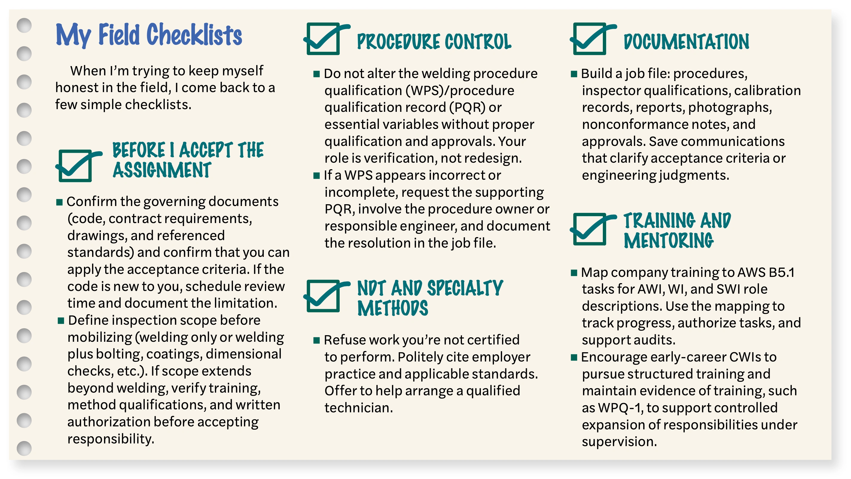

Ethics in Action: What CWIs Must Not Do
When people ask me what a CWI “is allowed” to do, I usually flip it around. The career-saving question is, what should I not do?
1. Don’t act like an engineer. A CWI should not change welding procedure specifications (WPSs) or procedure qualification records (PQRs) without qualification. Their role is to verify compliance, not to redesign the process. Substituting filler metals, tweaking essential variables without qualification, or approving procedures outside their qualified range crosses a bright ethical line.
Do not assume authority you do not have. Only the engineer of record, or other designated authority, can make design decisions and code interpretations that change requirements. If I need a disposition, I get clarification and make sure it’s documented.
2. Do not perform nondestructive testing (NDT) that you are not certified to perform. A CWI credential does not qualify a person for penetrant testing, magnetic particle testing, ultrasonic testing, radiographic testing, or other NDT methods unless the individual meets the method requirements under the applicable standard and the employer’s written practice. When a job requires NDT, I verify technician qualification records and that the procedure and equipment meet the project requirements.
3. Do not ignore documentation. Inspection decisions must be traceable. I keep procedures, inspection reports, correspondence, photographs, and approvals organized. If a dispute arises years later, the record is what supports what was inspected, what was accepted or rejected, and why. If it isn’t documented, it didn’t happen. Paperwork is part of the job.
Verify before You Call Nonconformance
Passing a CWI exam on one code does not translate to technical competence across all codes. Moving from API work to AWS D1.1, Structural Welding Code — Steel, or into aerospace requirements such as D17.1, Specification for Fusion Welding for Aerospace Applications, requires deliberate study. These differences are not limited to the codes themselves — they extend to how procedures are written, qualified, and applied. Some codes provide detailed acceptance criteria. Others defer key decisions to engineering judgment, which increases the need for formal interpretations and written dispositions. A professional response is to pause, review the governing requirements, and then respond based on documented criteria.
That principle applies directly in the field, where the governing procedure is the immediate standard for acceptance. On a pipeline job, I once evaluated an in-service sleeve weld and saw a visible tempering (annealing) pass intended to slow cooling. My first reaction was that it was unacceptable. The qualified procedure allowed it. A welder told me to read the procedure, so I did. The takeaway is simple. The procedure controls, and the inspector must verify compliance with the approved procedure before calling a condition nonconforming.
Culture, Confidence, and Saying “No”
Inspection work requires technical confidence and procedural discipline. You have to be willing to stop work when acceptance criteria are not met. You also have to be willing to say “I do not know” when you need time to verify requirements. The inspectors who perform well over time are the ones who build training plans, seek competent review early, and maintain documentation that supports every acceptance decision.
A Career Worth the Discipline
The value of being a CWI is not quoting clause numbers. The value lies in the consistent application of acceptance criteria, documented decision-making, and disciplined control of scope. Use B5.1 to build training programs and task authorization, and use QC1 to define certification boundaries and representation rules. Decline work that requires qualifications you do not have. When you need to verify a requirement, stop and review the governing documents. Then document the basis for acceptance or rejection.
