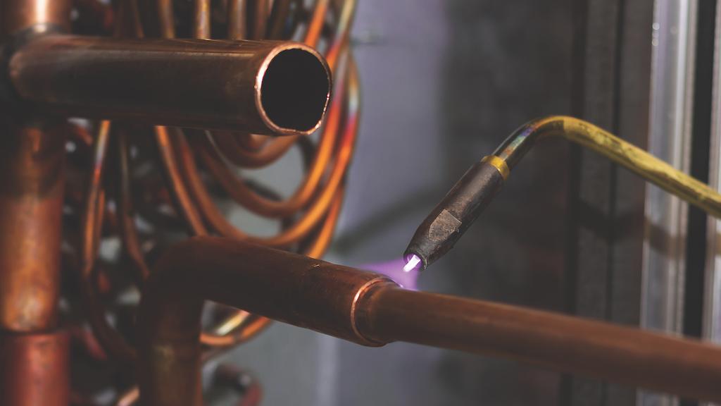

What Is an Air-Acetylene Torch System?
An air-acetylene torch system operates with a single compressed acetylene cylinder. Instead of a second cylinder of pure oxygen, this system draws oxygen from the surrounding atmosphere via a Venturi effect built into the torch tip.
Early air-acetylene torch designs struggled to produce enough heat for brazing because atmospheric air contains only about 21% oxygen. These older torches were limited to low-temperature soldering, where the required filler metal melting points fall below 840°F (as defined by the American Welding Society's standard soldering/brazing threshold).
Modern swirl combustion technology changed that limitation. In current air-acetylene torch models, acetylene gas passes through an expansion chamber at the tip, creating a Venturi effect that draws in a significantly larger volume of air. A rotor or vane inside the tip then homogenizes the air-acetylene mixture, producing a more oxygen-rich combination that burns at higher efficiency. This engineering advancement provides modern air-acetylene torches with sufficient heat output for brazing applications on copper tubing up to approximately 1 inch in diameter.
The swirl combustion design also creates a distinctive flame pattern that wraps around the workpiece rather than concentrating heat at a single point. This characteristic makes air acetylene torch systems well suited for:

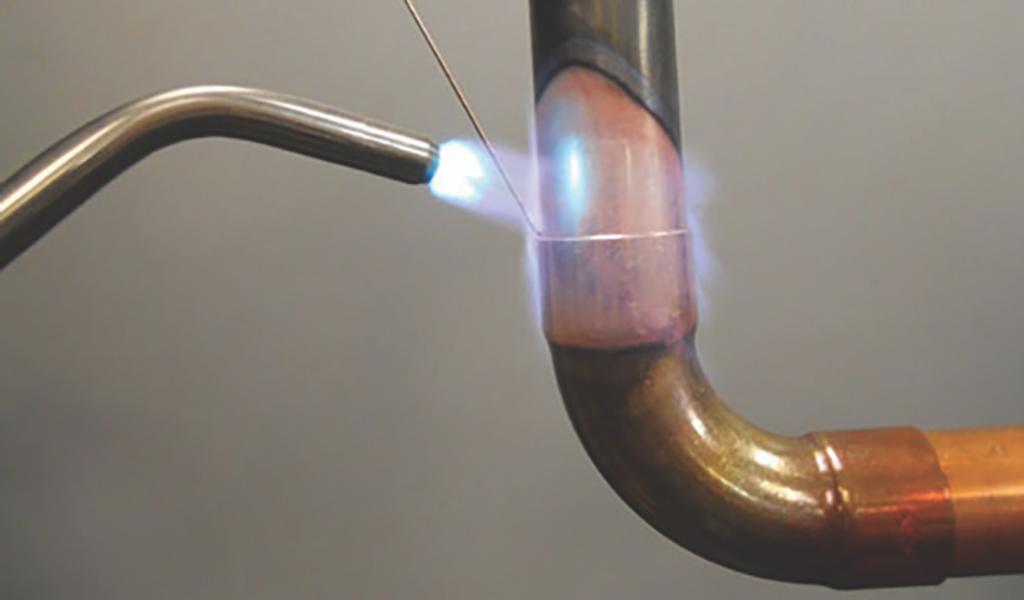

Flame Temperature and Heat Distribution
Flame temperature is one of the most significant differences between oxygen-acetylene and air-acetylene torches, but raw temperature alone does not determine which system is better for a given application.
An oxygen-acetylene torch produces a flame that reaches approximately 5,400°F at the tip of the inner cone. That concentrated heat is necessary for oxyfuel welding, where the base metal must reach its melting point, and for oxy-fuel cutting, where a stream of pure oxygen reacts with preheated steel to sever it. However, brazing does not require melting the base metal. Brazing temperatures for copper systems typically range from 1,100°F to 1,500°F, which means the oxygen-acetylene flame is more than 3,000°F hotter than what the application demands.
That excess heat creates practical challenges. When using an oxygen-acetylene torch for brazing, the operator must keep the flame in constant motion around the joint to prevent burn-through. The torch must also be held farther from the workpiece to avoid overheating. This is particularly important with heat-sensitive materials like brass and aluminum, where even brief exposure to excessive heat can damage the base metal or compromise joint integrity.
An air-acetylene torch produces a flame of approximately 3,000°F with a broader heat pattern. The swirl combustion design distributes heat around the circumference of the tube or fitting rather than focusing it at a single point. This wrap-around effect allows the operator to hold the flame closer to the joint for longer periods, reducing the risk of localized overheating. For copper brazing and soldering, this broader heat profile promotes the even preheating needed for capillary action, the physical process that draws molten filler metal into the joint gap.
Flame Characteristics and Brazing Performance
Successful brazing relies on capillary action rather than base metal fusion. The filler metal (brazing alloy) melts and flows into the joint gap between two closely fitted parts, driven by the capillary forces created when both surfaces reach the correct temperature simultaneously. Uneven heating leads to incomplete filler flow, weak joints, or voids.
With an oxygen-acetylene torch, achieving even preheating requires technique and attentiveness. The hottest part of the flame is concentrated at the inner cone tip, so the operator must continuously move the torch around the full circumference of the joint. Holding the torch stationary, even briefly, risks overheating one side while the opposite side remains below brazing temperature. This is especially important on larger fittings and thicker-walled tubing, where heat conduction through the material takes longer.
The broader flame of an air-acetylene torch simplifies this process. Its wrap-around heat distribution naturally preheats a wider area of the joint simultaneously. Many HVAC and refrigeration technicians find that air acetylene is more forgiving during brazing, particularly on smaller-diameter copper tubing, where overheating with an oxygen-acetylene system is a common beginner mistake.
For applications requiring precise flame control across a range of materials and thicknesses, the oxygen-acetylene torch remains the more versatile option. Experienced operators can fine-tune the flame type (neutral, oxidizing, or carburizing) to suit the specific base metal and filler combination. That level of adjustability is not available with air acetylene systems, where the primary control is the acetylene gas flow rate.
