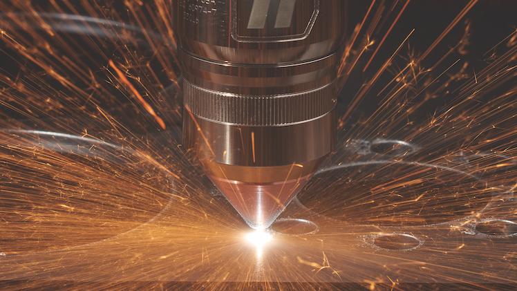

Fiber laser cutting uses a high-energy beam of light that creates a narrow and precise cut through the material, which can leave a thinner kerf and low angularity, making it ideal for cutting fine features, especially for thinner materials. Similarly, plasma-cutting technology produces high-energy, ionized gas that forms a plasma arc to cut through the material. While plasma is often viewed as producing a less-precise cut, the current generation of high-definition plasma cutting units produces part cut quality that far exceeds most customer requirements and rivals fiber laser.

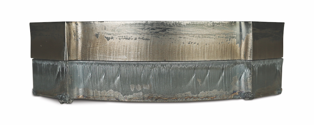

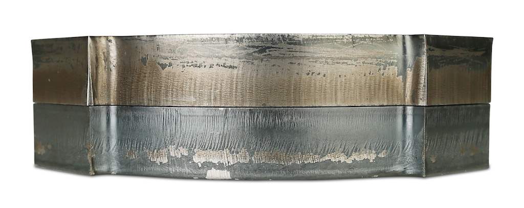

- Fiber lasers typically yield ISO 9013, Thermal cutting, range 1–2 cuts (a measure of cut angularity). High-definition plasma usually yields ISO range 2–4 cuts. This is important for companies that want weld-ready parts straight off the table.
- Plasma-cutting processes have been perfected over the years, yielding surface finishes on cut edges that are smooth and straight with minimal oxide layers and dross. Plasma-cut parts require minimal secondary operations prior to welding. While fiber laser is improving, the cut edge surface finish is often rough, with significant dross and oxide layers, especially in thicker metals over 12 mm (0.5 in.).
- Fiber laser provides a narrower kerf than plasma, which has the benefit of allowing for slightly better plate utilization and fine-feature capability. While this is usually an advantage, thin kerf size can cause issues with removing parts from a nest on thicker plates. For thick plates, parts can be difficult to remove from the skeleton and need to be hammered out.
While fiber laser kerf size and angularity capabilities are compelling, plasma has advantages in cut quality to easily meet most customer requirements.
