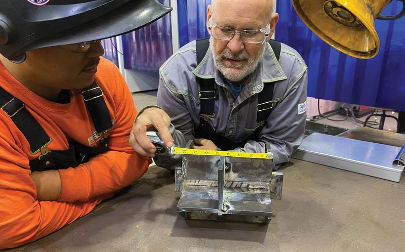

When you walk into the testing facility, introduce yourself to the inspector and get a thorough rundown of the equipment. Then ask for the WPS. This document spells out the essential variables you must follow:
- Base metal type and thickness
- Joint configuration (groove angle, root opening, root face)
- Amperage and voltage ranges
- Allowed cleaning methods (power tools vs. hand tools)
- Welding technique (stringer beads or weave)
- Preheat, interpass, and postheat temperature requirements/li>
Read the WPS carefully. One of the most common reasons welders do not pass a welding test is deviating from the procedure's parameters. If the WPS calls for stringer beads, do not weave. If it specifies a voltage range, stay within it.
After reviewing the WPS, settle into your booth and spend a few minutes adjusting the machine with practice material if the facility allows it. Getting comfortable with an unfamiliar machine before you strike an arc on your test coupon can make the difference between passing and failing.

Thorough base metal preparation and fitup are critical to passing a weld test. Time invested here pays dividends throughout every subsequent pass.
Follow these steps for a clean, consistent joint:
- Remove surface contamination. Grind or sand the groove faces and adjacent plate surfaces to remove mill scale, rust, oil, and any flame- or plasma-cut residue. The joint should shine.
- Verify the bevel. If the WPS does not require a land (root face), grind the bevel to a knife edge. If a land is required, make sure it is consistent across the entire length of the joint.
- Pre-assemble your plates. Check that your root opening is even and that the plates are aligned with minimal mismatch. Even slight high-low misalignment creates penetration problems that can lead to rejection.
- Tack securely. Place tack welds at consistent intervals and make sure the fitup remains tight to the backing strip (if applicable). Small, evenly spaced tacks hold the joint stable without creating obstacles for your root pass.
Many inspectors will tell you that fitup problems are the number-one reason welders struggle during a test. If your gap varies by even 1/32 of an inch along the joint, the amperage you need to maintain proper penetration will shift, and that inconsistency can introduce defects.
