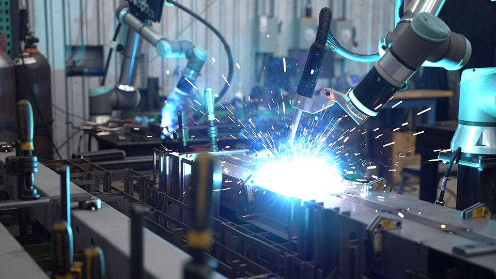

The main variables the use of a cobot will affect are as follows: Traverse Angles — Traverse angle precision is crucial to ensure the weld bead is deposited correctly to achieve optimal joint penetration and minimize defects such as undercut or excessive reinforcement.
In a production scenario, welders may inadvertently vary the angle due to hand movements or repositioning. On the other hand, cobots are programmed to hold the torch at a set angle, ensuring a uniform weld every time.
Contact-tip-to-work distance — The distance between the contact tip and the workpiece is crucial. A 1/4-in. variance can drop the amperage and significantly affect the joint’s integrity.
Because cobots are programmed and can do highly repeatable work, they ensure that the contact-tip-to-work distance remains consistent throughout the welding process and along the weld for tightly toleranced welded components.
Amperage and voltage — The amperage and voltage ratio is crucial for the quality and uniformity of a weld. A variation in this ratio can result in excessive spatter and weak welds. The contact-tip-to-work distance is a key factor influencing this ratio. So, here again, the control delivered by the cobot will ensure a consistent ratio, preventing excessive spatter and mitigating other quality issues such as porosity, incomplete fusion, and weak welds.
Maintaining all the above-mentioned parameters consistently enhances the overall reliability and efficiency of the welding process and ensures that each weld meets the same high standards.
Travel speed — Travel speed directly influences production throughput, weld quality, and heat management. When the previously mentioned variables are constant, cobots have significant advantages for maintaining high travel speeds.
“While a human might achieve 12–20 in. per minute at best, a cobot can consistently operate at three to four times that speed,” Harris stated.
Faster travel speeds can prevent common welding defects such as melt-through and excessive joint penetration.
Deposition rate — The metal deposition rate dictates the welding speed and creates the limiting step for arc-on conditions. Cobots make it easier to achieve a consistent deposition rate through providing constant robot travel speed and wire feed speed. A more consistent deposition rate enables faster metal deposition, increasing welding speeds while protecting joint quality.
Shielding gas — Proper use of shielding gas is essential in welding for both quality and cost. Overwelding, which is common in the industry, leads to excessive gas usage, wasting nearly 500% more gas than needed in a given year. Incorporating a cobot into the welding process can significantly mitigate this issue. Its consistent control optimizes shielding gas usage and ensures that only the necessary amount is used for each weld.

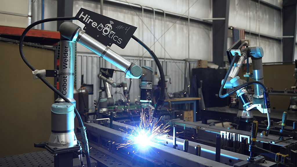

Performance at Optimized Settings — Manual vs. Cobot Cobots allow companies to set and optimize their welding process by working with more constant parameters. The welding speed can be increased while achieving the required weld specs and quality. Moreover, the whole welding process is more cost-effective and productive with fewer mistakes, reduced waste, and lower rework.
Productivity
In manual welding, the operator factor, or the actual arc-on time, which directly impacts cost efficiency, can be surprisingly low. The industry standard average operator factor is approximately 10 to 12%, with the highest being 20%. For a 10-hour day, this translates to 60 minutes of arc-on time.
Cobots drastically change this operator factor dynamic. “With a robot, you train it and it never stops. It doesn’t have to raise its hood to move from one joint to another. It just automatically goes because that’s the way it was taught,” Harris said.
Cobots can significantly increase the operator factor by maintaining continuous operation, potentially tripling the arc-on time compared to manual welding.
