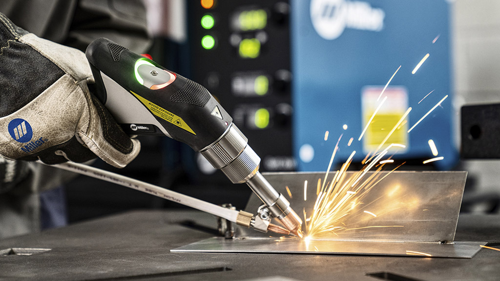

Ideal applications for laser welding are thin parts, which are common in aerospace, such as this heat shield.
