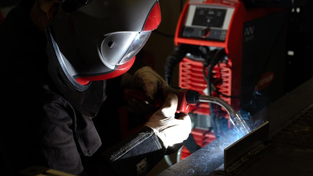

Due to the high thermal conductivity, it takes longer to establish an aluminum weld pool. The parameters also need to be reduced toward the end of the weld to compensate for the increased temperature. Common advice says to weld aluminum hot and fast due to its high thermal conductivity. Using a foot pedal with gas tungsten arc welding (GTAW) makes it easy to adjust the welding current rapidly from start to end. However, GTAW generally requires a lot of practice and skill to master. Gas metal arc welding (GMAW) is usually learned faster, and most modern machines provide hot start and crater fill functions for easy control as well as controls on the torch to adjust wire feed speed quickly during welding.

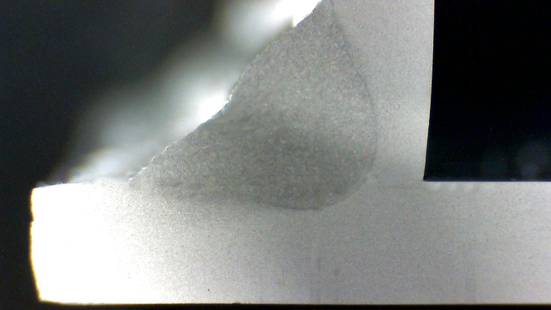

Only inert gases such as argon and helium are used in aluminum welding. In most cases, 100% argon is used because it costs less than helium, has a good cleaning effect, and, being heavier than air, effectively shields the weld pool. Helium can help achieve deeper and wider joint penetration profiles and reduce porosity, particularly when welding thick aluminum plates.

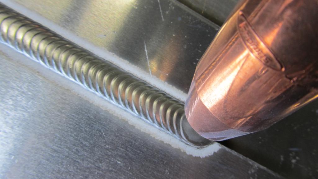

Aluminum has a fast freeze weld pool, so any mistakes immediately become apparent. Getting fusion at the arc start can be troublesome due to aluminum’s high thermal conductivity. These two things alone give rise to the idea that aluminum is difficult to weld. Many modern welding machines use a hot start function that uses higher voltage and welding current at the arc start to flash melt the surface. Likewise, for the end of the weld, the machines offer a crater fill function that reduces the voltage and current. This produces a convex crater fill, which avoids the crater cracks that can form from concave crater fills.

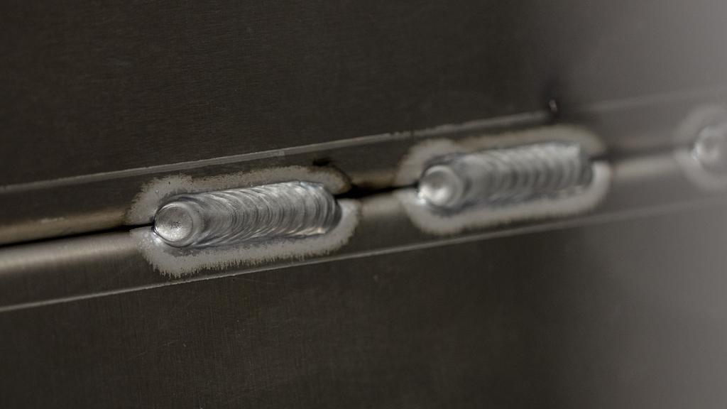

Some process variants that take advantage of aluminum’s fast freeze characteristics are available. These variants can alternate the arc power to achieve a rippled cosmetic weld. Alternating the arc power has a secondary effect of reducing heat input, which helps minimize distortion. This also can give the welder a visual cue that can aid in maintaining a consistent travel speed.
