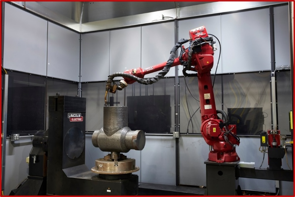

WAAM utilizes arc welding processes such as gas metal arc welding (GMAW), gas tungsten arc welding, plasma arc welding, and submerged arc welding. These processes are capable of deposition rates higher than powder-based additive manufacturing systems and are well suited for large components. Among these, GMAW has emerged as the preferred printing method by many manufacturing companies using WAAM due to its stable metal transfer modes, high wire utilization efficiency, and ease of robotic integration. Because WAAM systems can be adapted from traditional welding equipment and potentially existing setups, scalability is realistic for additive manufacturing companies.
WAAM supports a broad range of alloys commonly used in fabrication, including carbon steels, low-alloy steels, stainless steels, nickel alloys, aluminum, and titanium. Consumable availability and weldability are key considerations when selecting materials for WAAM applications. WAAM components are rooted in welding engineering and metallurgical fundamentals and exhibit solidification microstructures in the as-printed condition, making process control, interpass temperature management, and heat treatment critical. As with conventional welding, welded indications such as incomplete fusion or porosity can occur if parameters and positioning are not properly controlled.
