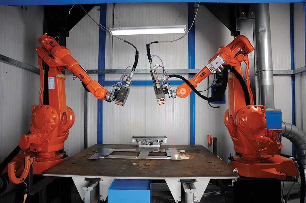

1. Capture Fumes at the Source
The closer fumes are captured to the weld, the more effective and energy-efficient the system will be. Because laser welding produces submicron particulate that disperses quickly, source capture is the most critical design consideration.
In particular, for robotic laser welding, most robotic systems are enclosed, which creates a controlled environment for fume capture. The most effective approach is to integrate extraction directly into the enclosure with properly sized ports and ducting. Original equipment manufacturers can design these features into the cell, ensuring optics stay clean, fugitive emissions are minimized, and airflow is balanced so it does not disturb the shielding gas.

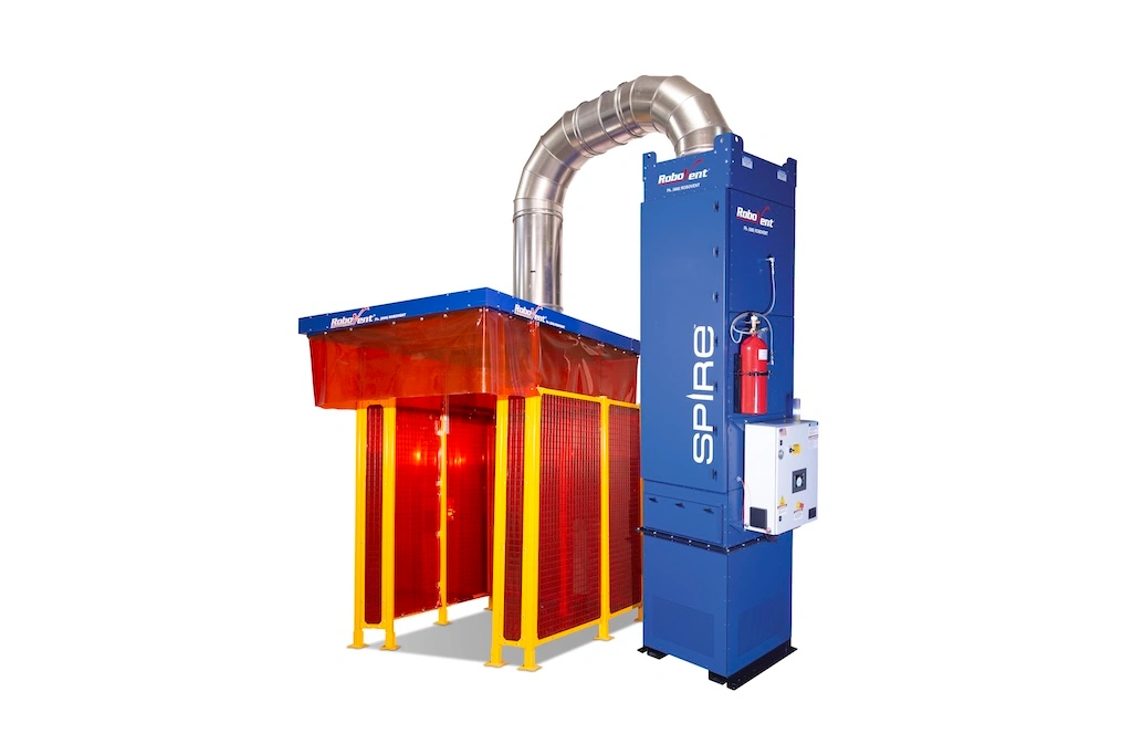

Even with good source capture, fugitive fumes can escape. In robotic systems, this often happens when enclosures are not fully sealed or when parts continue to off gas as they exit the cell. In manual welding, the challenge is greater since work is performed in the open air.
Here’s some guidance for managing fugitive emissions:
  • Ensure robotic enclosures are airtight and properly ducted to prevent leakage.
  • For manual welding, ensure source capture methods are used consistently and properly to minimize fugitive fumes.
  • Consider secondary ambient air filtration in areas where multiple welds or cooling parts create background contamination.
