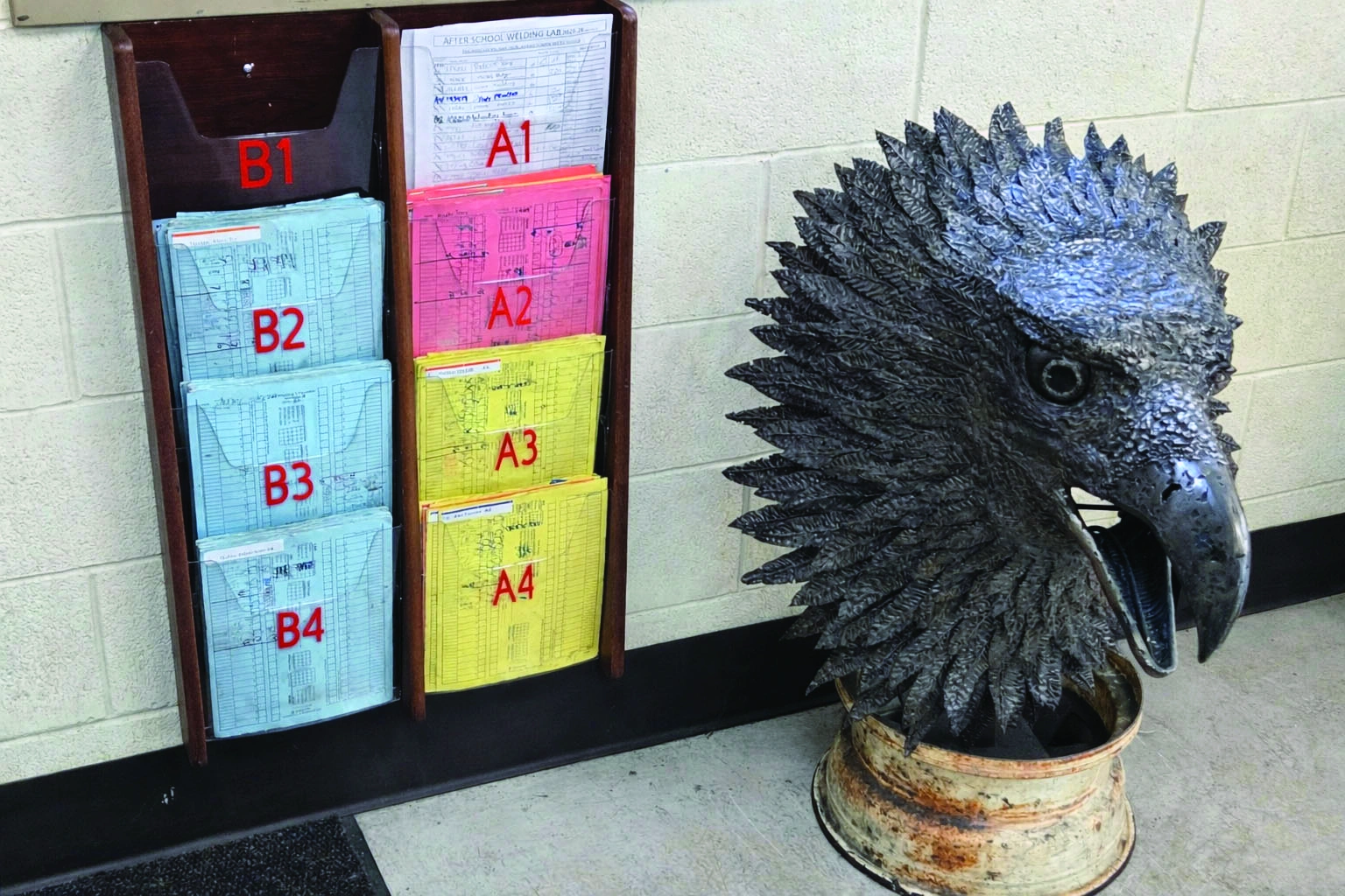

Immediate Feedback with Time Cards
To support this grading scale, I implemented a time card system that enables immediate, in-person grading with the student present. Students track shop time and bring their time card to me when they are ready to pass off a weld.
When a student presents a weld, the following occurs:
  • We evaluate the weld together.
  • I provide direct feedback.
  • I assign a score.
  • I sign the time card.
  • The student returns to work.
This process eliminates the need to store, transport, and re-evaluate welds later. More importantly, it transforms grading into a conversation rather than a delayed judgment. Students receive specific instruction while the weld is still fresh in their minds, which significantly improves retention and performance.
WJ April 2026 - Designing a Welding Program for Growth Not Just Grades - 1.webp
The time card organization caddy. Time cards help track productivity and provide structured feedback.
From an instructional standpoint, this change freed up hours of after-school grading time each week and allowed me to focus on what matters most — coaching students in the booth.
