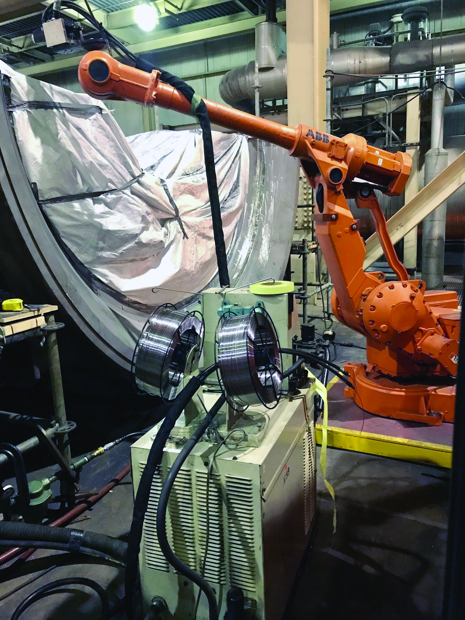

ST June 2026 - Beyond the Booth A Practical Guide to Field Thermal Spraying - Fig. 3.webp
Twin wire arc spray setup of a gas turbine enclosure at a power plant in Pennsylvania.

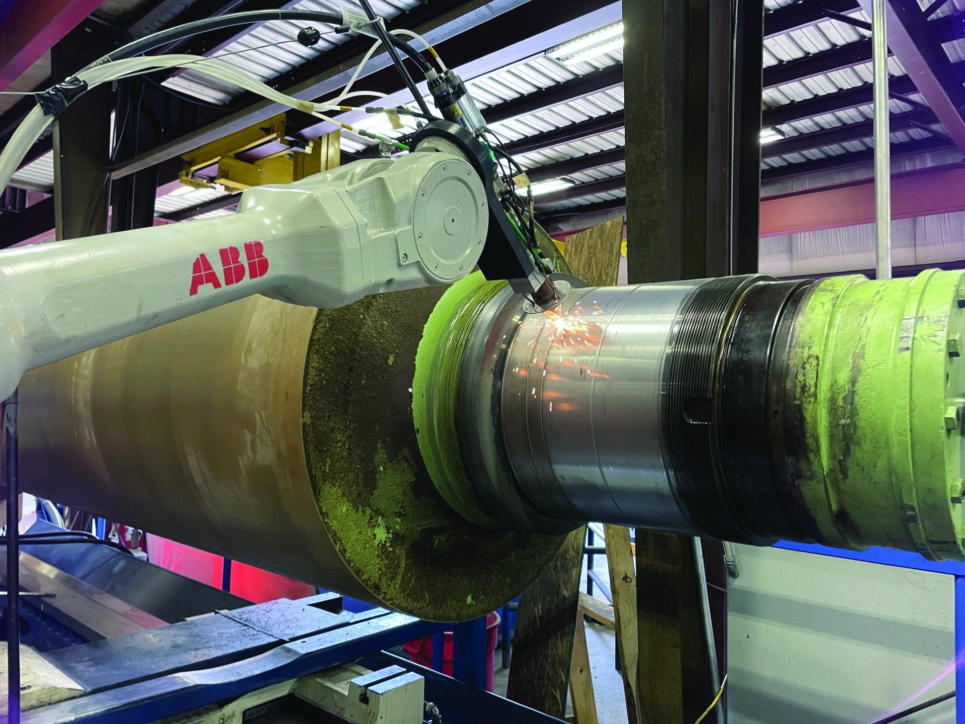

ST June 2026 - Beyond the Booth A Practical Guide to Field Thermal Spraying - Fig. 4.webp
Laser cladding of a massive roll journal at a customer’s facility in New Hampshire.
