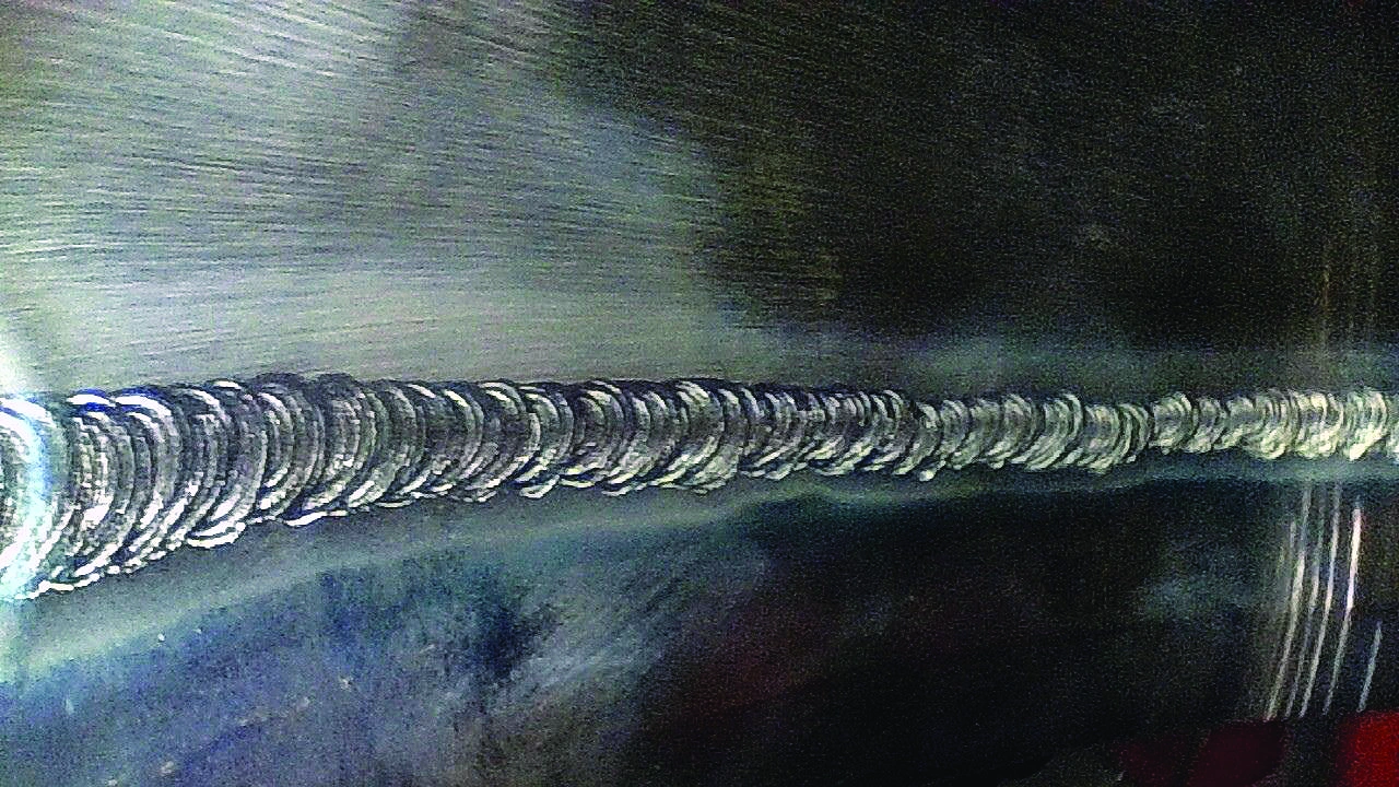

Lighting is the single most critical factor in borescope inspection. A common mistake is immediately cranking the lighting output to 100%. In a reflective welding environment, this causes “blooming” where the light bounces off the metal surface and blinds the camera sensor, washing out the details of the weld bead — Figs. 1 and 2.
  • Dial in the exposure. Use the brightness controls to find the optimal lighting level. Often, lower light allows the sensor to capture contrast better. When your target area is close — for instance, when inspecting a root pass in a small diameter tube — back the lights down.  Also, take advantage of modern borescope’s exposure control settings to reduce glare in tight or reflective areas.
  • Angle of incidence. If glare persists, slightly articulate the tip. Changing the camera angle relative to the weld surface by just a few degrees can often deflect glare away from the lens.
Fig. 2 — A borescope image showing adjusted lighting, avoiding blooming.

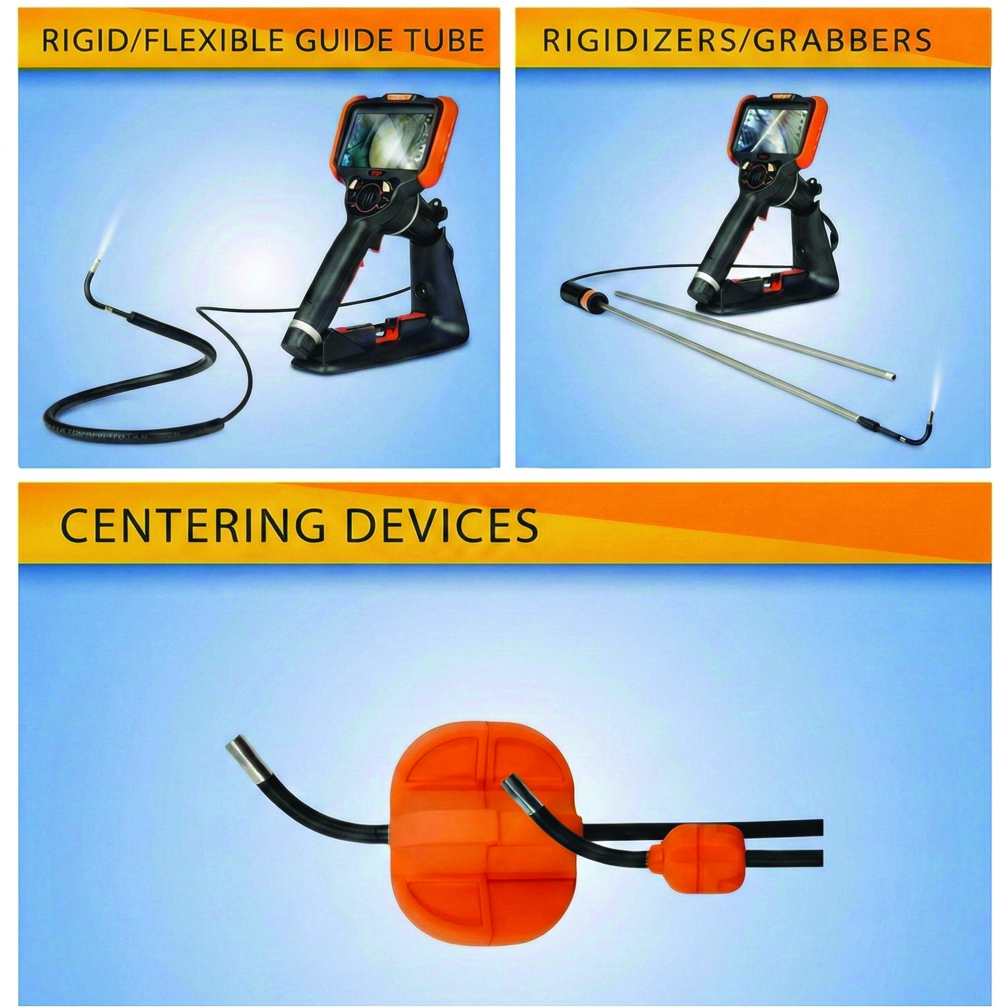

Borescopes do the heavy lifting during a weld inspection, but the right accessories can make the job easier. One accessory CWIs find helpful is the centering device — Fig. 3. This attachment for the insertion tube helps keep the scope centered in the pipe, providing a consistent view of the weld around the entire circumference. That means better lighting and fewer blind spots. It also helps protect the scope from rubbing against the wall.
Fig. 3 — Centering devices and other borescope accessories help position the borescope’s insertion tube, providing a steady and consistent look at the weld.
Other add-ons, such as stiff yet flexible guide tubing or rigidizers, can improve control during insertion. They add stiffness when you need it, making it easier to push through longer runs or tight areas without fighting the scope. These accessories are not mandatory for every job, but they are good tools to have if needed.

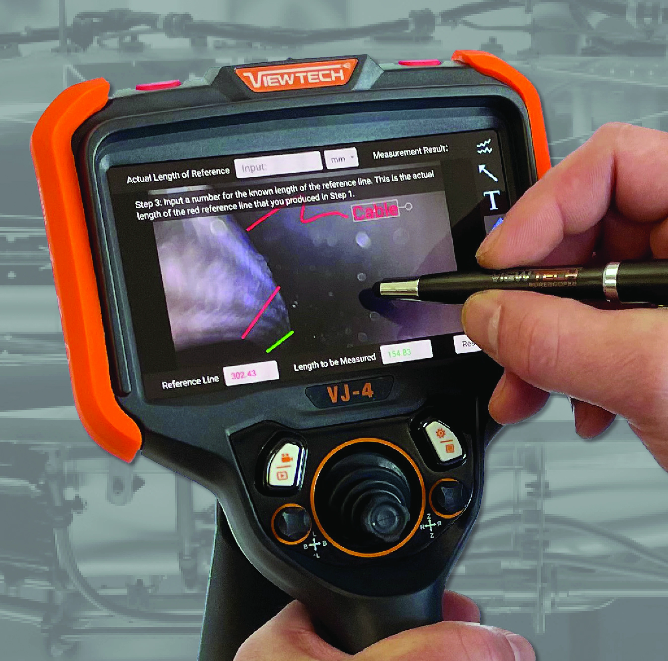

The last step of any inspection is the signed report. In the world of RVI, where the image is the data, visual evidence must be definitive.
Fig. 4 — Use your device’s text annotation tools to label images immediately, including date/time, weld number, quadrant or clock position, and viewing direction.
A close-up photo of a crack looks exactly like a close-up photo of a crack from a different inspection. Always use the text annotation features on your device to label images immediately — Fig. 4. Ensure the date and time stamp are active, and clearly identify the weld number, the specific quadrant or clock position, and the direction of the view. One more tip: Set up image folders before starting the inspection. A little prep work upfront keeps your files organized and makes inspecting and reporting more efficient.

Historically, sizing a defect via a borescope was a guessing game. Today, on-screen measurement technologies such as stereo and 3D measurement allow inspectors to quantify defects with high precision. While not every inspection requires this level of detail, these tools are invaluable for critical validation. If you spot a pore or an undercut that looks borderline, using these measurement tools can provide the data needed to accept or reject the weld based on specific code criteria (e.g., American Society of Mechanical Engineers [ASME] B31.3, Process Piping). Even if you don’t use advanced measurement, having a reference object of known size in the frame can help in estimating the scale of the flaw.

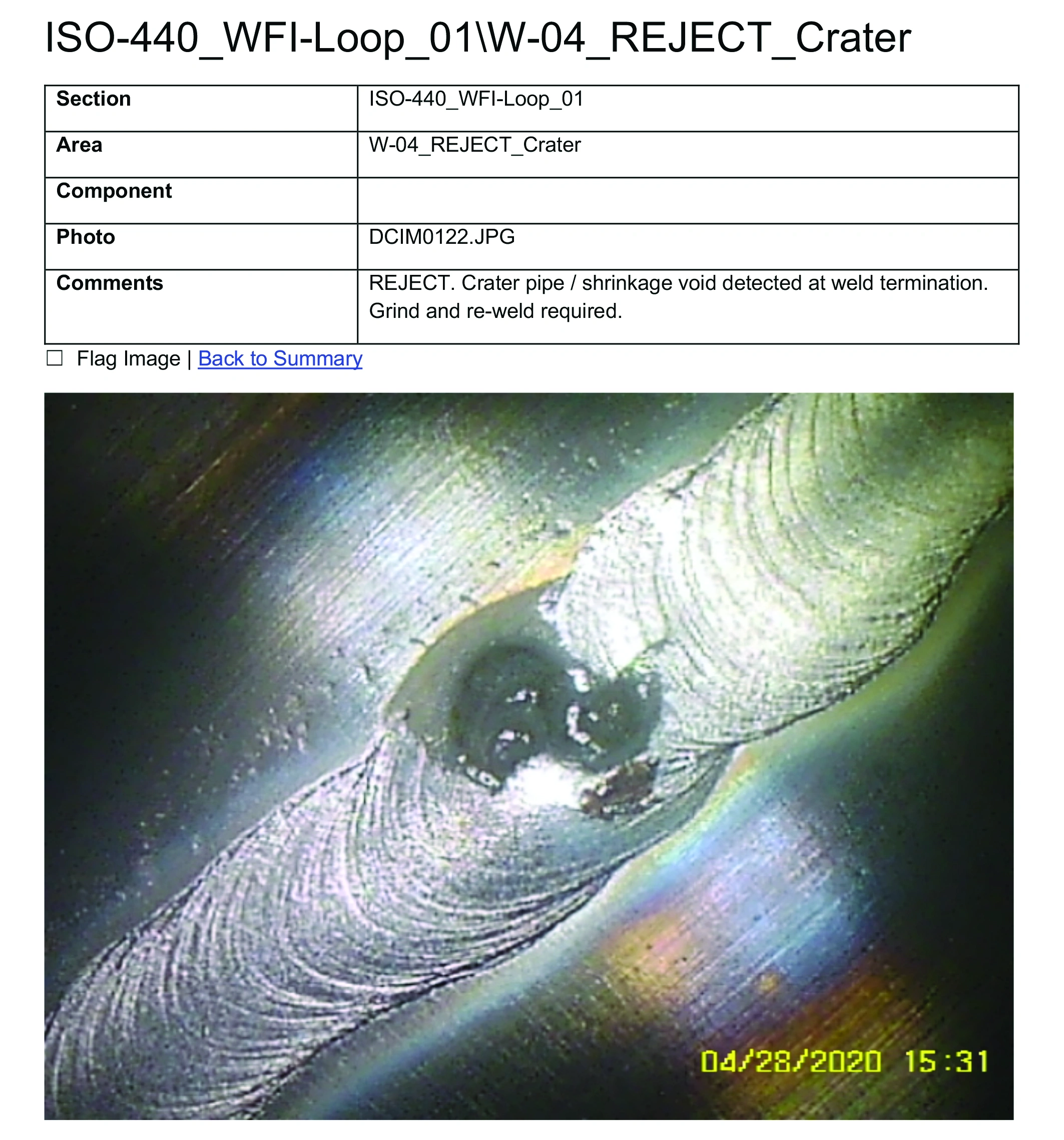

A disorganized folder of JPEGs can quickly become a reporting nightmare. Many borescopes now offer inspection reporting software designed to automate code-compliant reports with a few clicks, no more clicking and dragging — Fig. 5. Look for solutions that let you flag images and add comments, such as International Organization for Standards (ISO) or ASME codes. This not only speeds up turnover packages but ensures your data is consistent, searchable, and professional.
Fig. 5 — Inspection report excerpt generated using ViewTech’s borescope inspection Report Maker pairs high-resolution borescope imagery with precise defect location data and corrective action notes, to support clear inspection documentation.
