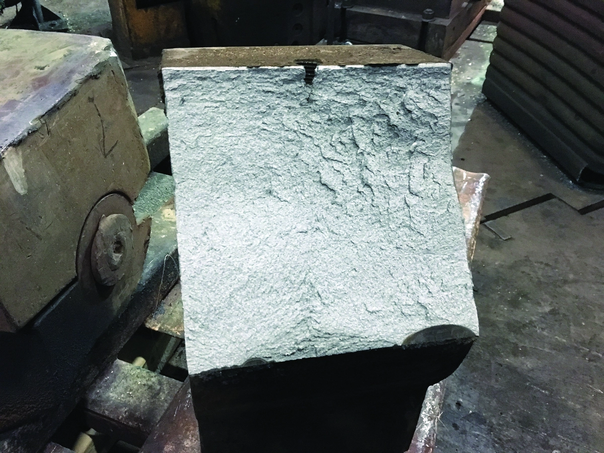

Fig. 1 — Fracture through the part.

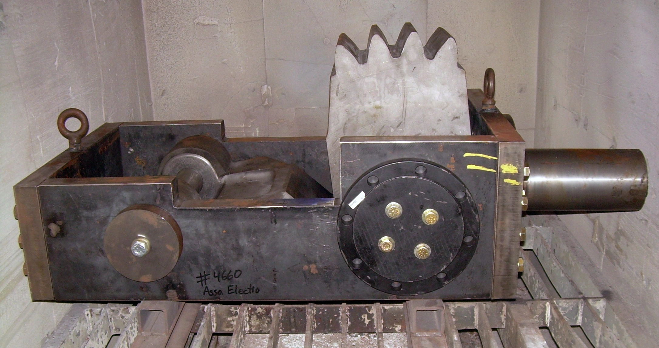

Next, we needed to examine the component that needs repair. This repair involved a component weighing around two tons. It was a machined forging with integral gear teeth that engaged another gear that opened and closed the jaws of a very large pair of tongs that gripped large chunks of steel weighing up to several tons. The tongs pick up and move large, heavy pieces of metal to a furnace that heats them to high temperatures, then move the hot metal to a forge where it is pounded into shape. The cross section of the part where the fracture was located was about 14 in. wide by 18 in. thick. Figure 1 shows the cross section through the fracture. The failure may have initiated in a couple of locations, but the fracture appeared brittle, with no visible deformation.
In preparation for welding, the fracture surfaces were machined to form a double U-groove. About 1 in. of the fracture was not machined to leave sufficient root face to facilitate fit-up and alignment of the two broken pieces. To maintain alignment and critical dimensions, a fixture was fabricated to hold the two pieces Fig. 2.

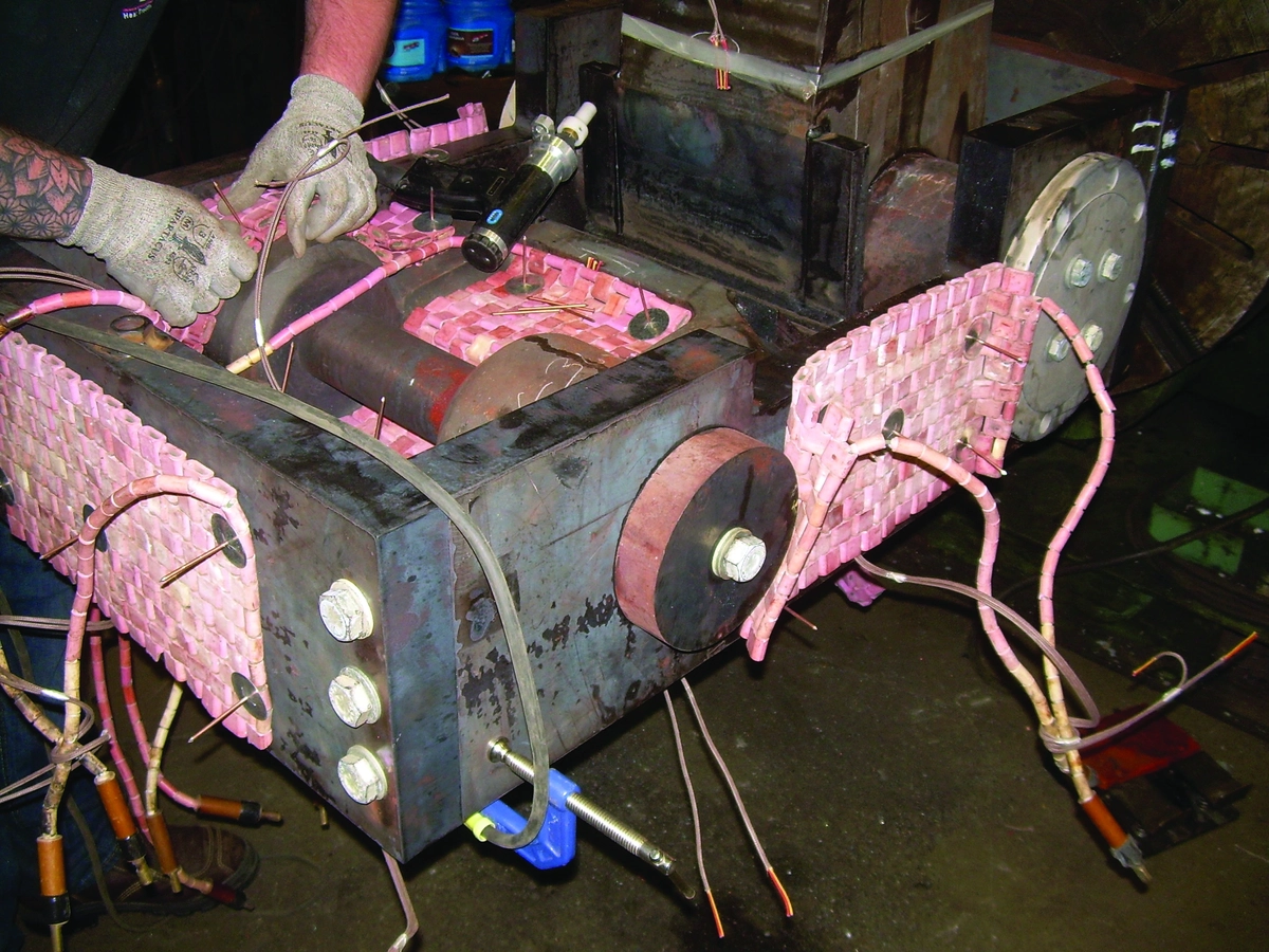

Fig. 2 — Shown are the two halves of the broken component in a fixture that holds the proper alignment and provides access for welding. That broken component stayed in the fixture until the repair was completed.
Figure 3 shows the part being placed in the fixture; notice the relative size of the workers and the component.

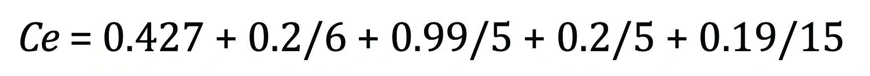

Now that we have addressed the mechanics of the repair, how was the preheat temperature determined? We performed the chemical analysis, so I knew exactly what the chemistry was. Now it is time to put that information to use.
The chemistry was determined to be as follows:
Carbon – 0.43%, Chrome – 0.99%, Manganese – 0.2%, Molybdenum – 0.2%, and Nickel – 0.19%. The balance was Fe.

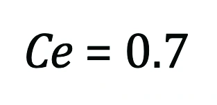

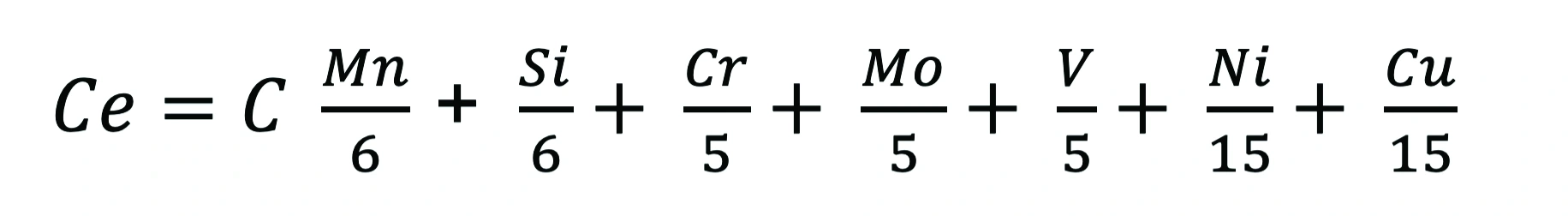

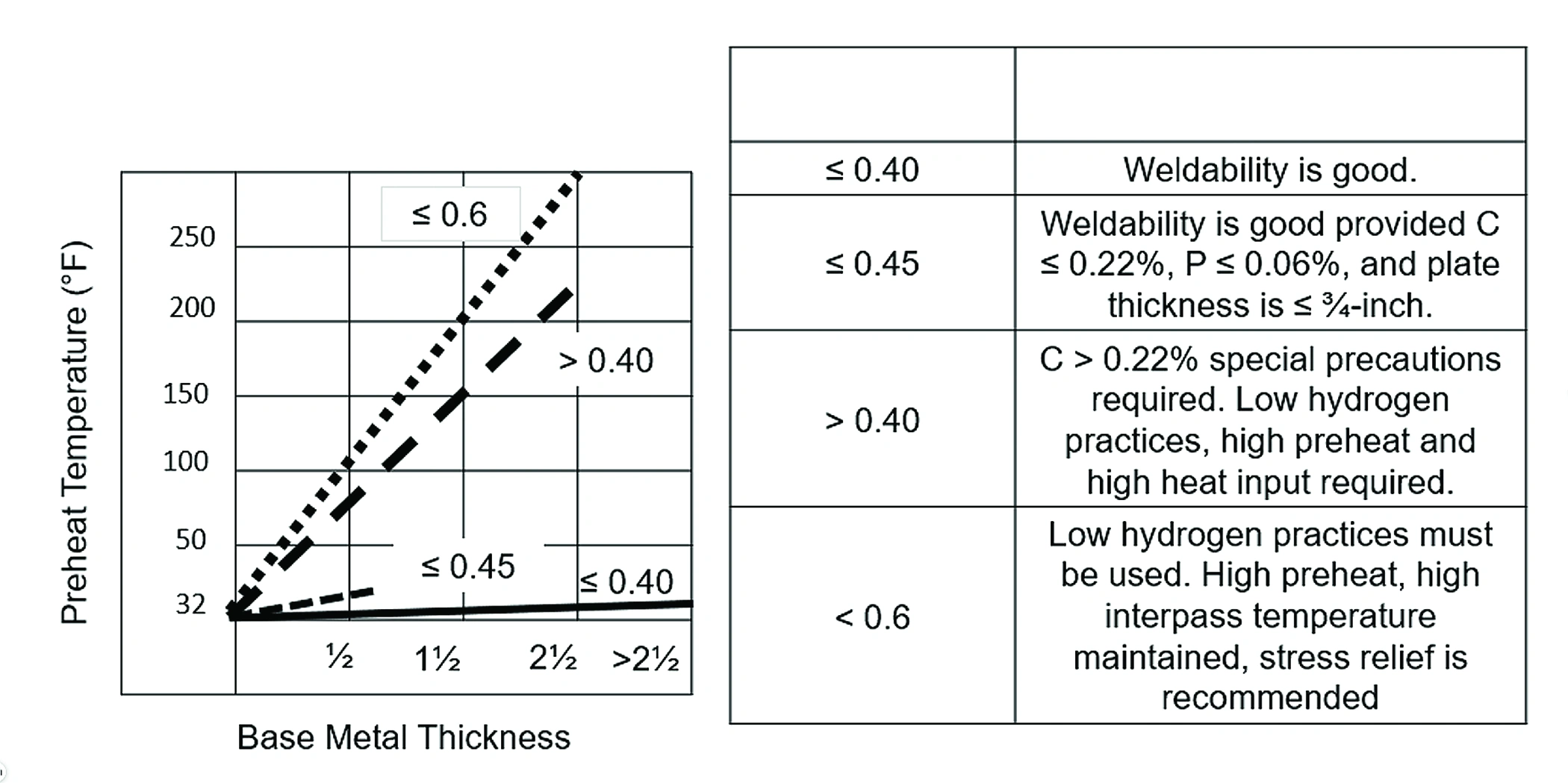

The chemistry is similar to that of American Iron and Steel Institute (AISI) 4140 steel. When those values reported by the laboratory are plugged into the carbon equivalent formula typically included in AWS, American Society for Testing Materials (ASTM), and American Society of Mechanical Engineers (ASME) standards (see Fig. 4), the calculated value was 0.7. That is “off the scale” or, simply stated, the carbon equivalent formula isn’t reliable for the alloy that had to be welded.
Fig. 4 — The carbon equivalent formula typically used for a low-carbon steel was not appropriate for the alloy that needed to be repaired. A different approach was needed.

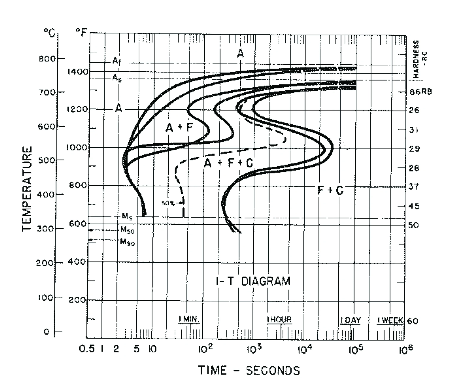

A different approach was needed to determine the preheat temperature required to weld this particular alloy. The solution I’ve used for many years has been to use an isothermal transformation diagram (available from the American Society for Materials) for the alloy system I need to weld.
Fig. 5 — Isothermal transformation diagram for AISI 4140 alloy steel. The line near the top, identified as Af, is the temperature at which the microstructure is fully austenitic. The line toward the lower half of the graph, identified as Ms, is the temperature at which austenite begins to decay into martensite. (Credit: ASM International, Atlas of Time-Temperature Diagrams for Iron and Steels.)
Figure 5 is the isothermal transformation diagram for AISI 4140 published by the American Society for Metals (ASM), which includes several important features I would like to point out. The line labeled Af is the temperature at which the steel is fully austenitized; i.e., it is the temperature necessary to ensure that all the steel is in the face-centered cubic condition, and, if held for sufficient time, all the alloying constituents will go into solution. The iron is the solvent; the alloying elements are the solute. The process of transforming from body-centered cubic to face-centered cubic begins when the temperature reaches As. The transformation to austenite is complete once the steel is heated to the austenite finish temperature, Af.
Three horizontal lines at the bottom of the diagram are labeled Ms, M50, and M90. Upon cooling from the austenitizing temperature, Ms is the temperature where the retained austenite starts to decay into martensite, M50 is the temperature at which 50% of the retained austenite has decayed into martensite, and M90 is the temperature where 90% of the retained austenite has decayed into martensite. The material is considered to be fully hardened.
When austenite decays into martensite, the crystalline structure becomes body-centered tetragonal, instead of being body-centered cubic, as is the case for ferrite. Martensite is shaped like a shoebox; that is, the cubic shape is elongated like a shoebox to accommodate the extra carbon. This happens while the metal is in the solid state, so it has to deform under high stress. As the atoms’ crystalline arrangement changes, it becomes susceptible to cracking. The trick is to ensure the parts being welded are hot enough to prevent retained austenite from decaying into martensite.
There’s more to be discovered if the isothermal transformation diagram for 4140 is studied. Let’s assume a preheat of 800°F is used. If one follows a horizontal line from 800°F on the left axis and traces a straight horizontal line toward the right axis, we see the austenite begins to decay into ferrite and cementite after a lapse time of about three seconds. After a lapse of 100 minutes, all the austenite has decayed into ferrite and cementite; i.e., there is little to no retained austenite left to decay into martensite upon cooling below 650ºF, thus a hard, brittle microstructure and crack-inducing strain are avoided.

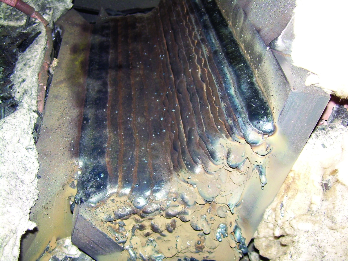

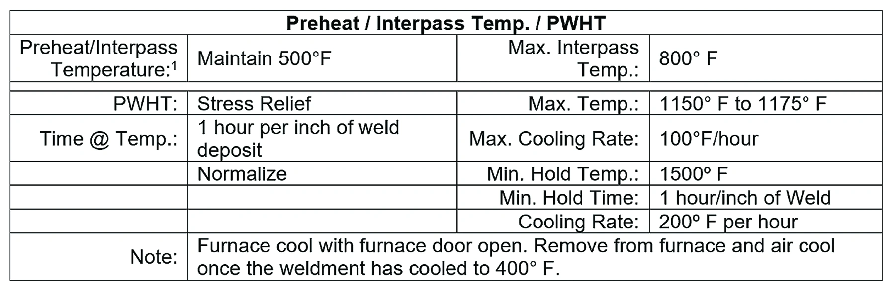

Fig. 6 — Excerpt from the WPS used for the repair of the 4140 low-alloy steel forging, identifying the in-process stress relief and consisting of normalizing.
Figure 6, extracted from the Welding Procedure Specification (WPS), indicates that the specified preheat temperature is 700°F. This is slightly above the Ms temperature of 650°F. The high preheat/interpass temperature ensures Martensite does not form while welding is underway. Both the fixture and the welded-repaired pieces were heated in an oven and wrapped in blankets to maintain the preheat temperature while the parts were positioned on the welding positioner and readied for welding.

Electric resistance heating blankets were used to prevent the welds and base metal from cooling below 700°F during welding. The parts were initially welded from one side until a sufficient weld deposited to hold the pieces securely in position. Then the second side was back gouged to sound metal. Once the back gouge was completed, continuous-current dry-particle magnetic particle testing was performed to verify that the back gouge depth was sufficient to remove any compromised base metal and the entire crack. The second side was then welded until a total of three inches of weld was deposited.
The assembly, including the fixture, was transported to the heat-treating facility for an in-process stress-relief operation. The WPS indicates the temperature for in-process stress relief was 1150° to 1175°F for roughly three hours, based on the thickness of the deposited weld. The weldment was wrapped in insulating blankets during transport to and from the heat-treat facility.
Then it was back into the welding positioner, and a check was made to verify the interpass temperature was at least 700°F before welding resumed. The fixture holding the parts was turned side to side while welding to ensure the residual forces on both sides of the butt joint were balanced and maintained proper alignment. Another in-process stress relief was performed once another

The selection of filler metal was uncomplicated because the choices were very limited. A filler metal that produced a low-hydrogen deposit and a close match in properties between the base metal and the filler metal after thermal stress relief was available from one supplier. The flux-cored electrode chosen met AWS A5.29, E101T2-GM-H4. The tradename of the flux-cored electrode was Dual Shield II 4130 SR, with shielding gas composed of 75% argon and 25% carbon dioxide.
The fixture was fitted with electric resistance heaters to ensure the preheat and interpass temperature was maintained during the multiple cycles of welding and thermal stress relief.

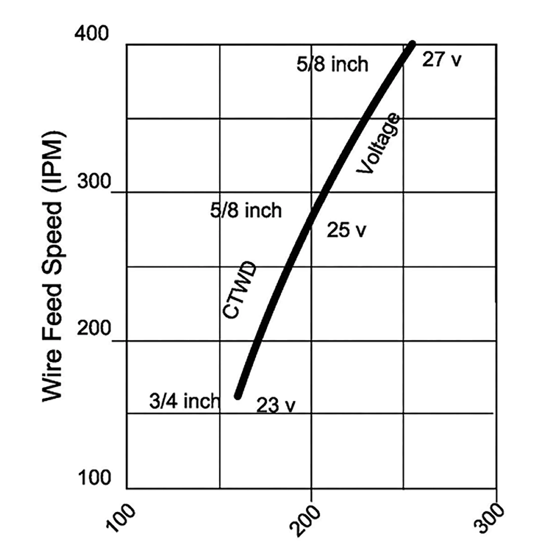

The WPS presented the welding parameters as a graph showing the permitted ranges for wire feed speed, arc voltage, contact tip-to-work distance (CTWD), and amperage. Because the flux cored arc welding process uses a constant-voltage power supply, the arc voltage remains essentially constant once set by the welder. Likewise, once set, the wire feed speed is a constant unless the welder changes it. The CTWD is a constant as long as the welder visually monitors the distance from the end of the contact tip to the surface of the weld pool. This isn’t usually a problem when the welder understands that changing the CTWD profoundly affects the amperage.
Fig. 7 — Graphic presentation for the welding parameters used with 0.045-in.-diameter Dual Shield II 4130 SR.
Reputable electrode manufacturers provide recommended ranges for welding parameters on their websites. The parameters are usually presented in a tabular format;
I convert the parameters into a graph that is easier for the welder to use. I’ve yet to have a welder complain about the presentation. The graphic included by the WPS is for this specific flux cored electrode is depicted in Fig. 7.
