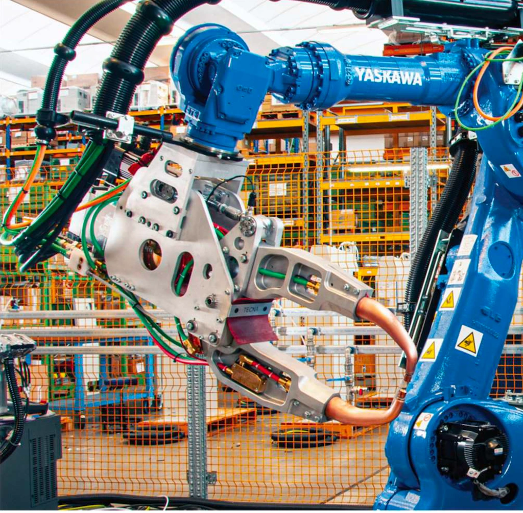

The gun body determines the force and mechanical features of the robot gun. It is important to have a clear picture of the application to select the optimal type of gun body for the job.
1. Gun Body
The body of a robot spot welding gun serves as the structural backbone, holding the actuator, transformer, robot coupling, and arms together. Ensuring rigidity is crucial to maintain control over the welding process, as force needs to be transmitted consistently from the actuator to the welding caps. Additionally, a lightweight design is key to improving robotic efficiency. For instance, a lighter gun enables the choice of a lighter, faster robot, enhancing the overall productivity of the system and reducing floor space. Guns under 176 lb are typically considered a good lightweight, and some manufacturers have gone further, reducing weight to under 143 lb on the new lightweight models, without compromising on strength.

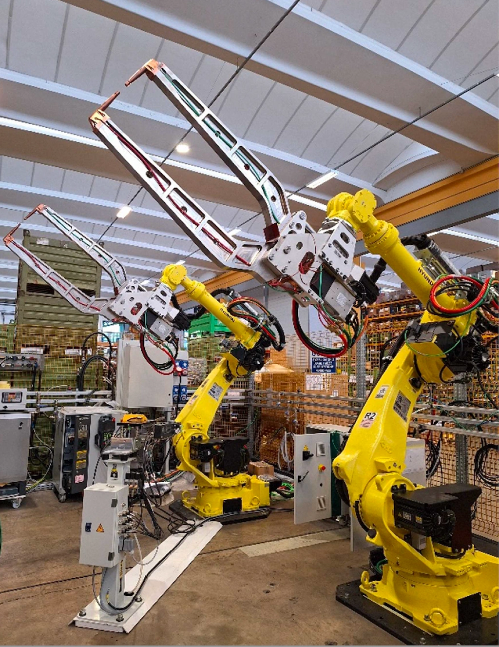

The inline actuator flexibility is one of the strongest added values, which enhances the core concept of this article, making the modern robot gun a true universal tool.

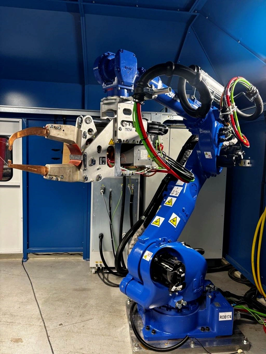

Another example of a spot welding robot cell, with custom arms and TECNA's universal configuration of an inline actuator.
