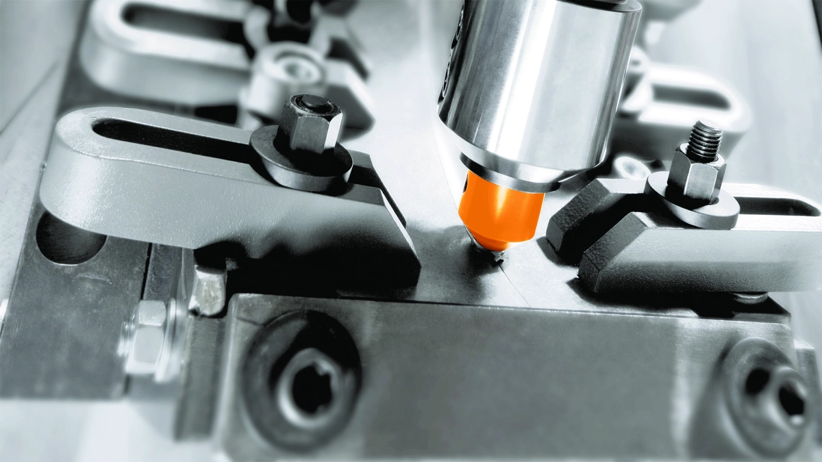

Pin delivering high-strength, low-distortion welds for advanced manufacturing FSW applications. (Credit: KUKA.)
