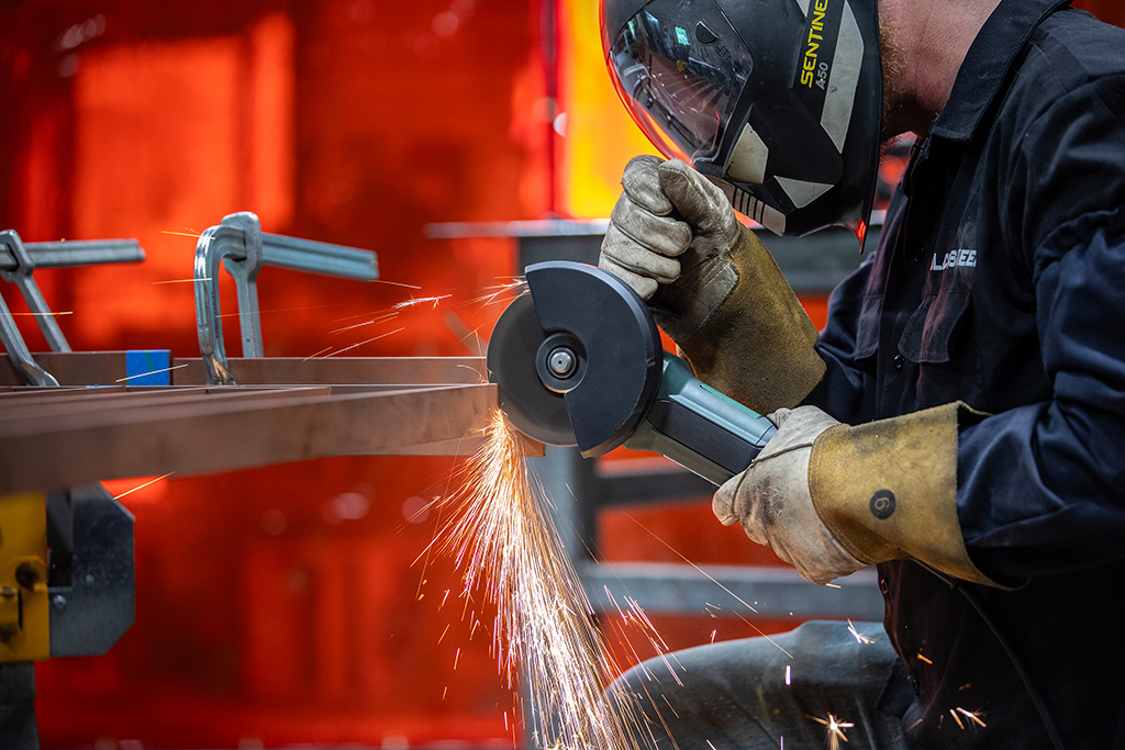

WD-July-2025-Cutting-Wheels-Lead-Fig 1
Working with an abrasives expert to conduct a complete evaluation of your cutting operation can help determine priorities and uncover useful date.

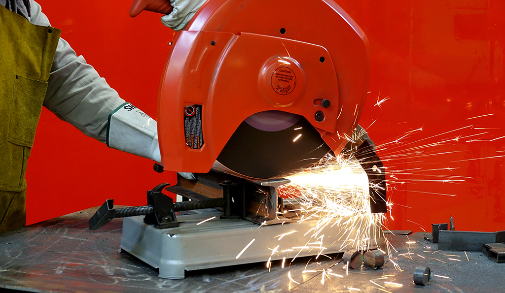

WD-July-2025-Cutting-Wheels-Lead-Fig 2
Wheel diameter is one of the factors to consider when choose an appropriate cutting wheel. In the United States, 4.5- and 6-in. wheels are the most popular sizes used on right-angle grinding tools.
