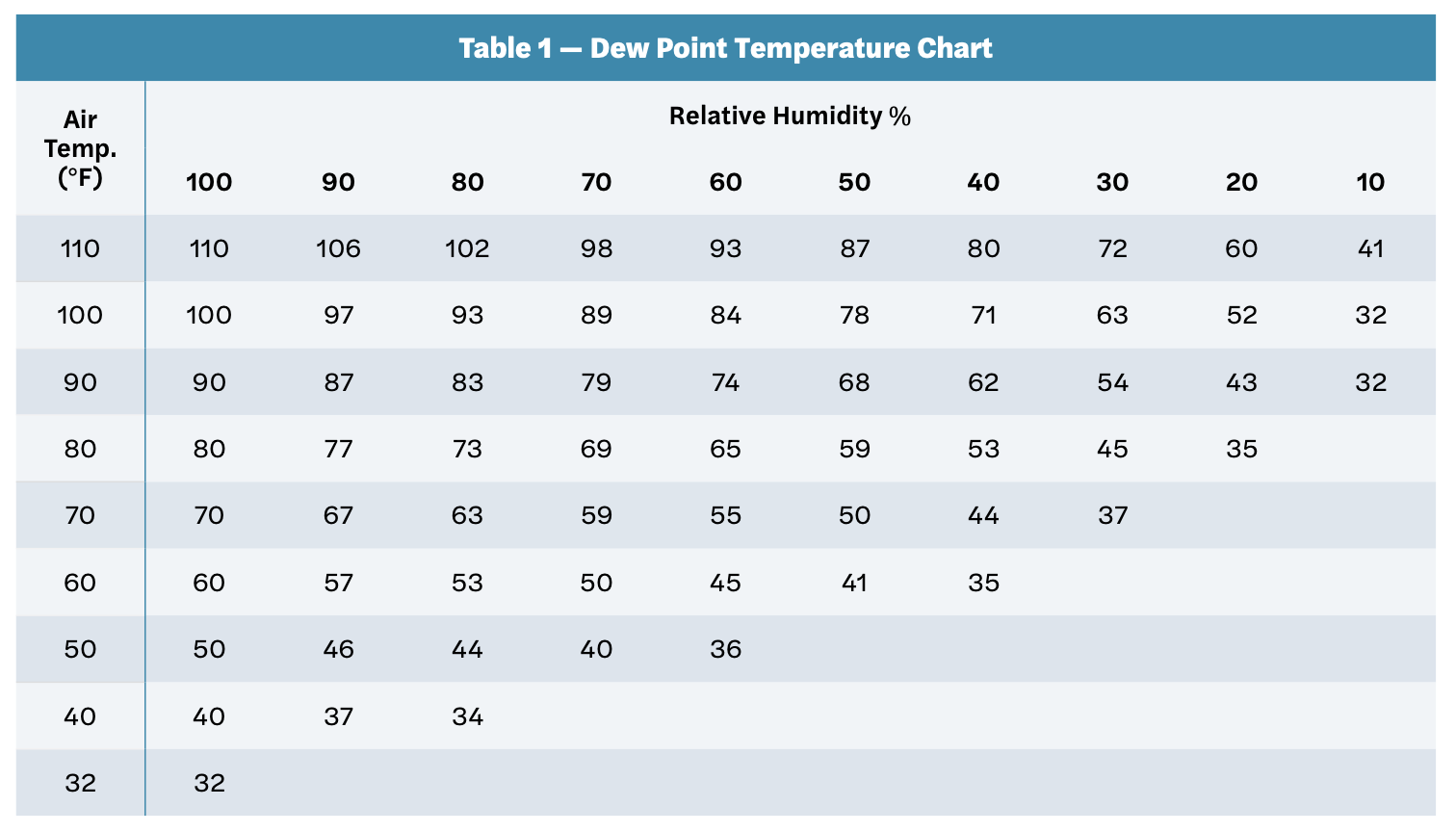

Wires should be stored in a dry, enclosed environment and, preferably, at a constant temperature with minimal fluctuations to prevent them from cycling through dew points. If the filler metal is moved from colder to warmer environments, it must be allowed to stabilize thermally in the welding environment for at least 24 hours prior to welding. If not acclimated, condensation can form directly on the wire, creating hydrated oxide on exposed surfaces and causing weld discontinuities. To assist customers in navigating this potential issue, dew point charts are available to help determine when condensation may form on filler metal (see Table 1). If the filler metal temperature falls below the dew point, as indicated by the intersection of the welding environment’s air temperature and relative humidity, condensation will occur. This can lead to weld discontinuities and quality issues. Proper storage and handling are essential to prevent moisture-related defects.
