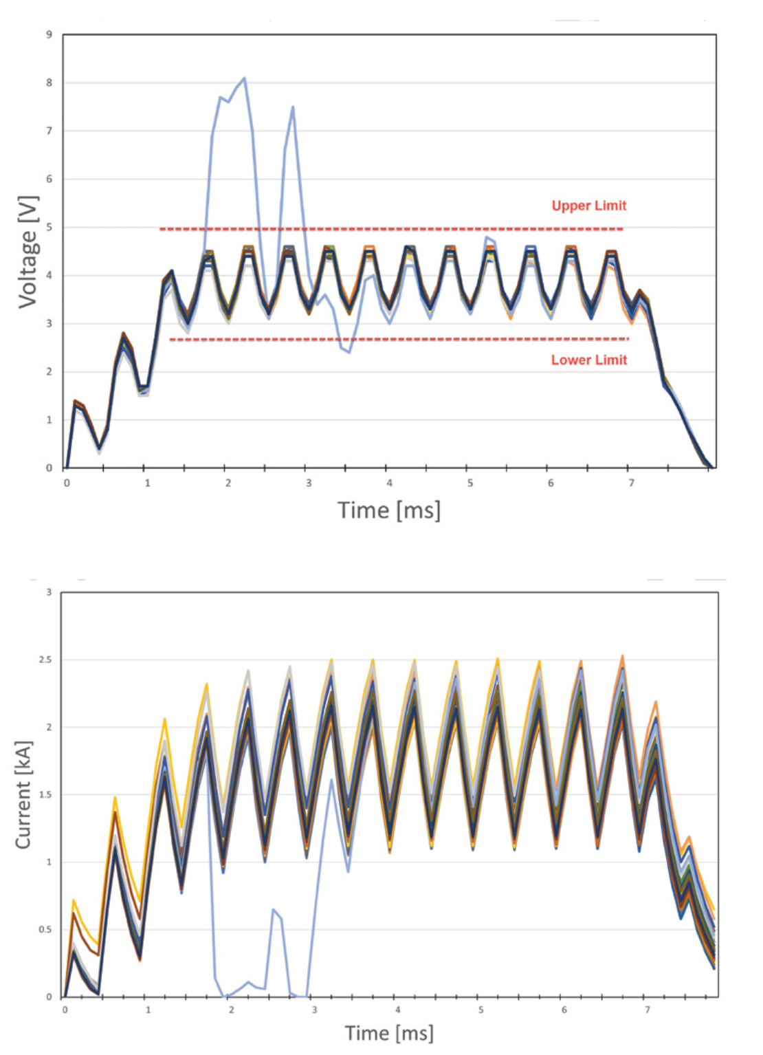

A customer reported welds exhibiting occasional weakness. A monitor was attached to the machine, and numerical weld data was charted. One weld revealed a voltage spike above the process limits, which also correlated with a dip in current — Fig. 1.
Fig. 1 — (Top) Voltage waveforms for multiple measurements. One waveform (blue) exceeded the upper and lower limit lines (red dashed lines), indicating a weld that fell outside the expected range. (Bottom) Corresponding current waveforms. One waveform (blue) dropped to zero for about 1 millisecond. This correlated to the observed cold, weak welds of the part.
Although the numeric data indicated an anomaly, it didn’t explain why. Waveform analysis revealed the current dropped to zero during part of the weld pulse, reducing effective weld time by about 20%. This corresponded with reports of cold welds.
Examining voltage waveforms across 30 welds showed all were stable except the one outlier, where the power supply maxed out trying to compensate for an open circuit. This ruled out part or equipment issues, pointing instead to an intermittent electrical connection.
This case demonstrates how waveform monitoring adds diagnostic depth beyond what numeric data alone can provide, allowing the identification of root causes in real time.

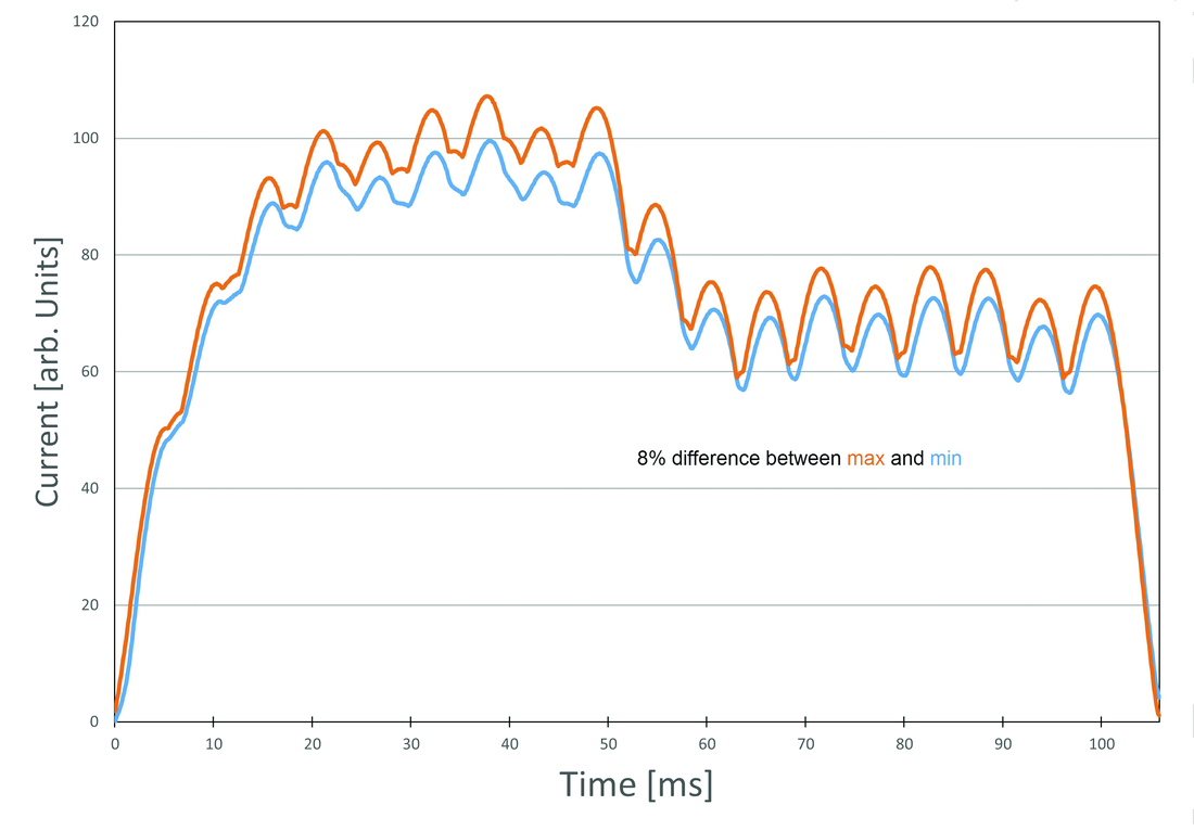

This example focused on the consistency of a direct current power supply’s current output — a key performance factor in resistance welding. Twelve consecutive weld pulses were overlaid, and waveform stacking showed noticeable variation once the minimum and maximum were isolated — Fig. 2.
WJ July 25 - Feature 02-Boyle-Amada - Figure 2.tif
Fig. 2 — Maximum and minimum measured waveforms of current. The curves show a variation of up to 8% and correlate to variations in the weld success rate.
When the highest and lowest current pulses were compared, an 8% difference was found. This is significant because welding heat is proportional to the square of the current. Even small differences can lead to major quality variations.
Although summary data may not reveal such fluctuations, waveform analysis clearly showed the issue, enabling corrective actions to improve weld consistency.

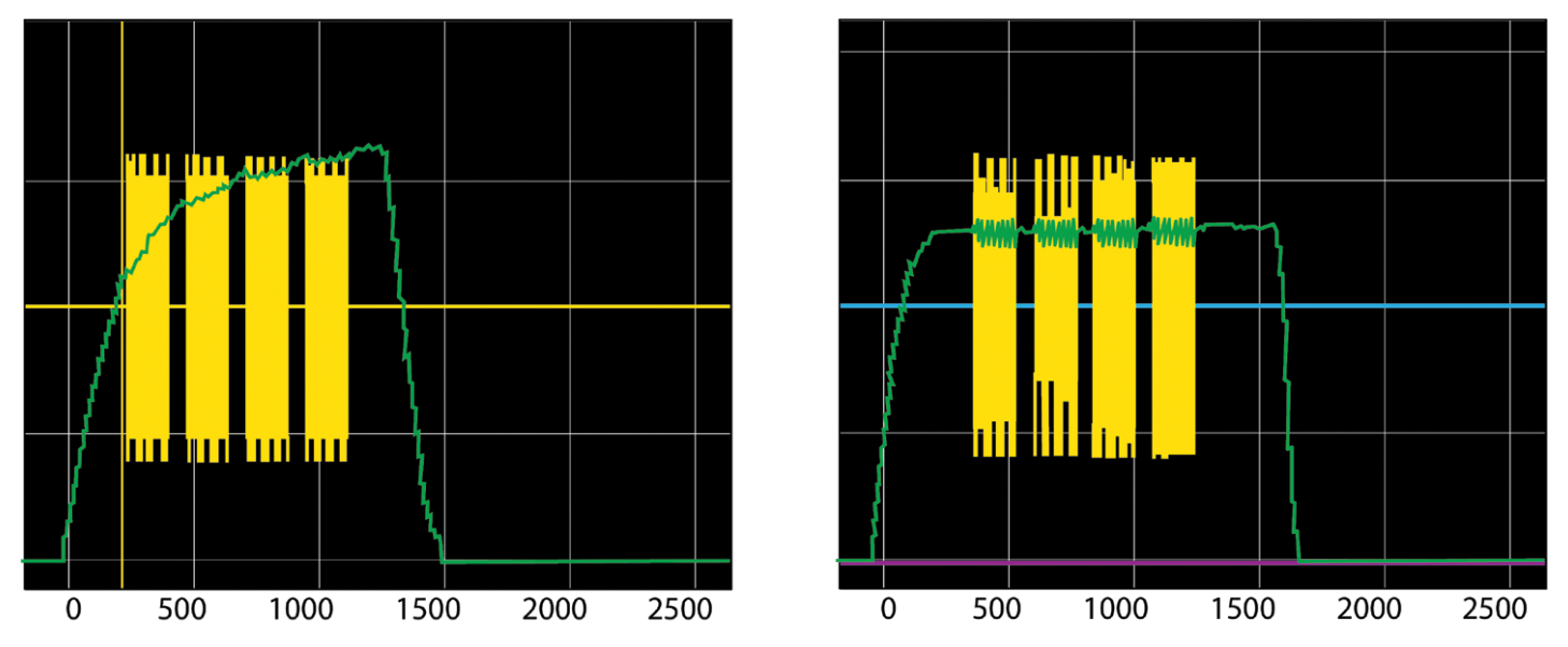

Sparking during welding indicates energy loss and poor weld quality. It can occur due to several factors, including material alloy, plating, and inadequate force.
In this case, a weld-through sensor was used to track both current (yellow) and force (green) waveforms — Fig. 3. The chart revealed that current was applied before force stabilized, about 40% below target, resulting in sparking and inconsistent welds.
Fig. 3 — (Left) Measured waveforms of current (yellow) and force (green). The current started before the force reached maximum and equilibrium, leading to sparking. (Right) Measured waveforms of current (yellow) and force (green) after resuming the force-fired feature of the weld head. Resultant welds were successful.
The issue stemmed from a change in the weld head’s force-fired trigger settings. Instead of initiating the weld pulse based on force threshold, a 250-millisecond timer was used to speed up production. This caused the weld to start before sufficient force was applied. By reenabling the force-fired feature and resolving the cause for slow force generation, the system ensured the pulse would only begin after the target force was reached.
Once the trigger was corrected, sparking stopped and weld consistency returned. This case highlights the power of visualizing process parameters to identify and fix dynamic timing problems in real time.
