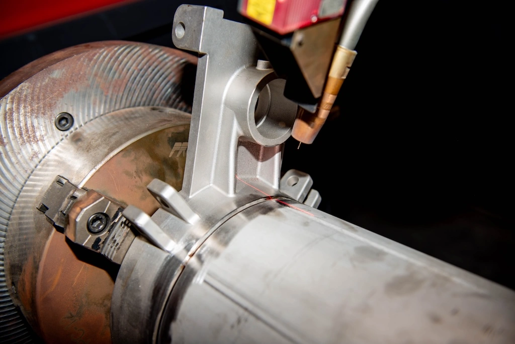

WD Jan 2026 - Robotic Welding Propels Filtration Systems into a New Era of Efficiency - Photo 3.webp
Stainless pipe being measured by the machine.
 The decision to select the Arcmate 120iD was based on its manufacturer’s track record in industrial robotic welding. The product is ideal for repetitive welds that demand control over positioning and torch angles, especially on cylindrical or curved stainless steel parts. Paired with the TPS 400i, the system becomes more powerful. Together, the units enable the company to maintain the tight tolerances required by ASME Section IX of the Boiler and Pressure Vessel Code and AWS D1.6, Structural Welding Code — Stainless Steel

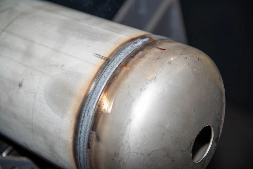

WD Jan 2026 - Robotic Welding Propels Filtration Systems into a New Era of Efficiency - Photo 4.webp
Stainless pipe after being welded.

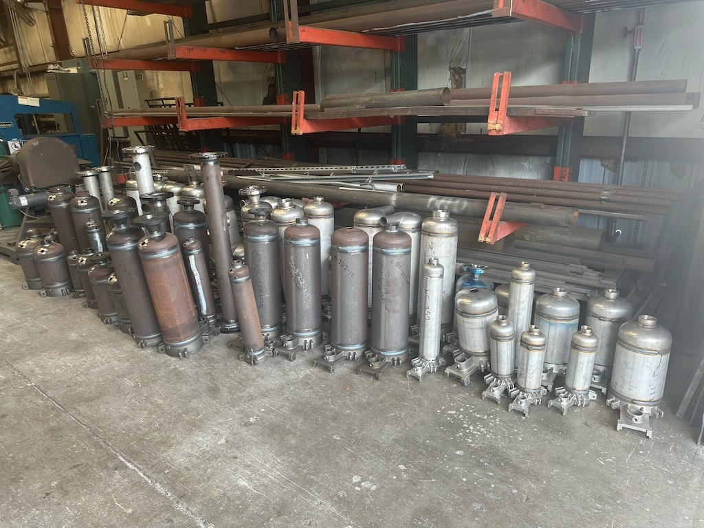

WD Jan 2026 - Robotic Welding Propels Filtration Systems into a New Era of Efficiency - Photo 5.webp
The finished product.
This strategy has paid off. While competitors scramble during global supply chain disruptions, the company continues to ship quickly, even fulfilling last-minute or emergency orders without delay.

WD Jan 2026 - Robotic Welding Propels Filtration Systems into a New Era of Efficiency - Photo 6.webp
Assorted tanks ready for finishing.
