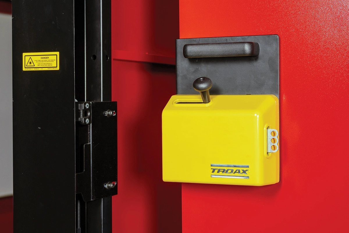

A safety interlock door latch.

  5. Designate a laser-controlled area (LCA) or otherwise enclose the handheld laser workspace in a booth/box/surround. Identify the specific physical parameters of your LCA and ensure they are clearly marked and visible to the operator(s) and other personnel.
    The LCA should be an enclosure with noncombustible laser-blocking panels, an access door with an interlock switch, and a “Laser On” visible or audible warning indicator. Any barriers or windows used should be made of laser-rated material that can withstand direct and reflected beams. Aluminum and steel are effective, but ensure they are correctly rated for your specific laser application. Mirrorlike and reflective surfaces are undesirable in the LCA and must be excluded from the beam path.
