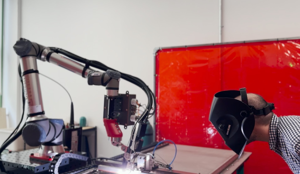

Caren Dripke, head of robotics development at Lorch Schweißtechnik GmbH, compares AI-enabled welding cobots to having an apprentice with you when you’re welding.
“It's like having an apprentice, and it's not his very first day on the job, but rather, he has seen a couple of things. And you only need to point out the general description of the job, and the apprentice can figure the rest out by himself,” said Dripke.

Hirebotics’ AI-powered Beacon software provides suggestions designed to guide end users of all experience levels through the automated welding setup process.
“It's like having a copilot,” said Zach Boyd, CTO at Hirebotics. “For first-time users of automation, it really helps to get them over that initial hurdle. The welders are still in control, but certain things are simplified so they can focus on more of the craft, while the cobot focuses on the more monotonous tasks.”
Leveraging AI to optimize parameters such as voltage, wire feed speed, and travel speed, the system uses contextual data to suggest settings tailored to the specific application and material.
The suggestions Beacon provides are not drawn from a limited list of pre-determined weld settings and recipes, but from hundreds of real-world deployments of cobots that have been analyzed by AI. Moreover, if end users encounter a problem, they can take a picture of the welding cell, and Beacon will use AI to suggest fixes.
Where complex traditional programming requires users to think through multiple waypoints and input many details, AI-powered tools like SeamPilot remove much of this complexity, according to Lorch’s Dripke.
“You don't have to provide many input parameters. You don't have to set up all the torch angles. You don't have to provide every single waypoint. Rather, you just say, ‘Here are the parameters, here's the seam [joint], please weld this.’ SeamPilot takes care of all the geometrical paths. That's a huge time saver, because waypoints usually take the most programming time, so you can easily weld right away,” explained Dripke.
