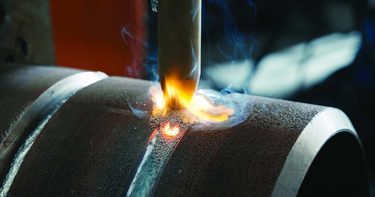

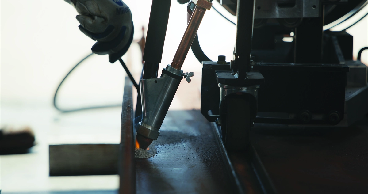

Productivity is important in many manufacturing and industrial welding applications, but maximizing throughput without sacrificing quality requires careful selection of the process, equipment, and consumables. Submerged arc welding (SAW) is a powerful process that can improve productivity, weld quality, and consistency for the right applications. This mechanized, wire-fed process submerges the arc beneath a layer of granular flux, which shields the weld from atmospheric contamination.

Metal cored wire is becoming increasingly popular in SAW due to its ability to boost productivity and adapt to a broader range of applications. One of its primary advantages is the significantly higher deposition rates it offers, allowing welders to lay down more weld metal per hour, even when using standard direct current welding machines, eliminating the need for costly alternating current-capable equipment. The broader joint penetration profile and enhanced sidewall fusion of metal cored wire make it especially effective for fillet welds, wide grooves, and situations where joint fitup is less than perfect, as metal cored wire can bridge gaps more effectively than solid wire.

- Workflow: Transitioning to metal cored wire is typically seamless, needing only minor adjustments to travel speed and wire-feed settings to maintain a given weld size. The increased deposition rates allow for faster travel speeds or decrease the number of passes to fill a joint, improving productivity.
