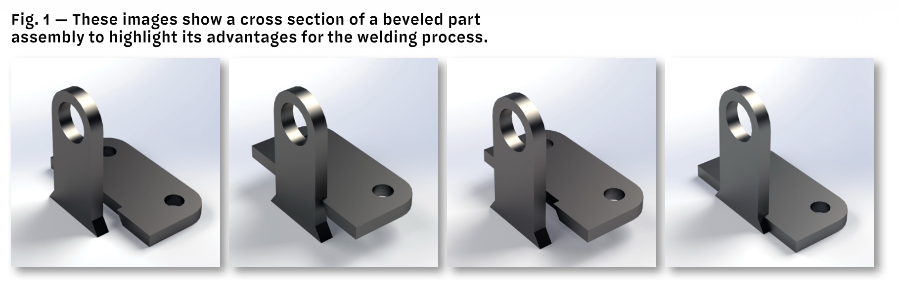

Now, let’s go back and reimagine the fillet weld. In the world of sheet metal, slotting and tabbing is a commonly used practice. The process allows a tab to be inserted into a slot, a round peg into a round hole, or whatever geometry the design requires. How can this design change help fillet welds? What if a slot is cut in the frame during the laser cutting process? Well, we can.
A laser-cut slot with two angular bevels, along with a tab or key inserted into the slot, will slide into position and self-locate, while the bevel allows the part to sit correctly. This allows the part to be held in place from underneath the top of the weld area, around the fillet weld location. The part and position are now correct, as required, and any clamps used are moved away from the welder or the robot while the weld is performed.
The main idea behind bevel cutting with the laser is to create a better fitup for the welder. A better fitup improves the welder’s torch angles, resulting in better accuracy and more uniform angles on the parts. One new idea for the bevel is to create slots and tabs, which allow the part to be trapped in place by the material itself, as well as by the weld — Fig. 1. This helps reduce failures, because we are using the material itself as a barrier against weld breakdown.

Returning to the eyelet example (Fig. 1), the diagram illustrates new design steps that show how the eyelet is held in position thanks to good design. This design, with integrated bevels, results in better positioning and better access for an easier weld. We can eliminate any clamps that would otherwise interfere with positioning.
