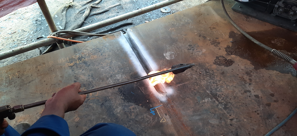

Preheating, maintaining interpass temperatures, and postheating, when needed, can consume considerable shop or field production time with costs for labor, fuel gases, and electricity. However, alternative methods for determining preheat requirements, when applied with today’s cleaner, lower-carbon steels and the use of H4 and H8 low-hydrogen filler metals, can easily achieve time and cost savings, as well as environmental benefits.

The alternative methods consider the actual welding conditions, including steel composition, filler metal diffusible hydrogen level, part thicknesses, and heat generated during welding. Preheat and interpass temperatures can be dramatically lower when running the numbers rather than relying on a table that conservatively assumes a worst-case scenario for composition, diffusible hydrogen, and other factors.
