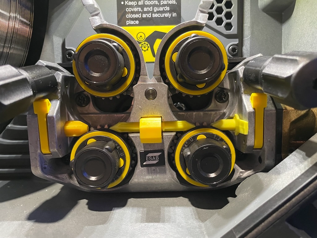

In a typical gas metal arc welding (GMAW) setup, there are multiple areas the wire must pass through to get to the arc. The wire feed speeds used when welding aluminum are often higher than those used for most steel wire setups. If there is a restriction in the feeding system, the result is generally a burnback (if the wire can’t feed properly and ends up melting to the end of the contact tip) and/or a bird’s nest (if the wire bends between the drive rolls and the outlet guide, it will build up in that small area).

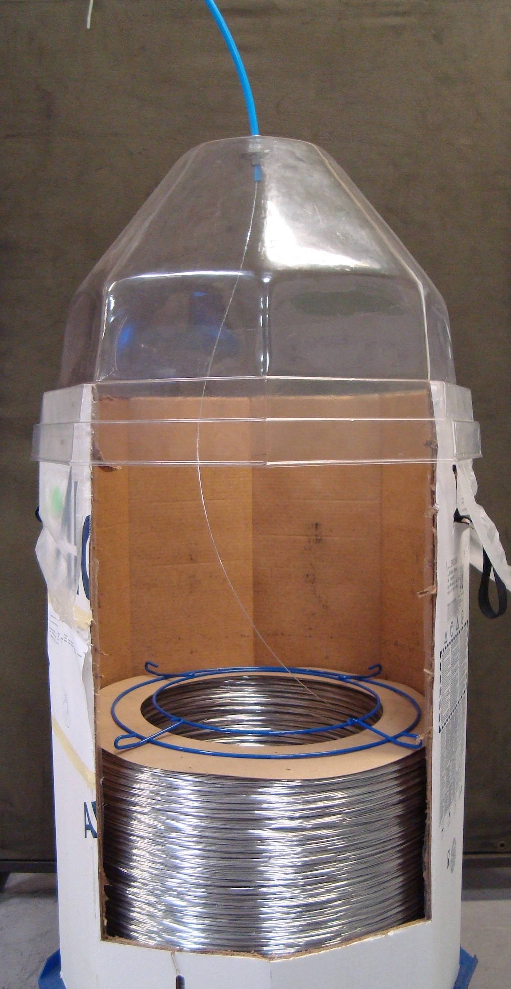

Wire Drums
Customers looking for a bulk wire option can use 50-lb mini drums or full-size drums that weigh 311 lb. Do not tip or shake the drums, and avoid dragging them by the straps. Also, never allow the drums to get wet. When moving drums, use a forklift, pallet jack, or a cart designed for drums. To lift drums, use a lifting yoke. Keep the drum in a warm, dry location and keep it closed until ready to use.
Setting up a drum for reliable, uninterrupted feeding requires special accessories, which are unique to either 4XXX or 5XXX series wires. Always follow the manufacturer’s recommendations.
The most common feeding issue with drum wire is tangles. Some of the usual suspects that cause them are as follows:
  • The drum was set up incorrectly
  • Worn conduit
  • Shifting wire during transport
  • Wire twist getting pushed back into the drum

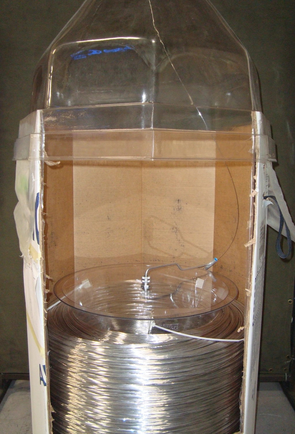

Wire Guides
When feeding aluminum, eliminate all areas where the wire is not supported or encapsulated. One way to understand the differences is to think of steel wire as rigid, uncooked spaghetti and aluminum wire as cooked spaghetti.
On most wire feeders, the wire passes through an inlet guide before reaching the drive rolls. First, the guide should be nonmetallic, as metal guides can scrape the wire and create shavings. Inspect the inlet guide; if it has worn a groove due to rubbing, replace it. Center guides (if present) and outlet guides should be tapered with a contour that matches the drive rolls, allowing their ends to be as close to the drive rolls as possible. Additionally, ensure there is no gap between the back of the torch liner and the exit end of the outlet guide.
Inlet, center, and outlet wire guides help ensure the wire has a precise and controlled path to the contact tip.
To prevent a bird’s nest like this when feeding aluminum, GMAW systems need an optimized setup.

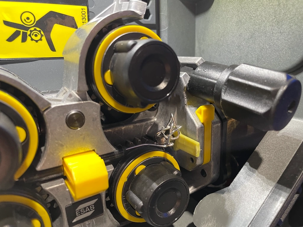

Drive Rolls
When using steel wires with a V-groove drive roll, opt for a U-groove drive roll for aluminum to prevent wire deformation and the creation of shavings.
Select a drive roll that matches the diameter of the wire. To evaluate quality, inspect the geometry of the grooves under magnification to ensure the grooves are smooth (a 10x eye loupe usually offers enough magnification).
How much drive roll pressure should be used for aluminum? There is no standard answer. The technique used for steel, where you feed the wire into an obstruction and increase pressure until it curls, is not usually recommended for aluminum because that much pressure can cause the soft wire to crush.
