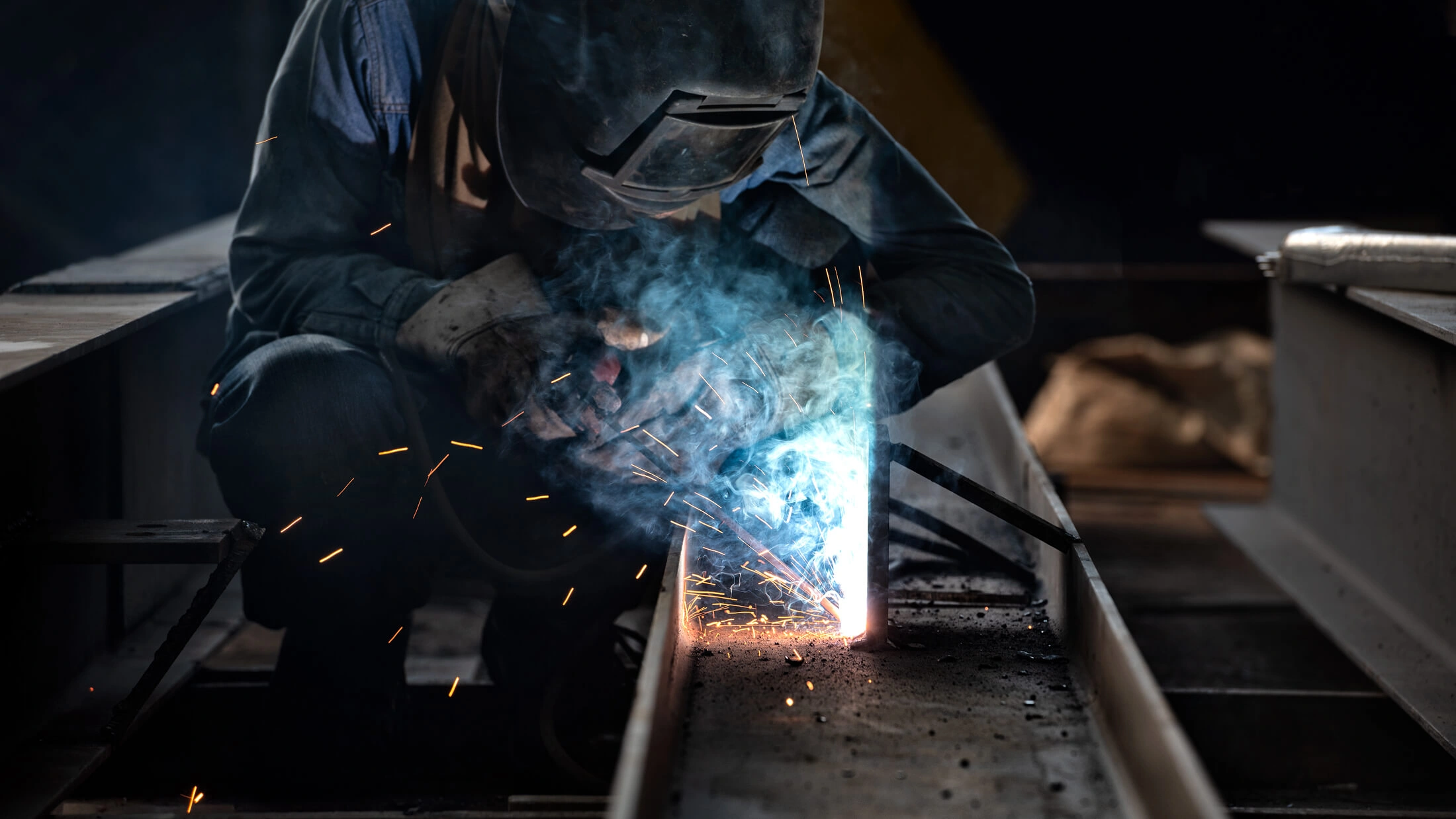

What Is FCAW?
FCAW uses a continuously fed tubular wire electrode filled with flux. This flux generates shielding gases and protective slag as the weld is formed, making it especially effective for heavy-duty, high-deposition applications.
There are two primary variations of FCAW:
  • Self-Shielded FCAW (FCAW-S): The flux within the wire creates its own shielding gas, allowing welding outdoors or in windy conditions without external gas cylinders.
  • Gas-Shielded FCAW (FCAW-G): Uses an external shielding gas in addition to the flux core for cleaner welds and less spatter, often preferred in fabrication shops.
Both methods provide strong, high-quality welds, and understanding which variation to use is essential for achieving the best results in different environments.
