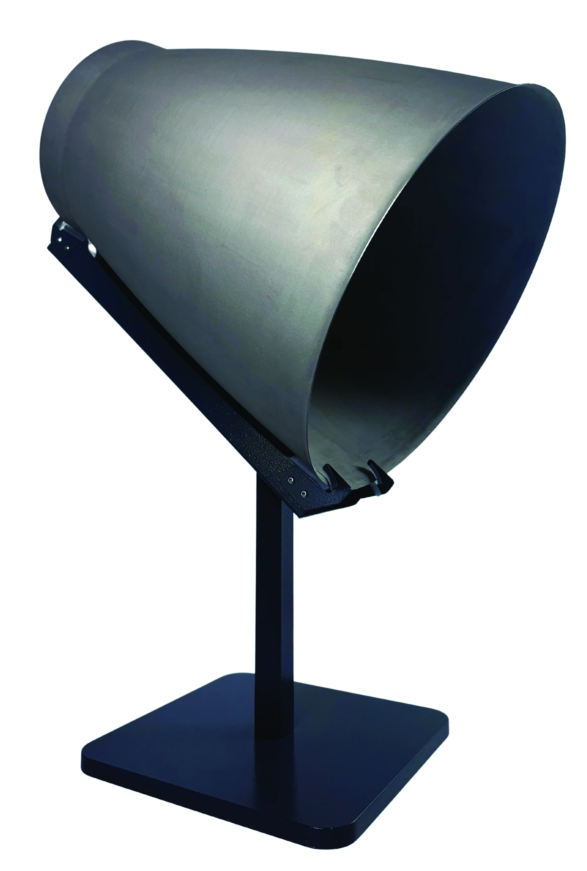

Powders must have precisely defined properties to enable cold spray to exploit its full potential. The process can powerfully demonstrate its benefits, particularly with metals such as tantalum and niobium, which have high melting points — Fig. 1. Both are so-called refractory metals, whose melting point exceeds 3000°C. They are corrosion resistant and temperature resistant and are, therefore, hard to process using conventional procedures. The cold spray system avoids these restrictions because the melting process is unnecessary. As a result, it is even possible to process challenging materials reliably and without a protective chamber.
Fig. 1 — The thruster shown was produced using cold spray with tantalum and niobium alloys, providing a solution that overcomes material limitations.

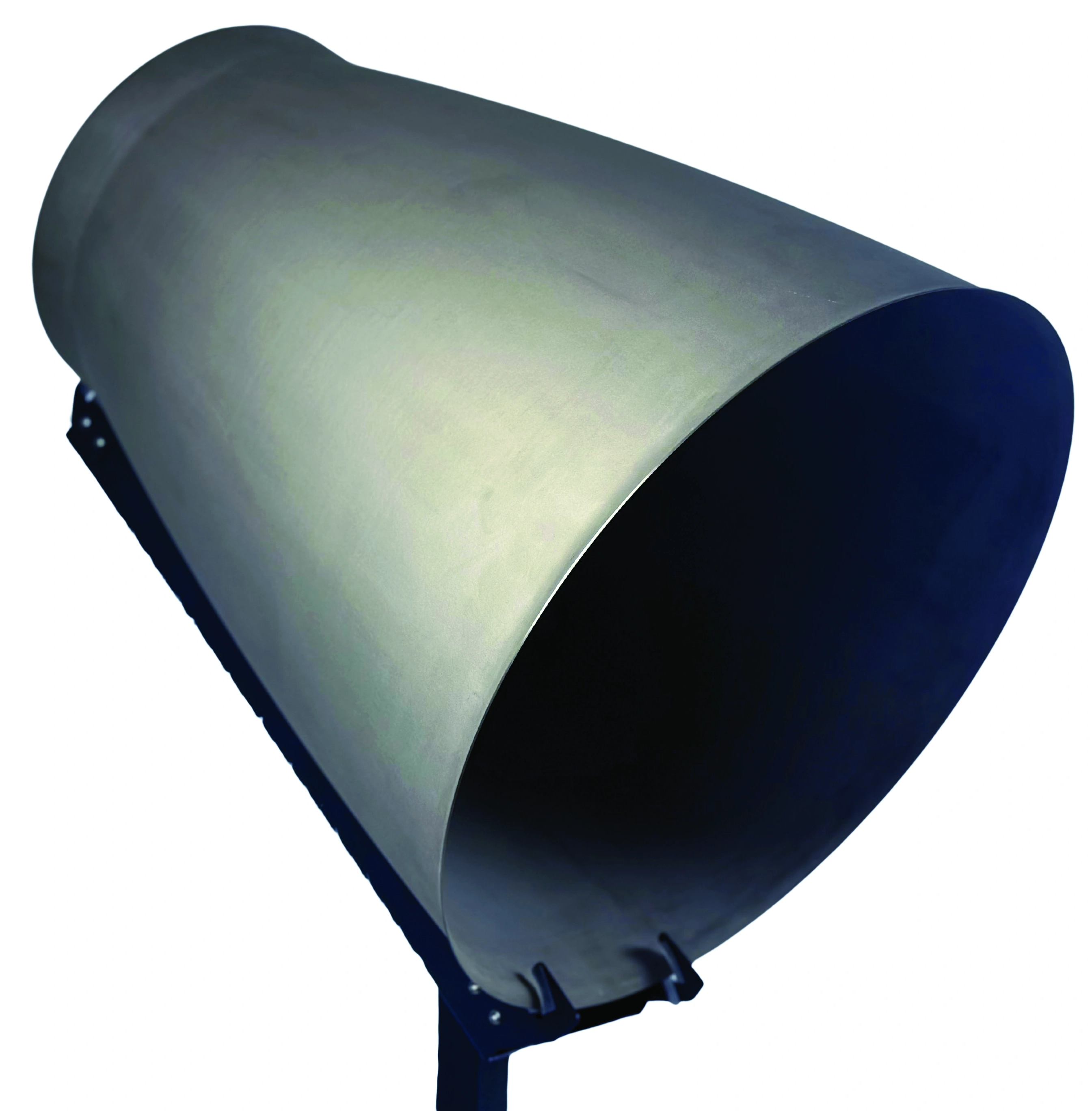

Material efficiency is another benefit. As almost all the powder is bonded in the component, the buy-to-fly ratio, which is the ratio of starting material to the final product, is almost one. This significantly reduces the material costs, particularly with high-cost alloys like C-103. The process also opens up new design opportunities and options — Fig. 2. Wall thicknesses starting at 0.5 mm are feasible, so that fine, light structures can be formed, which are still extremely robust.
Fig. 2 — Cold spray technology opens up new design opportunities and options.
