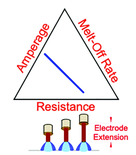

This image depicts the relationship between resistance (electrode extension), amperage, and melt-off rate. The shortest electrode extension (left figure) results in the highest amperage, which produces the highest melt-off rate. The longest electrode extension (right figure) results in the lowest amperage, which produces the lowest melt-off rate.

    Electrode Extension: This is the distance from the end of the contact tip to the end of the electrode. Some refer to it as contact tip-to-work distance or tip to work, but the standard term is electrode extension (EE). It is what it is; we can’t put everyone who calls it “MIG welding” in jail, and we certainly can’t lock up everyone who uses the term contact-tip-to-work distance. Why is EE important? It’s simple. The longer the EE, the higher the electrical resistance. The higher the resistance, the lower the amperage. Ohm’s Law is not a recommendation, it’s the law.
    Amperge = Voltage/Resistance
    Since we can assume that the arc voltage provided by the power supply is constant, and the EE is also constant if the welder doesn’t vary it during welding, the amperage becomes inversely proportional to the EE. The sketch on the previous page shows the relationship between arc voltage, EE, and amperage. Because the contact tip is where the electrode becomes electrically energized, we can ignore the internal circuitry of the welding machine. The electrical resistance is directly proportional to the EE. If the welder doubles the EE, the resistance also doubles. And if the resistance doubles, the amperage is reduced by a factor of two. In other words, the amperage becomes half of what it was.

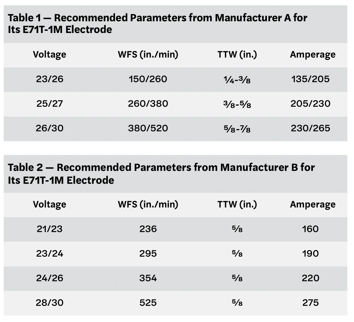

In my opinion, the typical way welding parameters are presented in a welding procedure specification leaves something to be desired. Tables 1 and 2 are offered for comparison. Both use the same electrode diameter and the same shielding gas mix.
One can see that the recommended welding parameters for the E71T-1M electrode from Manufacturer A are not the same as those recommended by Manufacturer B. If the welder assumes that the same parameters can be used for both, the results will prove otherwise.

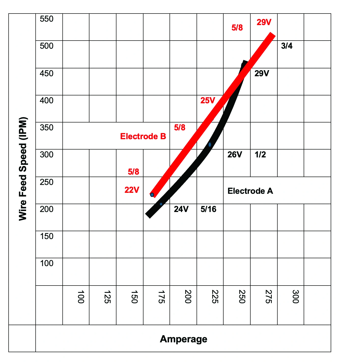

On this page is a graphical presentation of the manufacturers’ recommendations. From this, the welder can immediately see how the welding machine should be set. The starting point is to set the WFS at midrange. The voltage would correspond to the recommended value based on the WFS. The EE would also depend on the selected WFS.
Using Electrode A as an example, the starting point is a WFS of 325 in./min, voltage at 26 V, and an EE of 3/8 in. Using Electrode B as an example, the starting point is a WFS of 300 in./min, voltage at 25 V, and an EE of 5/8 in.
