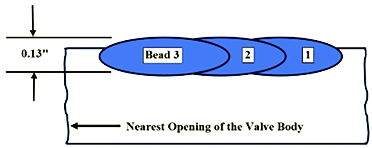

Details matter in planning, preparing, and executing hardfacing production operations. Thus, a hardfacing execution plan was developed before production. A PTAW hardfacing execution plan is a proactive approach that outlines production requirements and practices.
An execution plan details attributes that control the quality of the hardface deposit, such as the preheating method, the valve body cooling method, interpass temperature control, as well as groove travel programming, powder size, training, metrology, machining, cleaning criteria, specialized tooling and equipment, stress relieving, and nondestructive examination (NDE). The procedure qualification record (PQR) and the welding procedure specification (WPS) were qualified per Naval Sea Systems Command (NAVSEA) S9074-AQ-GIB-010/248, Requirements for Welding and Brazing Procedure and Performance Qualification.

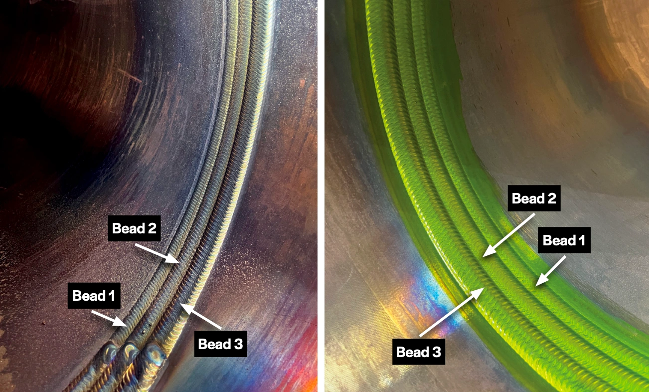

Fig. 2 — Cross-sectional view of the ID hardfacing bead sequence. Working from right-to-left toward the nearest opening of the valve body, one layer consisting of three, side-by-side beads was deposited.

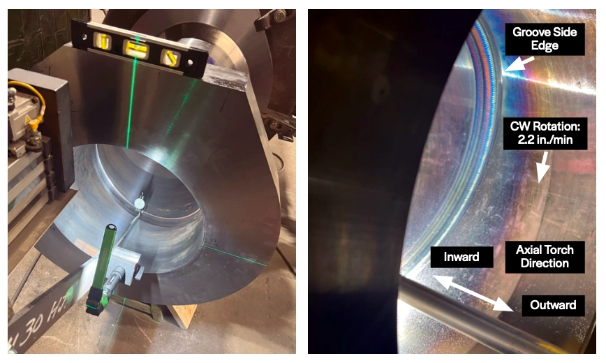

Maintaining the relationship between the ID circumferential elliptical hardfacing groove and the torch during hardfacing required a few steps.
First, laser metrology was used to align the positioner table and valve body groove with the PTAW torch. To accurately program the programmable logic controller (PLC), such that the torch was positioned correctly during elliptical groove rotation, the valve body had to be concentric and perpendicular to the torch. Also, for the PLC to determine the exact location of the groove relative to the torch during rotation, an encoder was vital.
The PLC was programmed to calculate a sine wave path where the positioner table encoder sent digital signals to the PLC relative to the groove’s rotational travel speed and travel distances. The PLC, in turn, sent signals to the PTAW pendant, which signaled the torch carriage motor to move the torch inward or outward, respectively, to the groove’s axial location — Fig. 3.
IT Nov 2025 - Feature - Inside Diameter Valve Hardfacing Using Plasma Transferred Arc Welding - Fig 3.webp
Fig. 3 — Left — The utilization of laser metrology to align the positioner table and the valve body’s ID groove relative to the PTAW torch. Dial indicators were also used to assist in the alignment of the torch with the elliptical groove. Right — A view of the deposition of the third bead. Based upon a travel speed of 2.2 in./min, each hardface bead required approximately 24 minutes to complete one 360-deg rotation. During hardfacing, in-process visual testing was performed to inspect for bead surface discontinuities and defects.
The encoder, PLC, and pendant worked together throughout the hardfacing process to accurately maintain the groove position and torch relationship. With the torch mounted in the 6:00 position, the ID groove rotated clockwise during hardfacing at a travel speed of 2.2 in./min, and it took approximately 24 min to complete one 360-deg rotation.

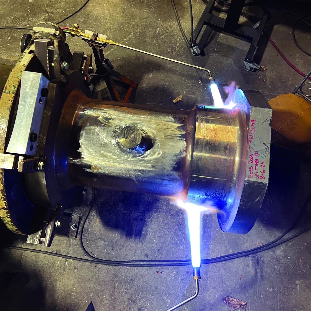

  11. Based on verifications of the above two, oxyfuel preheating torches were positioned with one torch on each side of the valve body’s ID groove location and ignited — Fig. 4.
IT Nov 2025 - Feature - Inside Diameter Valve Hardfacing Using Plasma Transferred Arc Welding - Figure 4.webp
Fig. 4 — Through-thickness valve body ID groove preheat temperature was 500°F minimum, and the interpass temperature was 900°F maximum. The valve body rotated during preheating.  The wall thickness at the groove was 2.5 in.

Upon completion of the preparation steps, production ID hardfacing commenced. The PLC started the rotation of the positioner table, and the PTAW pendant was used to initiate the PTAW main arc. The two preheating torches were pulled away from the valve body and used to maintain the interpass temperature — Fig. 5. The valve body represents a sizable heat sink. If its temperature decreased below 500°F, hardfacing quality was adversely affected (i.e., incomplete fusion and accelerated cooling rate). Per the WPS, torch nozzle powder was dispensed at 22 gal/min at 140 A. To mitigate base metal dilution, it is crucial to ensure fusion transpires only at the base metal surface instead of attaining excessive surface penetration.
IT Nov 2025 - Feature - Inside Diameter Valve Hardfacing Using Plasma Transferred Arc Welding - Figure 5.JPG.webp
Fig. 5 — Valve body production ID hardfacing. The PTAW arc is exceptionally bright where the hardface pool is clear and reflective, which aids in its visibility as operators monitor the deposition process. Oxyfuel torches were utilized to maintain the interpass temperature.
During hardfacing, operators observed the deposit build-up where the pool was clear and highly reflective. Also, to optimize deposit quality, the PTAW pendant allows operators to adjust process variables in real time (e.g., amperages, travel speed, powder feed rates, and toe dwell times). Upon completing one 360-deg groove rotation, the operator initiated amperage downsloping, whereupon the arc gradually extinguishes and the bead is visually inspected. For interpass cleaning, torch powder overspray that had collected in the groove during hardfacing was removed by wire brushing. The process was repeated for each bead deposited.

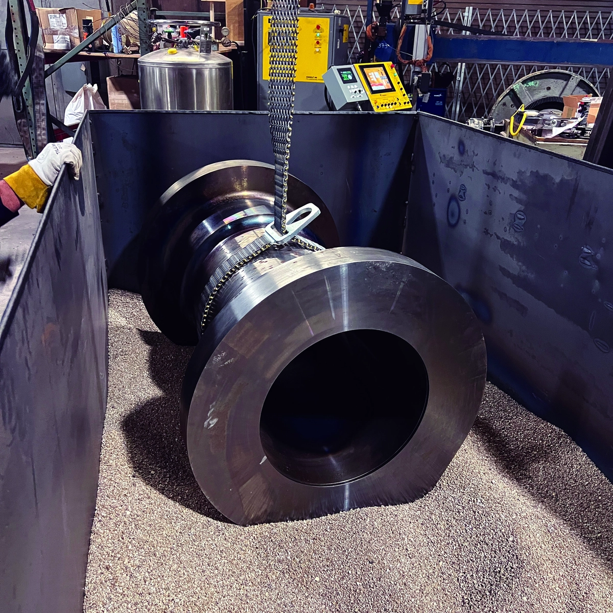

Fig. 6 — Immediately following hardfacing, the 700°–800°F valve body was placed in a bin and covered with vermiculite. It took a nominal four days for the valve body to cool down to room temperature.

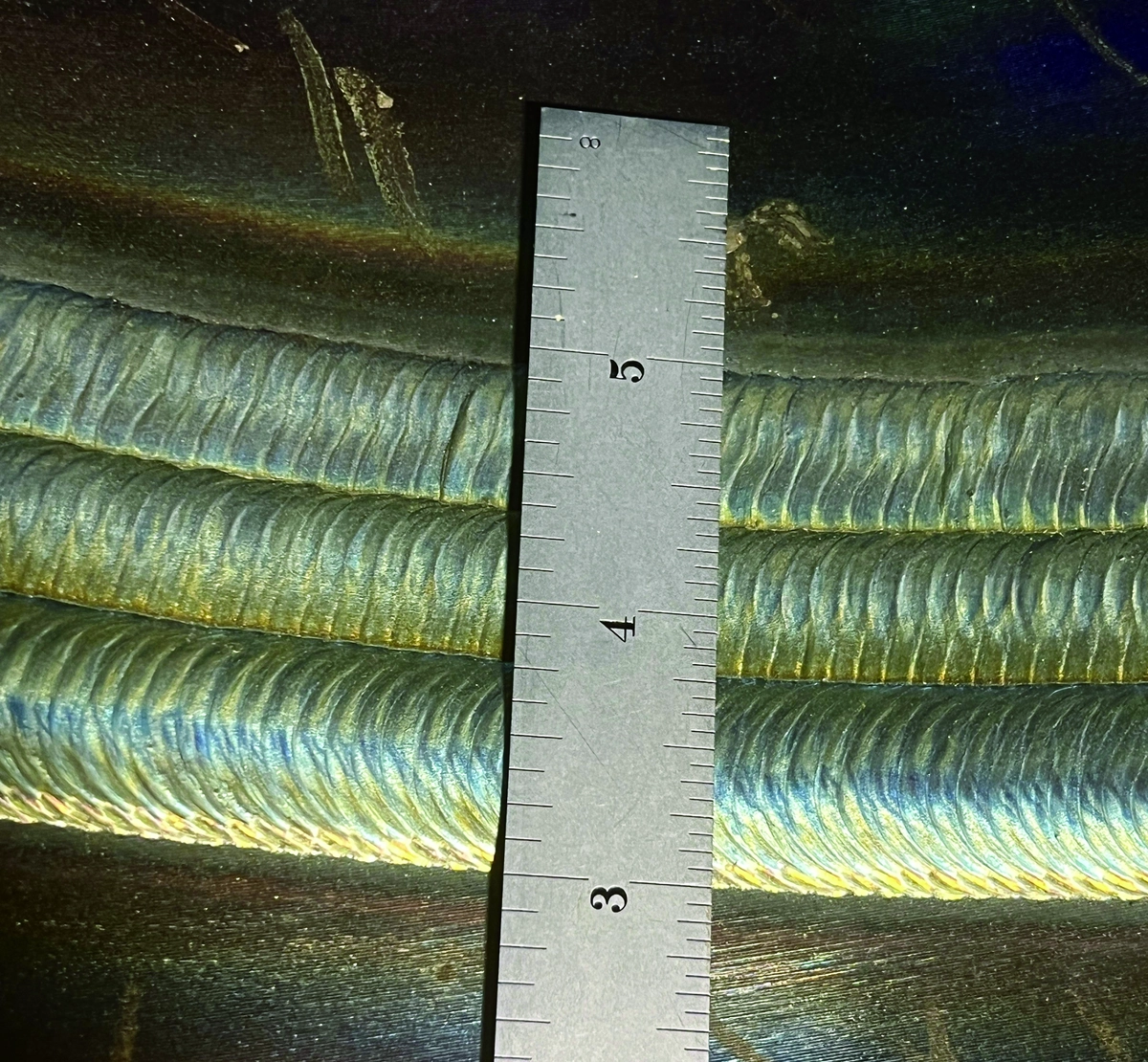

At completion, the valve body was placed in a bin and covered with vermiculite — Fig. 6. Upon cooling to room temperature, the valve body was removed from the bin, where visual testing (VT), fluorescent penetrant inspection (FPI), and radiographic testing (RT) were performed to inspect for bead surface and internal defects and discontinuities — Fig. 7.
IT Nov 2025 - Feature - Inside Diameter Valve Hardfacing Using Plasma Transferred Arc Welding - Fig 7.webp
Fig. 7 — Left — PTAW ID hardfacing completion. One layer consists of three, side-by-side hardfacing beads. Right — VT, FPI, and RT were performed to inspect for bead surface, internal defects, and discontinuities.

  3. Final inspection of hardfacing bead deposition: VT, FPI, and RT — Fig. 7.
