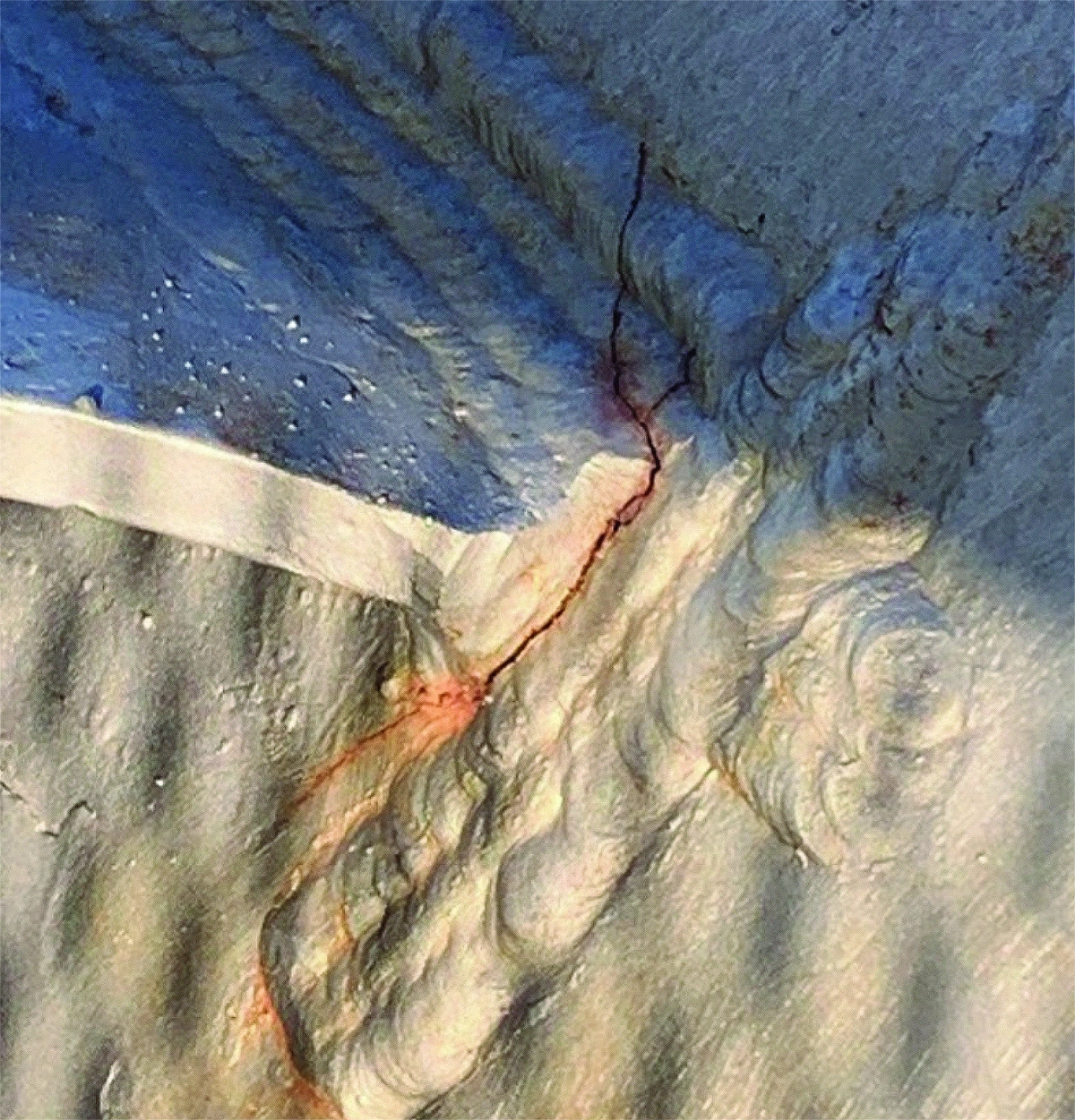

Qualified personnel perform NDE on chassis, axles, bogies, and tracks. The inspection objectives are to identify in-service cracks and metal loss due to wear or corrosion, and NDE professionals accurately locate and quantify the extent of discontinuities and material defects — Fig. 1.
IT Nov 2025 - Feature - Conventional and Emerging NDE Techniques for Amusement Parks - Fig 1.webp
Fig. 1 — In-service crack on a welded repair.
Visual Testing
VT is the first line of defense for all amusement park infrastructure, including welds, small, redundant parts, and large, complex components. Based on over 15-plus years of amusement park NDE experience, I have found that more than 80% of all indications can be identified through thorough VT. A NDE inspector can identify most of the damage mechanisms encountered on the amusement industry’s many components by using adequate viewing angles, lighting, and magnification. VT is a great starting point, but poor technique, inadequate lighting, and dirty components tend to mask indications from the naked eye. NDE is performed in accordance with the ASME Boiler and Pressure Vessel Code (BPVC), AWS D1.1, and ride manufacturer guidelines.

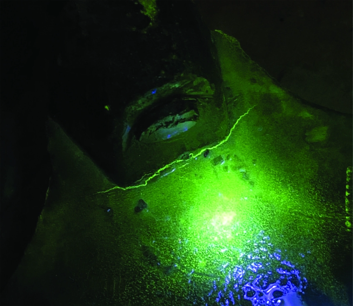

Wet Fluorescent Magnetic Particle Testing
The most common supplement to VT in the amusement industry is MT. Both dry and wet MT are common, with the latter being used more often because it is more efficient. This technique is made possible by exploiting the predictable nature of magnetic fields. Magnetic fields are introduced into the test part using standard yokes and coils. Magnetic flux leakage fields are generated around surface cracks. This leakage field attracts small iron particles to cracks, narrow weld undercuts, and places with incomplete fusion. In contrast to the dry technique, the fluorescent technique highlights the area of concern when viewed under adequate ultraviolet lighting.
Wet fluorescent MT is the preferred technique to detect dry particles due in part to its comparably higher sensitivity to more minor flaws — Fig. 2. The higher sensitivity is driven by higher MT particle mobility and the peak sensitivity of the human eye to the green-yellow emitted by the wet MT bath. While the probability of detection is high, depth quantification of indications is impossible, and MT does not detect subsurface indications.

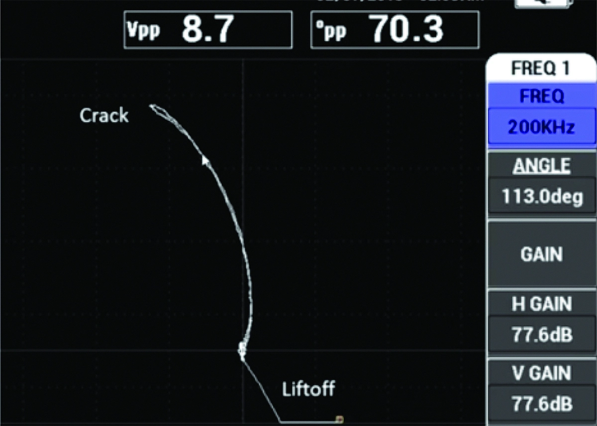

Eddy current array (ECA) is another advanced nondestructive examination technique that shows promise in the amusement park testing market. The basic working principles of ECA are the same as those of conventional ET except that multiple coils are contained in the array probe. ECAs are constructed using a multilayer printed circuit board coil, a multilayer configuration dedicated to a cross-wound array on the lower layer, and a reflection coil probe on the upper layer. The eddy current reflection probe provides dynamic lift-off compensation for rough surfaces and weld reinforcements — Fig. 3. In this configuration, eddy-current signal polarity can correlate direction to crack orientation relative to the coil axis.
IT Nov 2025 - Feature - Conventional and Emerging NDE Techniques for Amusement Parks - Fig 3.webp
Fig. 3 — 180-lag between the stainless-steel surface crack and lift-off using a cross-wound coil.
The primary use of ECA is to evaluate inside diameter/outside diameter corrosion on tubing and piping. This applies to a multitude of structures found in amusement parks. From square/round track tubing to pitting on axles, ET provides a quantifiable evaluation of corrosion, erosion, and service wear experienced by these structures. ECA is a sensitive method that has the same issues as conventional ET, the main problem being that the method is susceptible to permeability changes. For this reason, weld inspection with ECA is difficult due to the varying heat input changes during the heat treatment and welding process. The different temperatures throughout the weld material and heat-affected zones typically decrease magnetic permeability (how susceptible a material is to an external magnetic field). The significant advantage of ECA is maximizing the penetration depth of the usable eddy current field.
