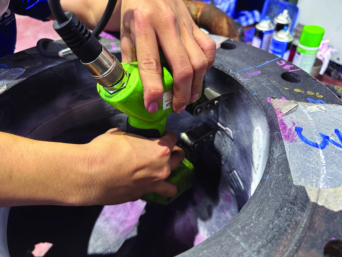

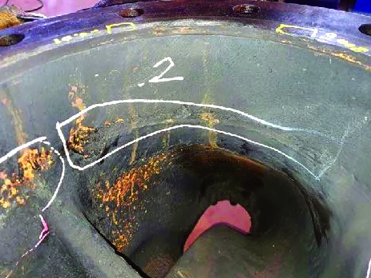

Gas compressor turbines are key equipment in the oil and gas industry, power plants, and many industrial applications. This refurbishment project was initially prompted by a routine inspection of the turbine’s inside housing using an endoscope — Fig. 1. The inspection was conducted six months ahead of a scheduled plant shutdown to determine whether repair work was necessary.
Previous inspections and overhauls had already revealed gradual erosion-induced wear of the inner wall surface, which was now very advanced in some areas. Notably, the section around the gas outlet nozzle was most affected. A critical approach to the calculated minimum wall thickness was localized at some spots. If these minimums were not met, the turbine would need to be taken out of operation immediately, and the entire production plant would have to be shut down.
IT Nov 2025 - Feature - Case Study Steam Turbine Casing Repair - Fig 2 a.webp
IT Nov 2025 - Feature - Case Study Steam Turbine Casing Repair - Fig 2 b.webp
IT Nov 2025 - Feature - Case Study Steam Turbine Casing Repair - Fig 2 c.webp
Fig. 2 — Eroded areas.
Partial deposition welding, primarily in areas where the erosion was most advanced (Fig. 2), was considered as a repair method to prevent the worst-case scenario of an imminent plant shutdown. Based on an original wall thickness of 30 mm, the wear profile in the selected repair areas was between a minimum eroded depth of 4 mm and a maximum of 11 mm.

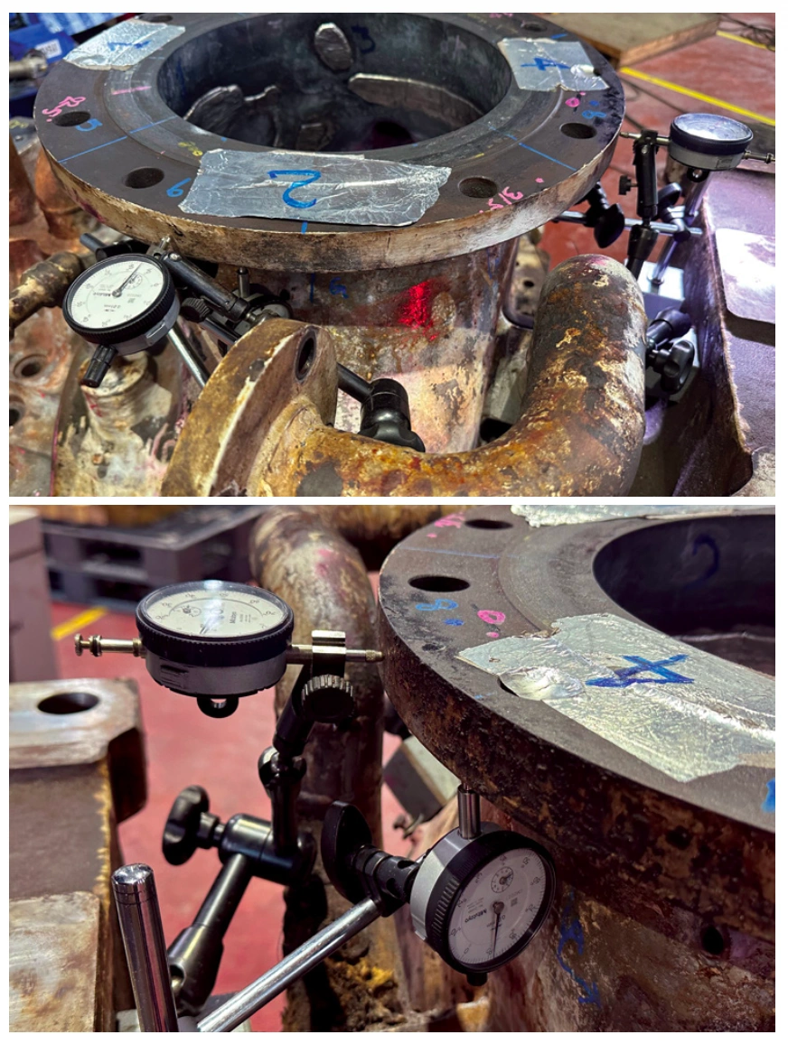

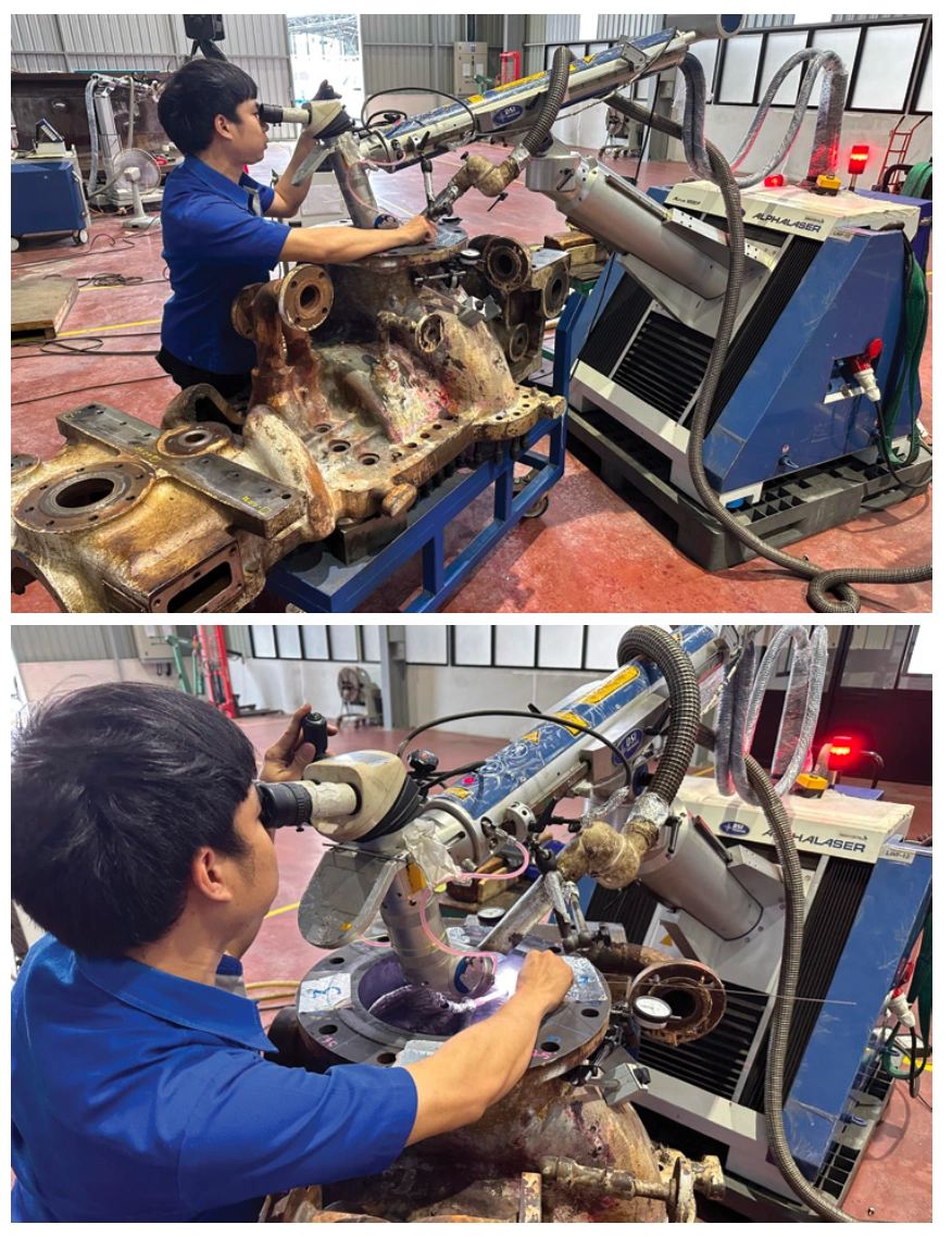

Measuring equipment (i.e., dial gauges) was set up for continuous distortion monitoring during the ongoing welding process — Fig. 3. Four dial gauges, staggered by 90 deg, were installed around the turbine exhaust flange (one at the outer edge and one at the lower edge).
PLBW Process
The deposition of designated areas ranged between 4 and 11 mm. For the base material, A216 WCA / ASTM 216, the selected filler material was DSI M NICR625 (Inconel 625), with a diameter of 1.2 mm.
Welding was done with an AL Flak 1200 F fiber laser machine, and the operator used a joystick to control welding direction movements. At the same time, the filler metal was fed in manually. At 1200 watts of pulsed laser power, the molten pool had a diameter of 5.2 mm — Fig. 4.
Fig. 4 — PLBW workpiece and machine setup.
Inspection and Quality Control
The intermediate quality control procedures during welding included visual testing (VT) and liquid penetrant testing (PT) after every 3 mm of deposition. Continuous distortion control was monitored via dial gauges (see Fig. 3). The maximum distortion observed was 0.025 mm.

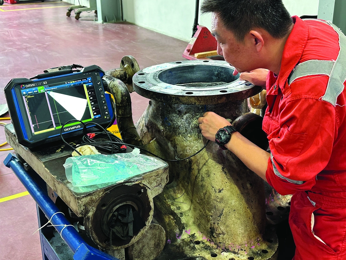

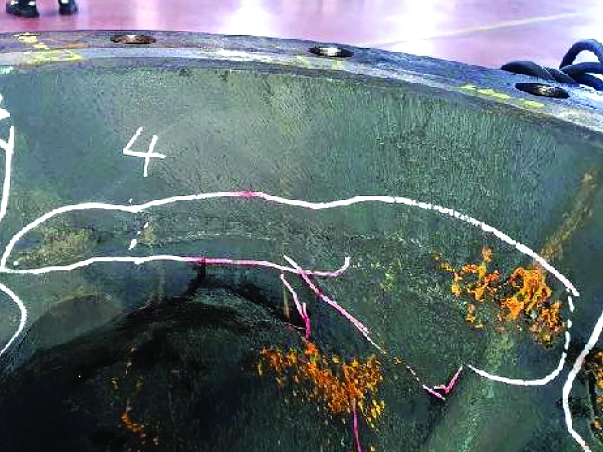

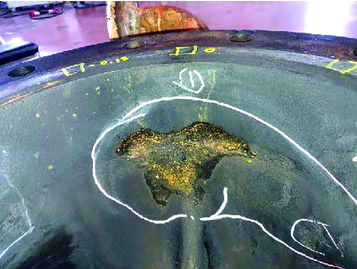

Final inspection after welding included VT, PT, and magnetic particle testing — Fig. 5. Additionally, radiographic testing and ultrasonic testing were performed — Fig. 6.

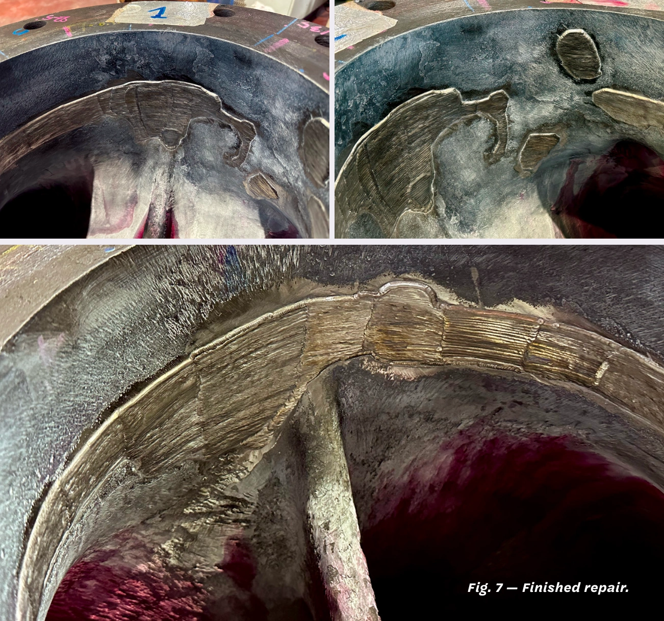

This case provided a noteworthy example of the benefits of PLBW, which achieved complete metallurgical bonding without any welding discontinuities or defects (cracks, incomplete fusion, or porosity) while providing benefits that conventional arc welding methods typically cannot — Fig 7.
The comprehensive inspection and quality control plan provided thorough verification and satisfactory results.
